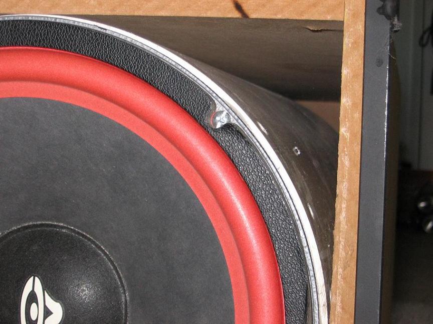

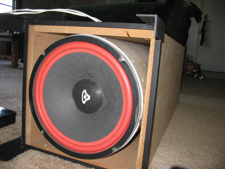

well lets see on the new angle on a t line ....
it might be but i will probably have someone tell me its more of a ported box
first what i did was found a 12" piece of pvc pipe about 10' so i could cut it to length and have a left over to build 2 stereo bass!!
then i got out my old cerwin vega 12" xl the ones with the red surround
i built a box that is about 40 " long by 12.5" square and slipped a pice of pipe 28" long inside it leaving one end closed and one open with a speaker mounted in the end of the pipe
so it gives me 4 small rounded triangle ports and a wavelength of the tuning frequency from the speaker to the end of the port
this gives me a verry nice sounding box tuned to arround 35-40
and if my calcs are right and 1/4 of that is the length of the box times two from the speaker to the back of the box and from the back of the box to the end of the port
well if its not right it could be that i havent really measured them in a few years and i was just starting to learn about transmission lines when i built them
i dont have a pic if you want ill take one and email it to you
and last but not least what file do i use to model a transmission line on mr kings spreadsheet ?
the mltqwtl? the closed end tl?......
im not really sure what style to go with ?

here are some pics

Greets!
OK, you have a pipe that has a bit more CSA than the driver 'dumping' into an acoustic 'chamber' which terminates into four long, smaller CSA vents. If we ignore the chamber, it's technically somewhere between a BR and ML-TL since its aspect ratio is too long to be a true BR, yet not long enough to have any TL properties in its tuning BW, but the chamber creates an acoustic low pass filter, so in audio parlance you built a bandpass box of 'x' BW tuned with multiple vents, AKA a muffler with multiple exhaust pipes.
For narrow BW apps such as a sub, a good performing, space efficient design actually, but then you already learned this by doing, rather than just theorizing. 😉 Since BPs literally go back to the earliest days of sound reproduction and your basic layout has been used before, no new 'angle' unfortunately. As the designer/inventer Tom Danley has opined on several occasions, "the ancients keep stealing all my inventions."
