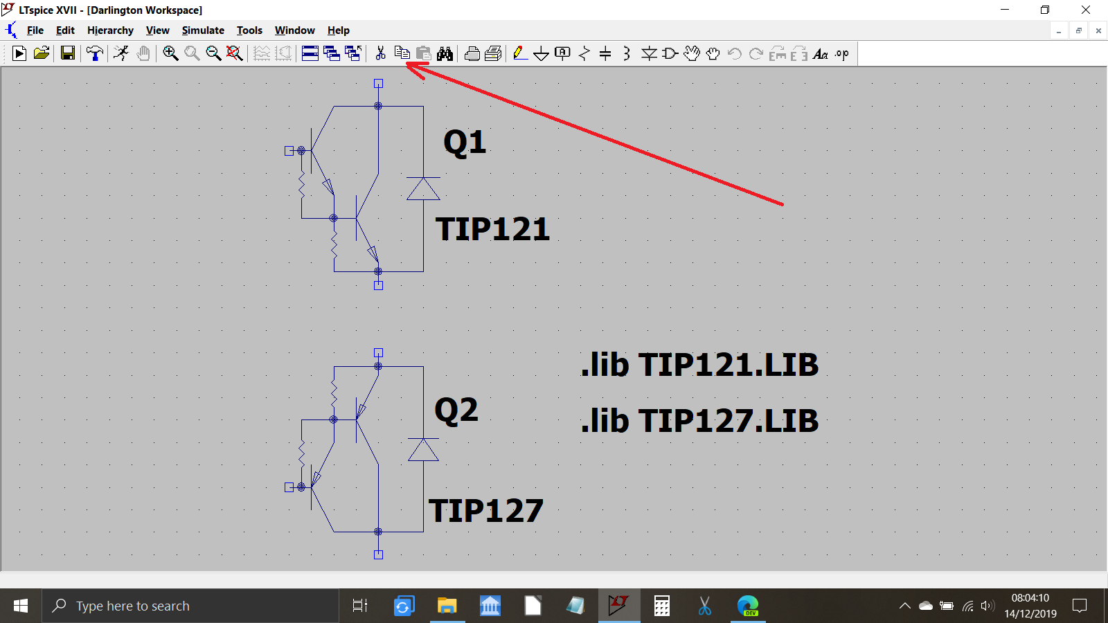

I have about 30 Darlington Pairs
Can I get the LTSpice models for the power transistors from you, please?
The models are actually some of Mike Englehardt's and are buried in an example sim included with LT.
Try this. The .asc called Darlington Workspace should open to a workable file. Use the copy function to add more to your circuit as required.

I don't have LT Spice models for them. I am still trying to re-learn with LTSpice. So far I have not been able to get it to open my exported schematic.
If you download Mooly's sim, it works except for the missing models for the TIP series outputs.

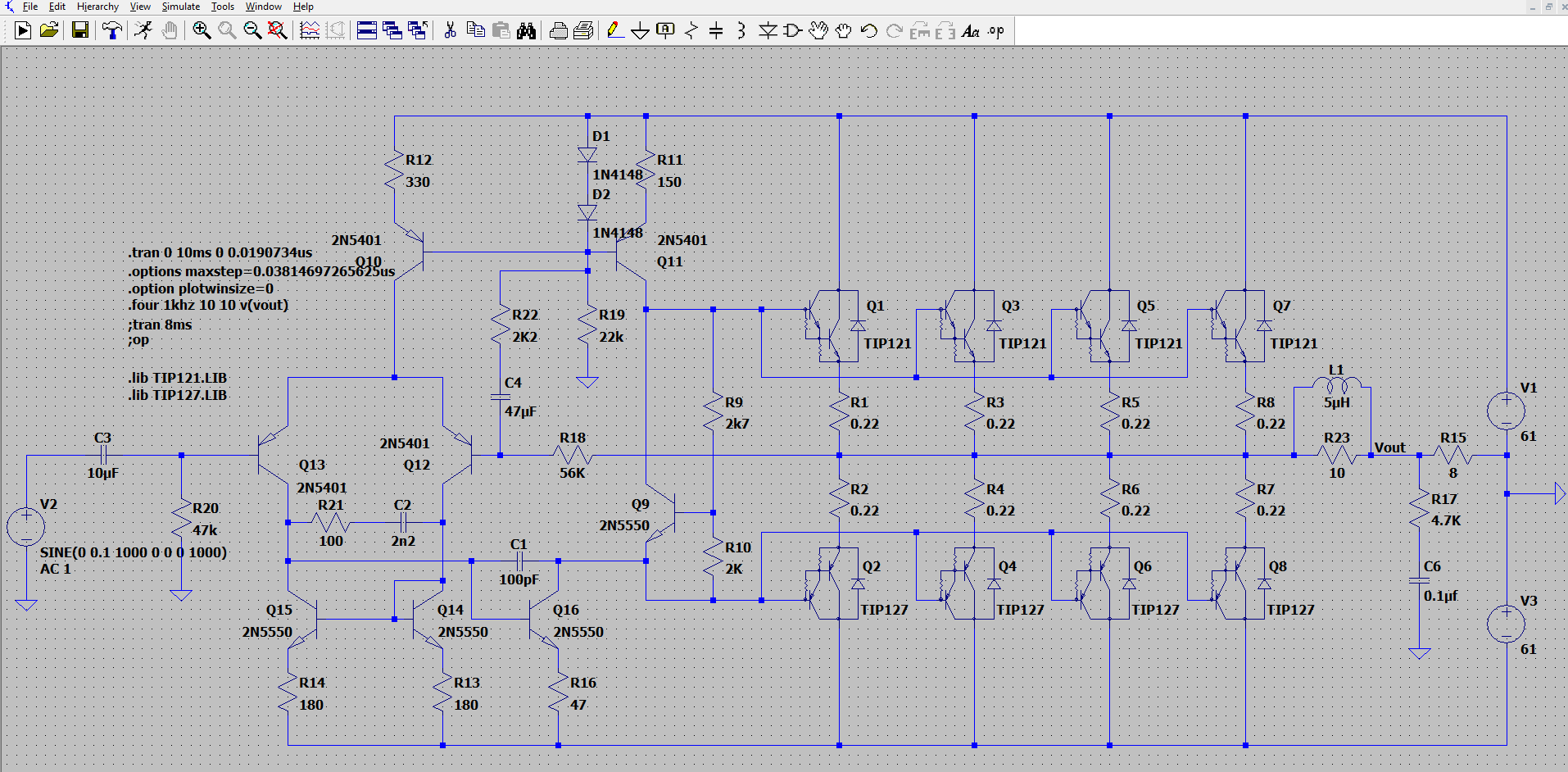

I did some tinkering and I think I have usable data but I am not sure. On the ltspice schematic. I adjusted the Value of R18 to get maximum gain with the least amount of impact on the frequency range and distortion.
Not sure how accurate since the library is not for the actual outputs I am using. Also really new to ltSpice.So I am not totally sure I am using it correctly. I think I learned on a different program 3 Decades ago.

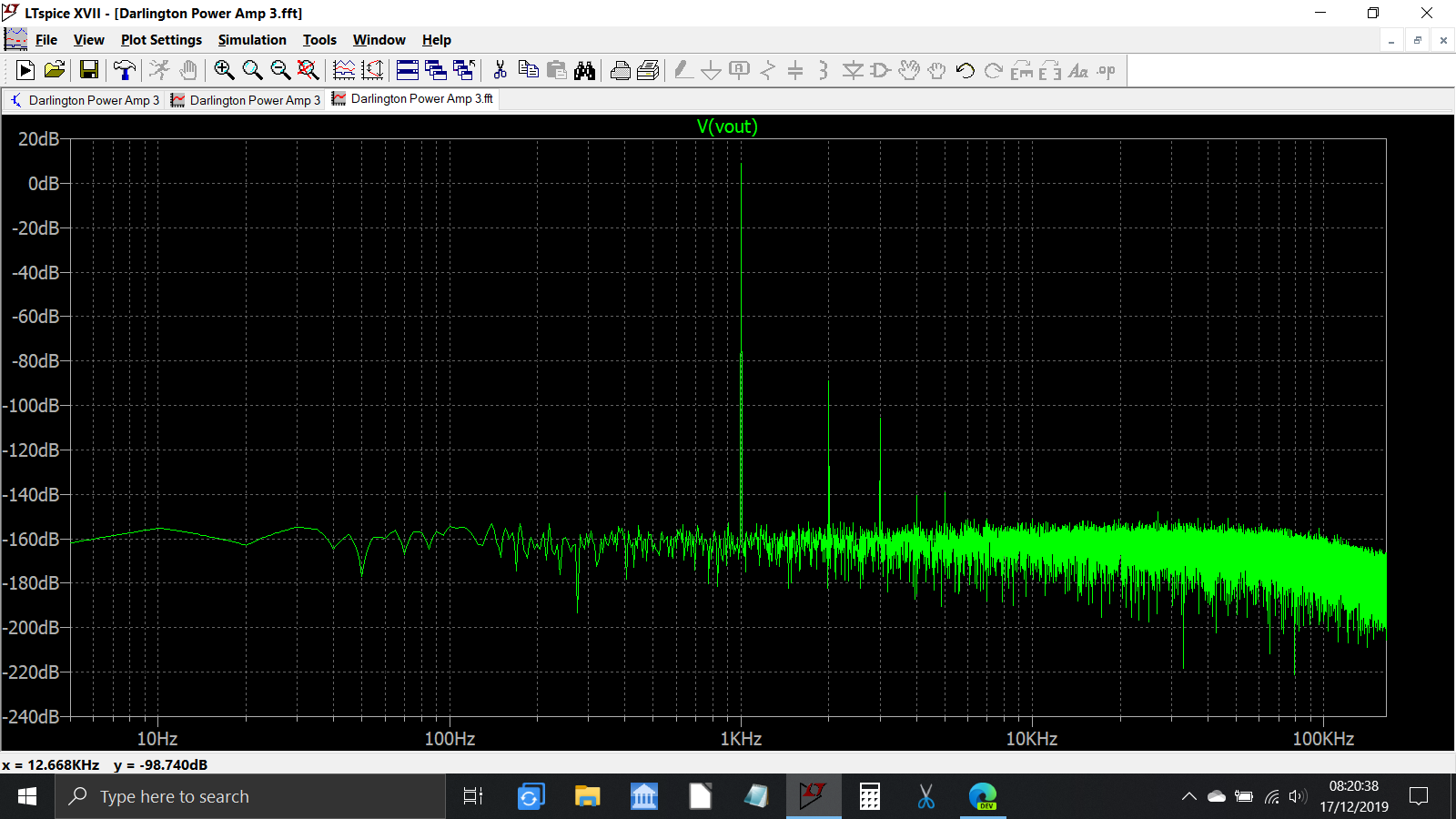

Not sure what to think about the ringing on the last picture. It is outside of the audio frequency but will it be an issue?
Actually you don't want maximum gain. What you want is for the amplifier to reach something like 99% power with a standard line input level, either pro or consumer (PLL or CLL).

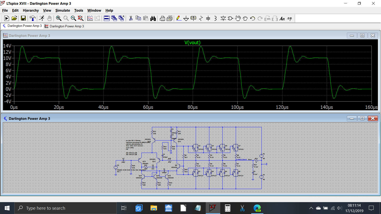

Yes. It can be an issue since it's a pre-cursor for oscillation.
This is starting from the original simulation:
First image is just the original sim and it is a little nervous (and whatever you do with a real build, you must add a little series inductance at the output for stability into real loads).

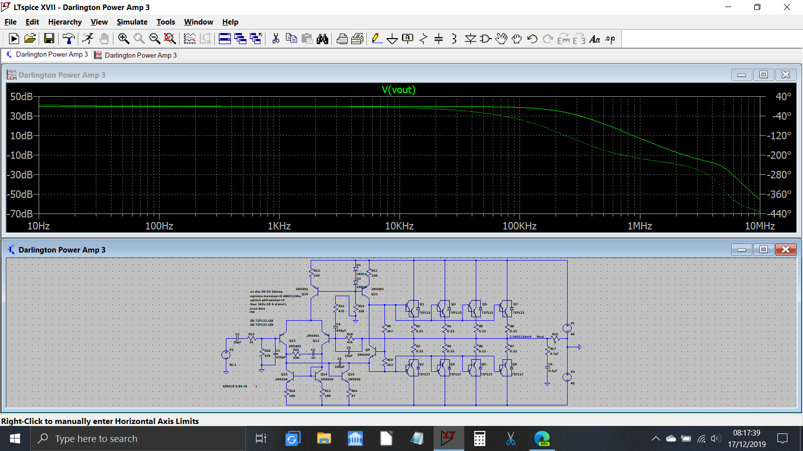

Second image shows what I altered. Input filter added as well.

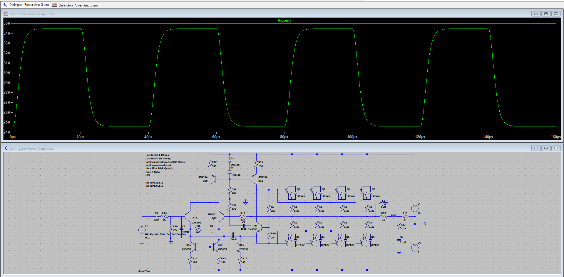

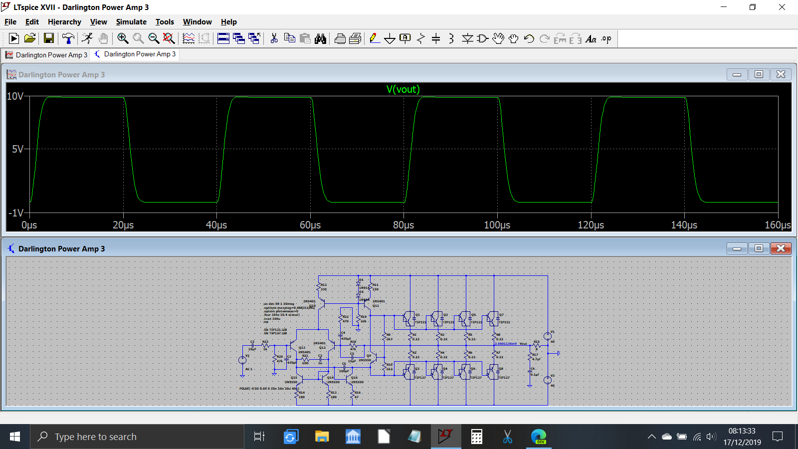

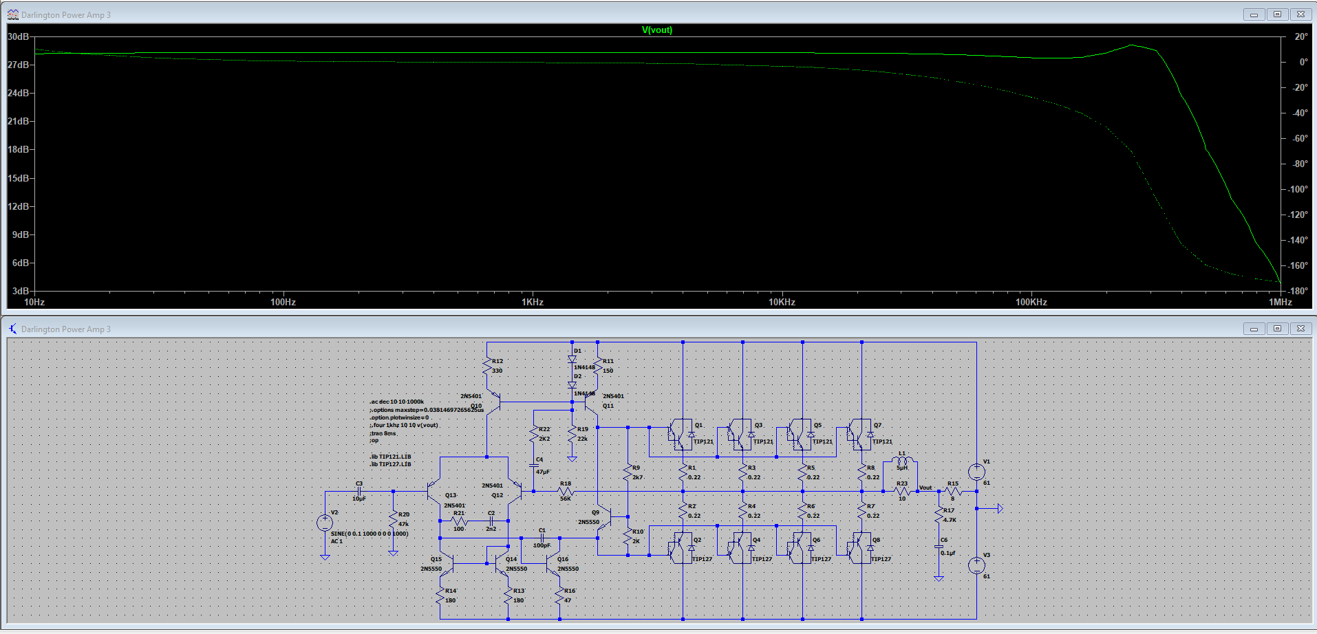

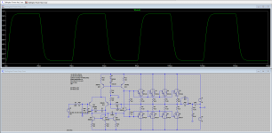

Third image shows squarewave setting for voltage source to give 25kHz signal. Set the sim to run for 160uS to display four cycles.
Fourth image shows new result of squarewave test.

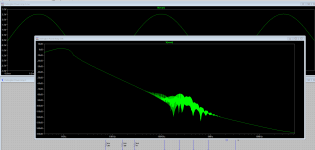

Fifth image shows the overall response and gain.

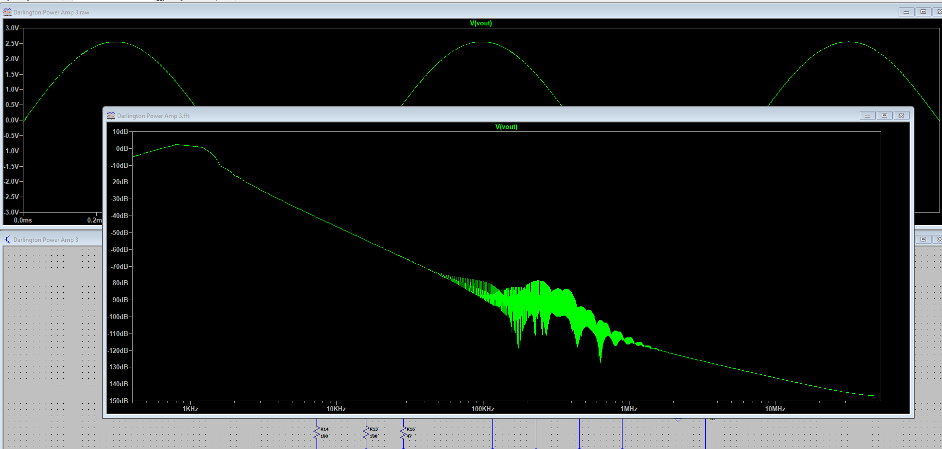

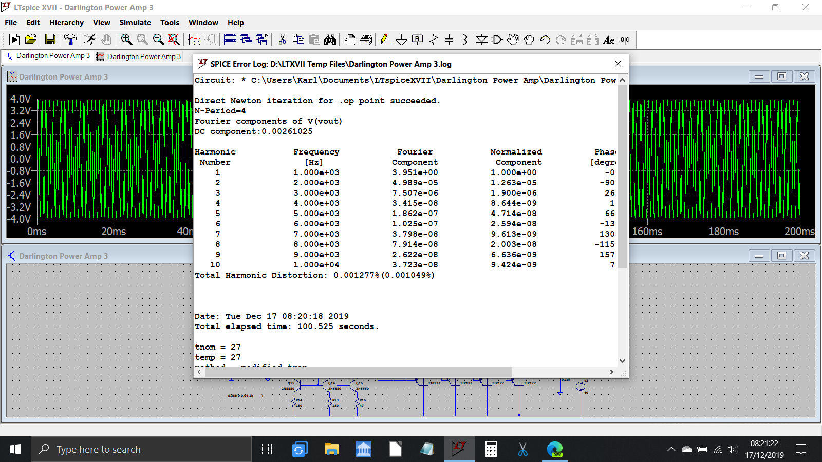

Sixth image is an FFT plot at 1 watt/8ohm. It is so good because the bias current of the four pairs of outputs means it is in class A at this point.

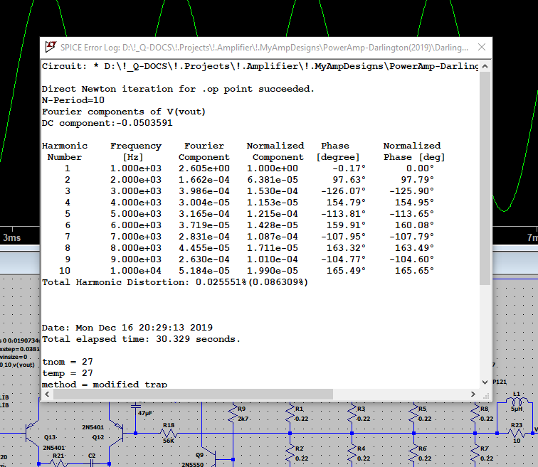

Seventh image is the headline distortion figure.

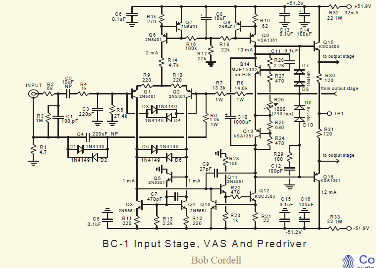

Nice to see you guys are re-inventing the wheel, so to speak. Did you look at this design that Bob Cordell presented at BAF2019? Many ways to make an amplifier, but how complicated does one need to get to achieve the goals. This is a working and tested design.

I would really like to see a schematic of a class ab amplifier and have someone explain to me what every part does or point me to a book that goes into more detail that just This is a long tail pair, This is a driver stage, ETC ETC ETC.
I posted a design in which some one has explained in a whole chapter of a book, dedicated to audio power amp design, then presented it to the DIYAudio community, there is a youtube video as well, explaining exactly what every component does.

I think I was quite clear in my response as to a book that does what was being asked and a design that meets the requirement of the OP.
@kilgorq, does this answer your original posting? if you want the pcb for the above amplifier PM me. If you post your layout I can look it over.
I watched this video. Honestly not sure where it described every part. The circuit topology is interesting but it was more like a 100 foot view of it. I have read about 100 Pages of the book and am still trying to get back to it. Kids are grown up but unable to do anything without someone holding there hands. A Remote Island sounds good but being a father never ends.
I am not trying to re-invent the wheel. I have decent grasp on the subject. I understand how the stages work together and what they do. I could just order an amp kit and assemble it and call that DIY. Been there done that. But that is not what I am after. I want to learn more about the subject matter. I want to get good at using the simulator and understand why I get the results that I do. I guess maybe my question was not detailed enough. For example I want to understand why amp A Sounds better than amp B. What is different in the circuit. Or how changing the value of a resistor changes the performance of an amp and more importantly why!

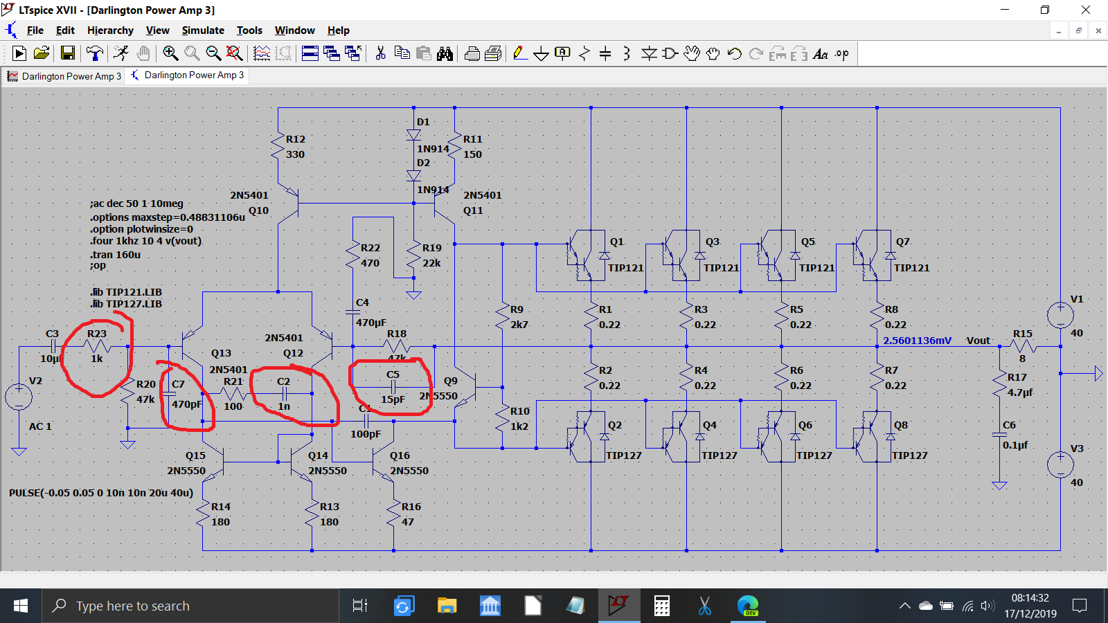

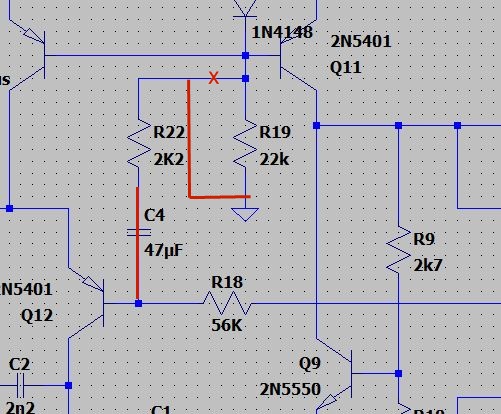

Ok, lets address something I've been seeing all the way through this design process...
Follow your feedback path through R18 ... then C4 ... into R22... and to the base of Q11 ... if you work out the effect of this chain you actually have positive feedback happening. It's not much, maybe 10% but it will be enough to cause some instability that might well become audible.
It needs to be redone as I've shown ... R18 to R22 to ground. This eliminates the positive feedback and your gain is then set by the ratio of R22 and R18 ... like in an opamp, which is basically what you are designing. R18 still needs a low value capacitor across it to limit gain at higher frequencies also to prevent oscillations.
