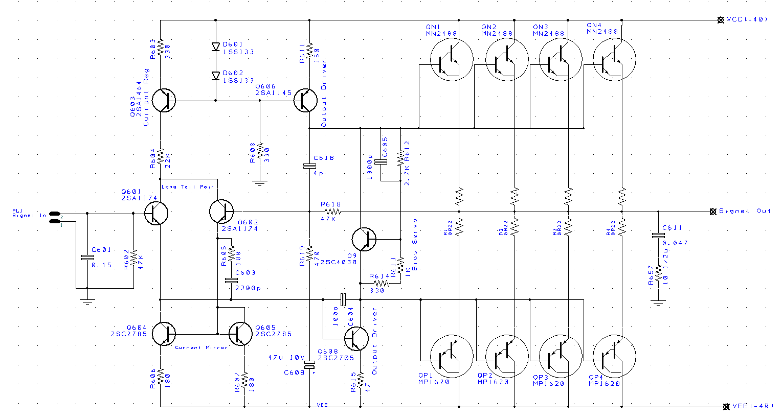

I have about 30 Darlington Pairs
I stripped a whole bunch of old Sony amps and I would like to re-purpose the output transistors. I looked at the schematic for one and it was a class h amplifier using a 2 pairs of MN2488 and MP1620 Darlington Transistors. I have attached the schematic I came up with from it. I am new to building (Kind of anyway) I usually just modify existing amps to put out more power.
Can anyone that has built a few look this over and tell me if there is anything I have totally messed up or can do to improve it before I get the boards made?
Also
I would really like to see a schematic of a class ab amplifier and have someone explain to me what every part does or point me to a book that goes into more detail that just This is a long tail pair, This is a driver stage, ETC ETC ETC.
I am really hoping a guru can help me here. I have been in the electronics industry for 30+ Years so don't worry about getting to technical.
A few things at first blush ...
1) You probably should make your bias circuit at Q9 adjustable.
2) Bypass your feedback resistor at R618 with a small value cap to prevent high frequency oscillations.
3) You might consider a thiel network on the output... half a dozen turns of wire around a resistor in series and a small value cap to ground.
4) Some RF bypassing on the gain stages might also be a good idea.
5) with 40 volt rails you really don't need 4 pairs of 10 amp transistors... 2 pairs would probably suffice and may even work better. More output transistors does not give you more power.
Just one question .... how the heck did you manage 30 years in electronics without learning how an amplifier works?
You might want to visit this thread and get the book ...

1) Easy enough
2) Refresher I am creating a filter RC Filter Low pass filter on the feedback loop to stop the amp from going into parasitic oscillation. I am thinking shoot for about 30Khz or about 1500pf.
3) Got it.
4) This one escapes me. I will have to some homework. Just to make sure I do it right. Caps??? But how to implement them.

I was in the same spot about 5 years ago. Needed a refresher and some reminding... that's where the link in my signature comes from.
1) Easy enough
Good.
It can be a simple capacitor or a capacitor and a resistor in series. The values will depend on whether the amplifier's gain crosses the point where phase shift creates positive feedback to cause oscillations. With most modern semiconductors that could be as high as 200khz... if at all. But bringing the gain below unity around 100khz seems like a good place to start.

This is why we build on protoboard before we order circuit boards. There's always a mess of tinkering to be done before we trust the design.
3) Got it.
Easy enough to do, been around forever.
What happens is if a strong RF field, say from a nearby transmitter, gets into the base emitter junction of a transistor it acts like the detector diode in an AM radio and while the RF is gone, the modulation (not always audio) remains. In the Amateur Radio world it's called "Audio Rectification" and researching it is a very interesting read.
To prevent this kind of interference you need to shunt RF off of the more sensitive inputs in a circuit. Generally a few picofarads across the base emitter junction or a ferrite bead in series with the base is enough to prevent it. As a matter of course I always add ferrite beads on all my inputs right at the connectors.
Now to be fair, you may not have this problem because the guts of an amplifier tend to be very low impedance... but the provision for it should be there none the less. With most transmitters using FM these days, the odds are it could happen, you won't even hear it, except as periodic bursts of unexplained distortion.
So there you go...
I'm sure the others will chime in with more, maybe better, suggestions as well.
Did anyone mention the input filter and AC coupling the input? It is not suitable as drawn.
The feedback return is to the neg rail rather than ground which will introduce ripple into the signal path. The 10v cap won't last long 🙂
Typo for 330 ohm for R608?
A bit of inductance at the output probably wouldn't go amiss.

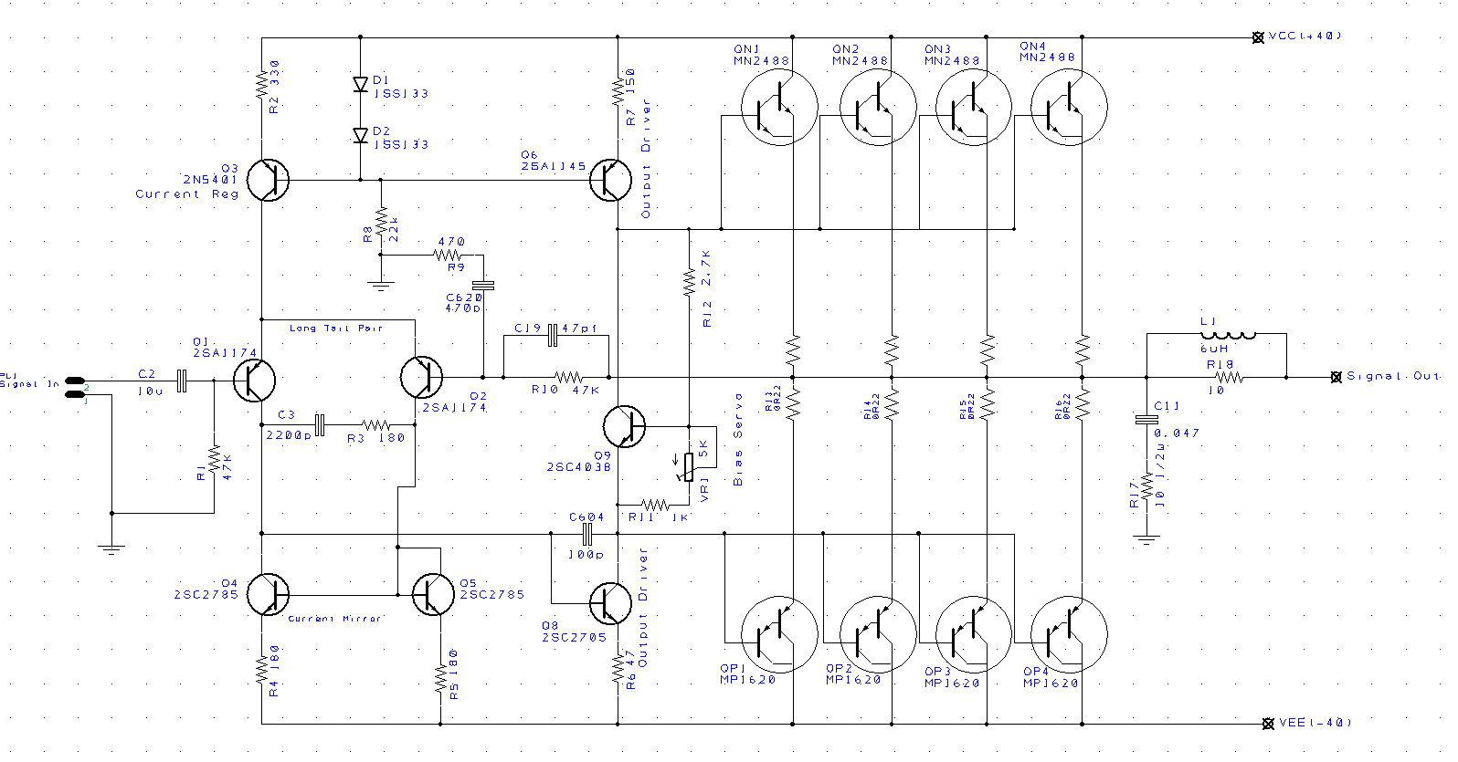

Updated Schematic.
Thanks ... It's really coming along...
Couple of thoughts...
Your feedback path through R10 is leading to the base of Q2, without some voltage division there, it's likely your amp will have very low gain. If you eliminate c620 and connect r9 to the base of Q2 you will get some real gain out of it... too much in fact. You may want to consider adjusting R10 down to about 12k or 15k and recalculating the gain and the value of C19.
I've seen it both ways but IIRC your Theil network on the output would be more effective if C11 and R17 were after R18, right on the output.
If C604 is there for RF avoidance it might be better connected base to emitter of q8, it might also be a good idea to do the same with Q6.
For further RF avoidance, I would suggest a small value cap right on the input pins, before the coupling capacitor, also.
