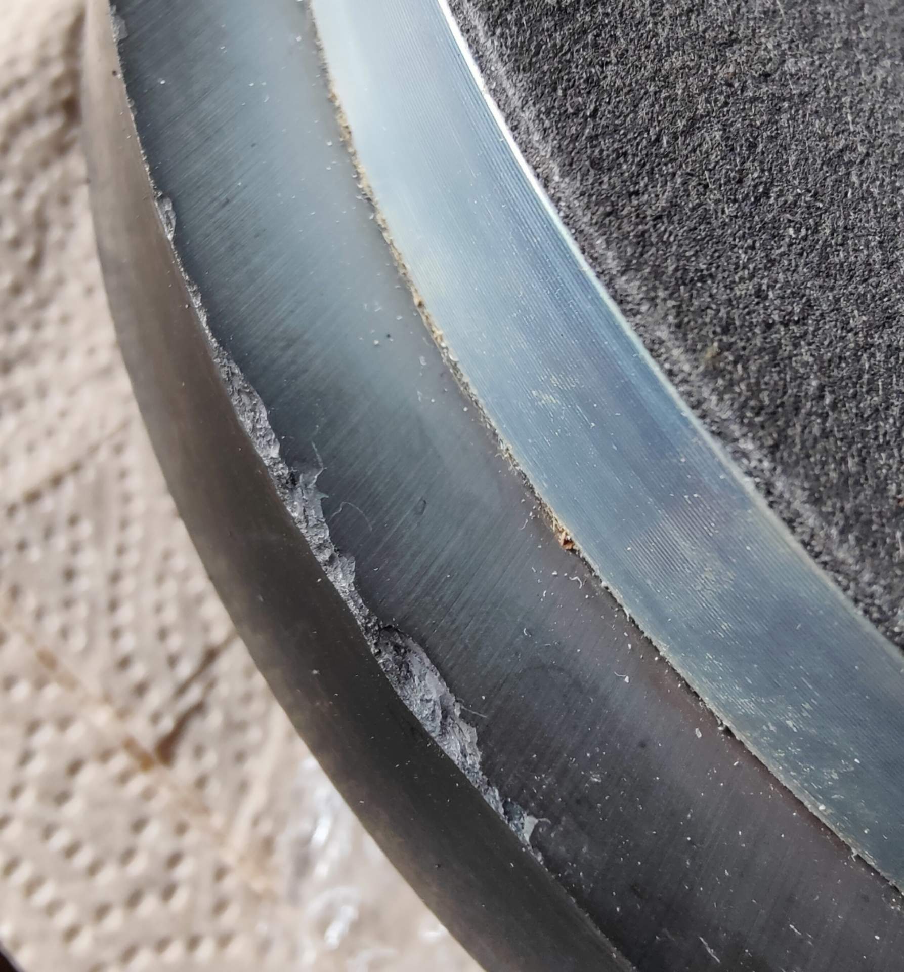

Can someone assess if the broken edges of the magnet ring are of any concern?
I would guess that this is a minor issue?

The magnet might be alright but if you see carefully, there're small cracks that're still developing.

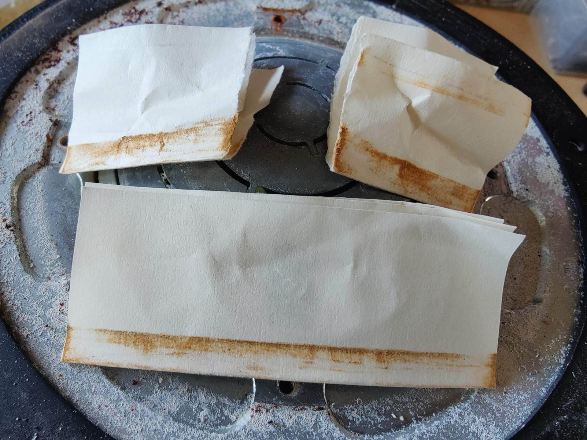

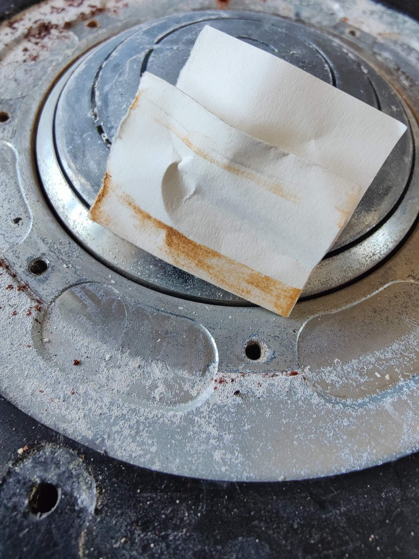

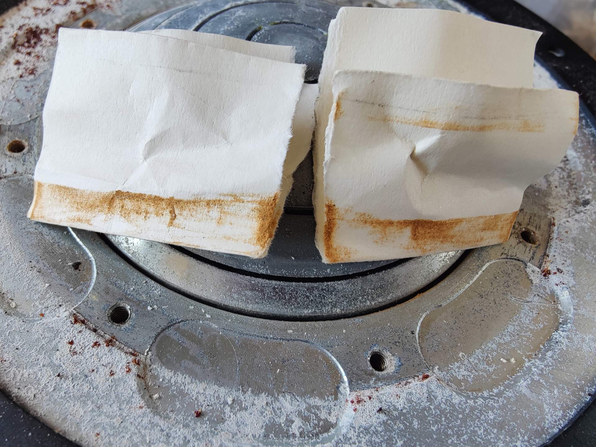

Sweep around three times with folded paper to investigate the VC gap. This is looking like serious corrosion more the outer side:
View attachment 1334286 View attachment 1334287 View attachment 1334288
Even after the third run, it does not look better.
The usual method for cleaning is folded over masking tape, the magnetic gap wants to retain ferrite chips and magnetic particles.
I've been surprised how much magnetic stuff is in "ordinary" dirt.
Since rust expands outward, using fine 240-500 grit wet emery cloth to start with will be much faster than masking tape.
That doesn't have any effect on how the driver performs. However, those chipped off bits will affect its resell value greatly. Especially on vintage drivers where its condition represents most of its value.
