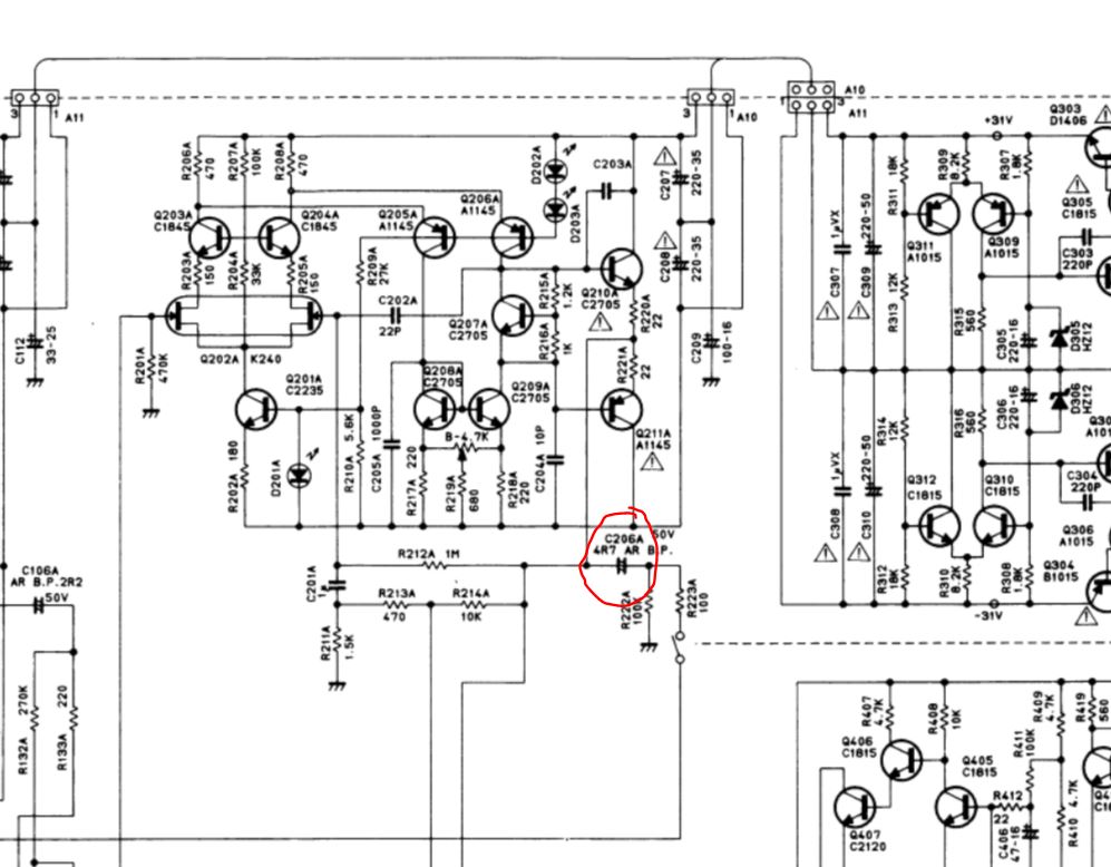

I have a luxman c-02 with weak channel.
This is quite an old preamp I think, perhaps you could tell us a bit more about the fault.
1/ Is the fault on one or both channels ?
2/ Describe the fault... is it just low volume or is the tonal balance affected (such as poor bass) ?
3/ Is the fault apparent when using any input.
4/ Is the fault still present for all settings of the tone controls and switches ?
Yes early 80's vintage, some of the last real Luxman units.
I have had two of those in the last years, and one was still in very good shape, but the other one had been slow cooked from sitting right on top of the matching power amp M-02. Luxman stupidly didn't make the preamp case deep enough for the power amp to stand on top, so most put the pre right on top of the power.. And the M-02 gets pretty hot when working hard!
Anyways, I found many of the capacitors way out of spec, and a few completely dead, and the phono stage looked pretty roasted. My point is that if your C-02 has been sitting on top of the M-02 for 33 years, it will likely need a lot of work. But if not, it could just be some minor thing.
Have you found the schematics online? If not I can post them here if needed..
Edit: A weak channel on old amp is often just due to a worn out volume pot with poor channel balance, and bad connection. So I would check that to start with.
So if this happens on line level inputs (not phono) then I would look at C206 in the appropriate channel as a first step. Its a bipolar electrolytic however if you can measure and confirm that there is no DC voltage across the cap then you may as test short it out. It appears to be the only electrolytic in the signal path as far as I can see.

Hi Highfido,
Sounds like a coupling capacitor, but the whole thing should be looked at. That is a very nice unit. One set of preamp and power amp I've always really liked a lot.
So, where are you so someone close can maybe give you a hand with that? It's good enough equipment that it should be treated well. Not to mention how pretty the set is ...
Consider having the power amplifier gone over before something fails. They are pretty old now, but fixed up they should last years and years.

Is this the one with PCBs mounted upside down ? Repaired a few of those many years ago but later on had to tell owners that they were unrepairable in an economical sense. AFAIK this occurred mostly when they were used with the M02 as heat was transferred. All electrolytic caps have to be replaced and many transistors also were off from heat. PCB tracks also lifted as the boards had been too hot. Then most of them ended up in the landfill, nowadays they are sold on Ebay.
Of all the gear I repaired I recall this one as a tough one as everything was off because of heat. Same with Marantz SC-80 and for instance Proton 1100 which are also nearly unrepairable devices.
