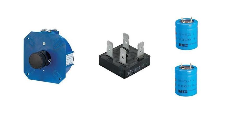

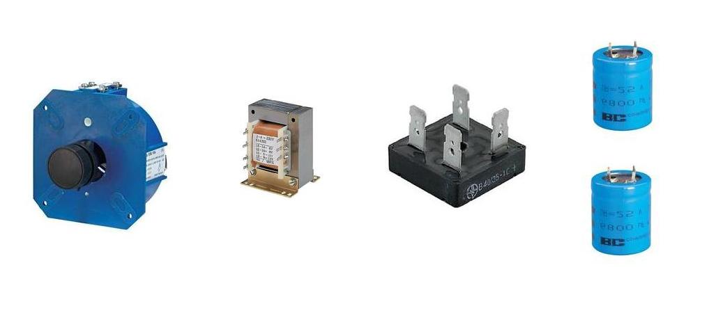

How about constructing a full functional workshop supply instead
Seems more convenient to be able to power up a new raw module, BEFORE connecting to final supply or installing into box
And for testing modding experimentals
Shoot ... vario trafo is only with single "primary-secondary" windings....so it would need yet another isolating supply trafo 😕
Something like that yes.Shoot ... vario trafo is only with single "primary" windings....so it would need yet another supply trafo 😕
Just regard the Variac as a varible AC voltage source. With the variac on it's lowest setting you can switch on the equipment you need to test & gradually increase the mains voltage. A lot of amplifiers will probably stabilise with 0V DC on their outputs with as little as 20V AC in the UK (10V AC in USA) input. Just don't try to drive any speakers or loads without increasing the AC input voltage further 😀
E2A:-Anything with regulated supplies might be a little more problematic in this respect.

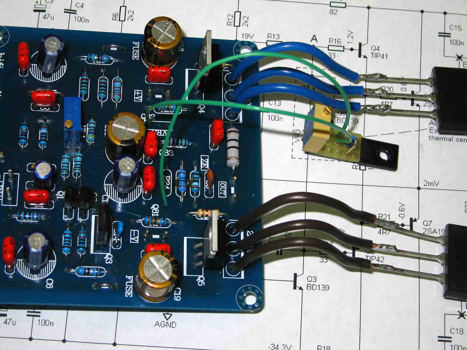

Yup, I remember those slip-ups...My first encounter seven years ago - After successfully P to P'ing a Gainclone, I pressed my luck and bought a pricey Zappulse amp (V2.1) modules and had it working first time up. Really impressed myself (kinda hard to really trip up tho). Then I decided to upgrade the caps to bigger caps and re-powered it but accidentally reversed the rails... boy was I mad. It was 2:00am.
My latest fiasco was soldering a loose neutral wire onto an IEC power connector inside an amp, while connected to the mains (again, in a hurry and 2:00 am). I was real careful not to touch the hot lead, but it didn't matter. Nice big spark and smoke. Talked to a couple EE's at work the next day and finally realized what I did. A direct short. My face was literally inches away... won't do that again....

Progress report....
Hi bryantramos79,
I just thought I'd let you know the progress. I have not applied power to it yet.
3 resistors and 2 output transistors definitely gone, but the rest look good. Hey, don't give up on DIY, you did a good job placing the components and your soldering skills are good. Neat job all round. 😀
I feel the problem was using the BD140 with the circuit on the DX website for the Vbias.
I have cleaned the PCB, replaced the dead components and made a new Vbias circuit. I just need to find a power supply. My test PSU found a permanent home in my main system....I must fix that.
Fingers crossed for when I apply power for the first time.
