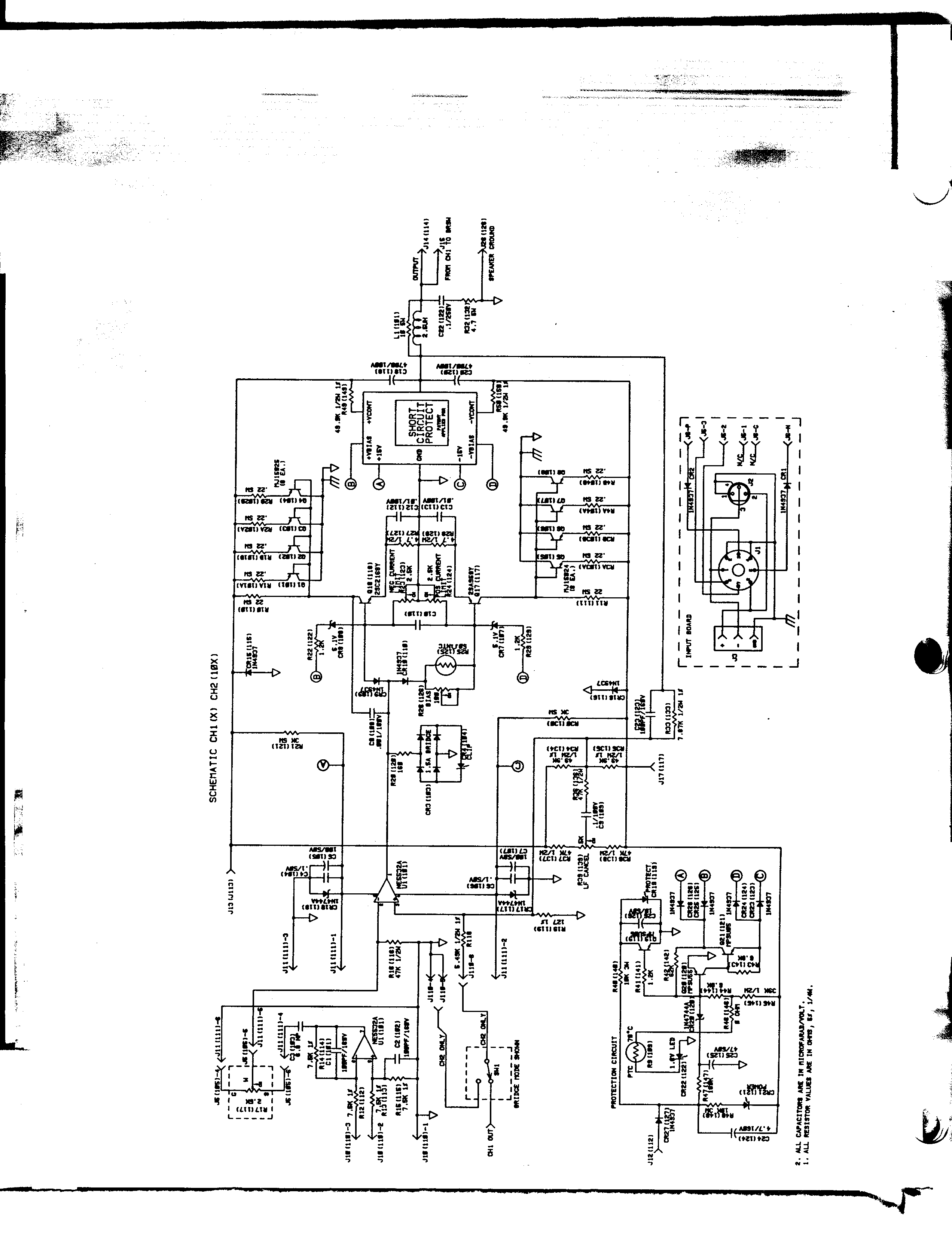

I got this schematic of a power amp, would like comments

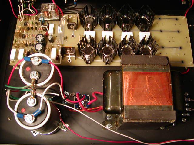

Quote:
burnedfingers :
Nice picture. Isn't there something missing?
Ok, what is missing other than several additional pairs of outputs, sinks, and emitter resistors. Its a single channel subwoofer amp with crossover on board.
Yes, still trying to send the schematic.
hey pat allen
one of the pros of this schematic is symetry...
I like the idea of symetric amps with current feedback..
if you don't like the op amp, throw it away then with r120 & r133 and give 150k r131 & r132 for high input impedance
and instead of these bloody diodes d105/d105/d107 five a Vbe multiplier with pot to set nice biasing (say 60mA per pair)
Maybe also some power darligtons at output.
results may be nice I think
cheers
The main heatsink for the output devices is missing :bigeyes::bigeyes::bigeyes::bigeyes: This picture is probably a bad joke since these small stamped-aluminum-sheet heatsinks are rated at more than 15ºK/W and would reach funny temperatures when playing loud in any circuit with rails above +-30V and/or driving loads below 8 ohm, particularly in a closed case with no air flow
Also, there is no thermal tracking between output devices so big current mismatching is guaranteed to occur
NOTE: A transistor mounted on a 15ºK/W heatsink and dissipating 10W will heat up to 15*10=150ºK above the ambient temperature :hot: :hot: :hot:
And I'm not going to ask how did you burnt your fingers... [just kidding but be careful with hot surfaces 🙂]

This picture is probably a bad joke since these small stamped-aluminum-sheet heatsinks are rated at more than 15ºK/W and would reach funny temperatures when playing loud in any circuit with rails above +-30V and/or driving loads below 8 ohm, particularly in a closed case with no air flow.
Well, looking at it from a view not shared by this picture there will be a 105 cfm fan cooling those small heat sinks. The B+ and B- voltage is 65 volts. The later version I built had a sensor on the heatsink to switch the fan from medium speed to high speed.
Funny thing is that it never switched to high speed unless it was being tested.
Well, the amp is debiased on purpose as to not have a problem with thermal runaway of any type. Distortion was still way below .1%
Well, one has to account for the type of usage of the amplifier. In its application (subwoofer usage) it normally does not see anything close to what a full range channel would see. In normal operation it doesn't heat up and run hot. I don't consider it a problem then. Only when run into a load at full power does it heat up. With a full set of outputs it is 2 ohm stable.
Now, it is easy to find fault with others work. By the way what have you built that has survived over 14 years? I have over 50 of these in different theatre systems along with custom designed subs and drivers and they are still running without any problems.
I knew someone should say something good about it, because it does sounds respectably good and gives incredible power for what it is.

Did you get the schematic I posted?
Pat
After looking at your schematic and your heatsinks...is there a problem of C rise for you also? As mentioned before the 4558 is a dirty Op amp only slightly better than the 1458. I would try a 5532 in its place. A 5532 is a common commercial Op amp that is pretty clean and doesn't suffer from the problem of latching up to the rail like some Op amps do. It might also be a good place to try an OPN. Unless I missed it I didn't see decoupling caps close to the Op amp. You might want to add some small ones.
No, i have no problems with overheating at all, this amp runs good during summer.
One thig i may say, they dont suggest to run it in bridged mode with a 2 ohm load, but a 4 ohm one. I do run it at 2 ohm at full volume, i ran very hot and never run out. 😀
There is no caps around the op amp, so i may add few if i redo the pcb.

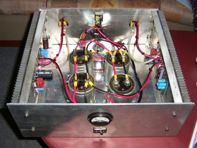

The amp pictured above is not the amp on the schematic, but it will.
This pictured amp is a Zen amp. :angel:
