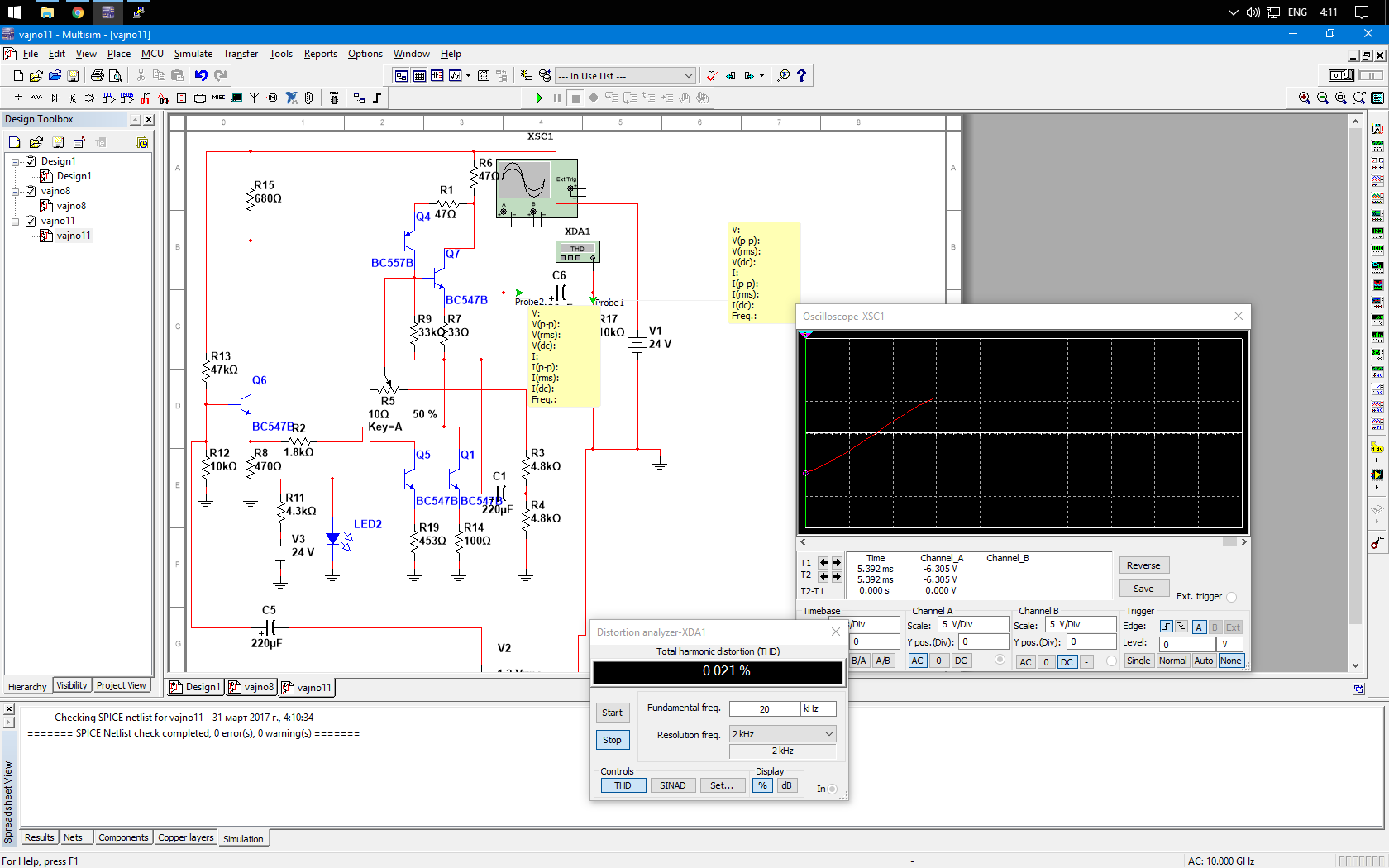

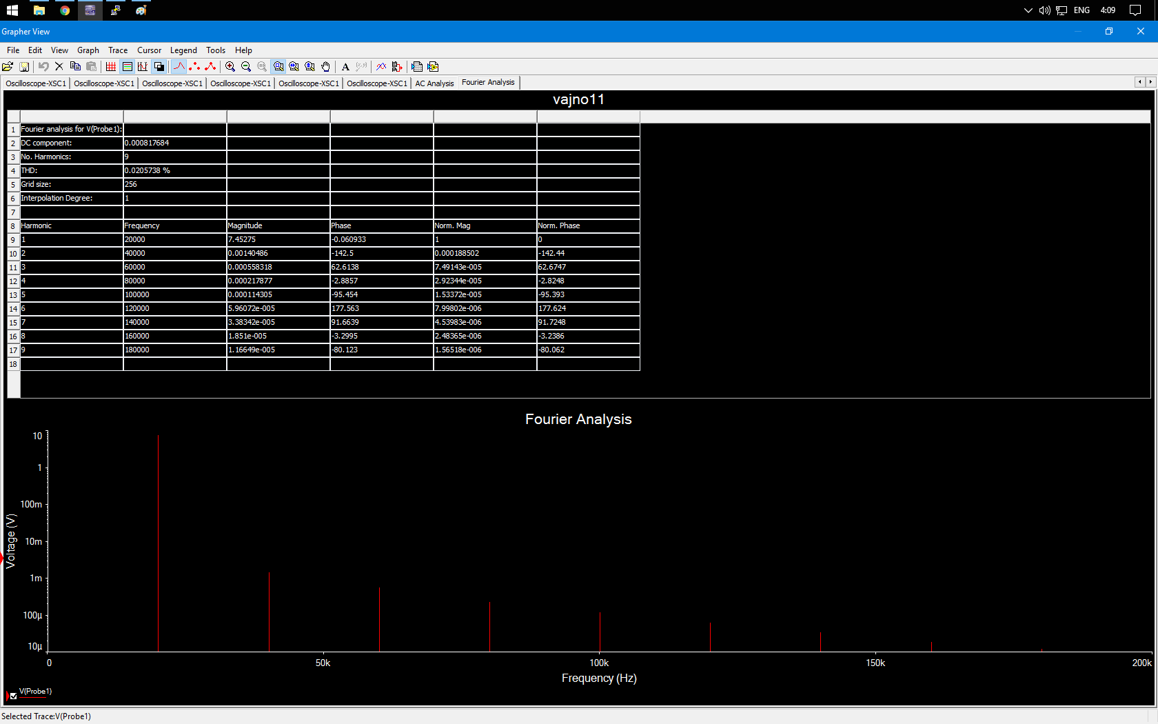

I got the harmonic pattern I wanted

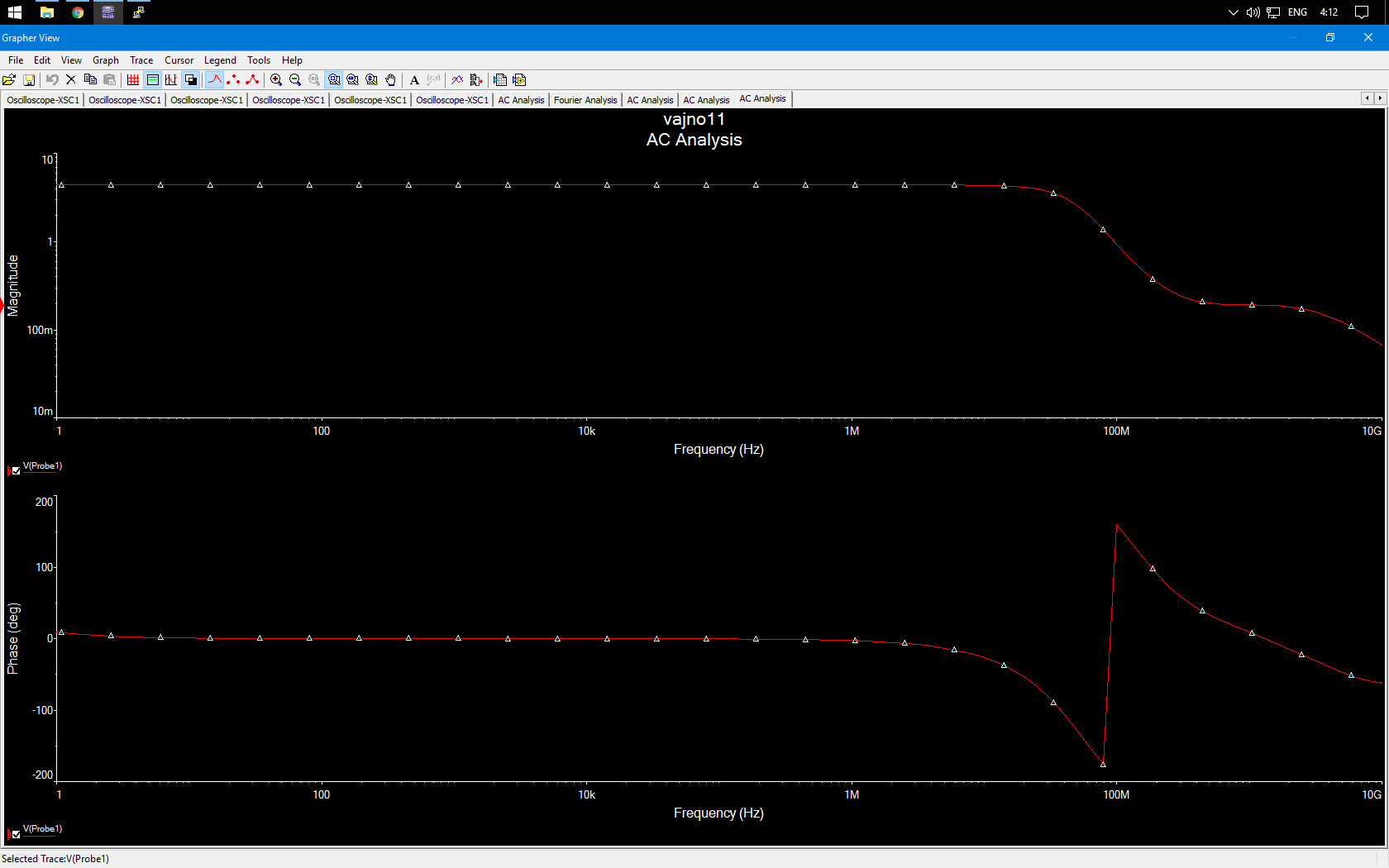

There is no compensation cap because of R1 and R6 and also because its a CFP VAS.
The AC Analys prooves it.
The Fourier Analys is at 20khz.(0.021%)
