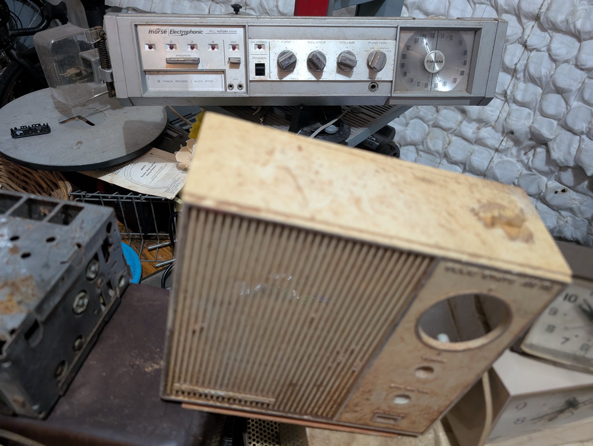

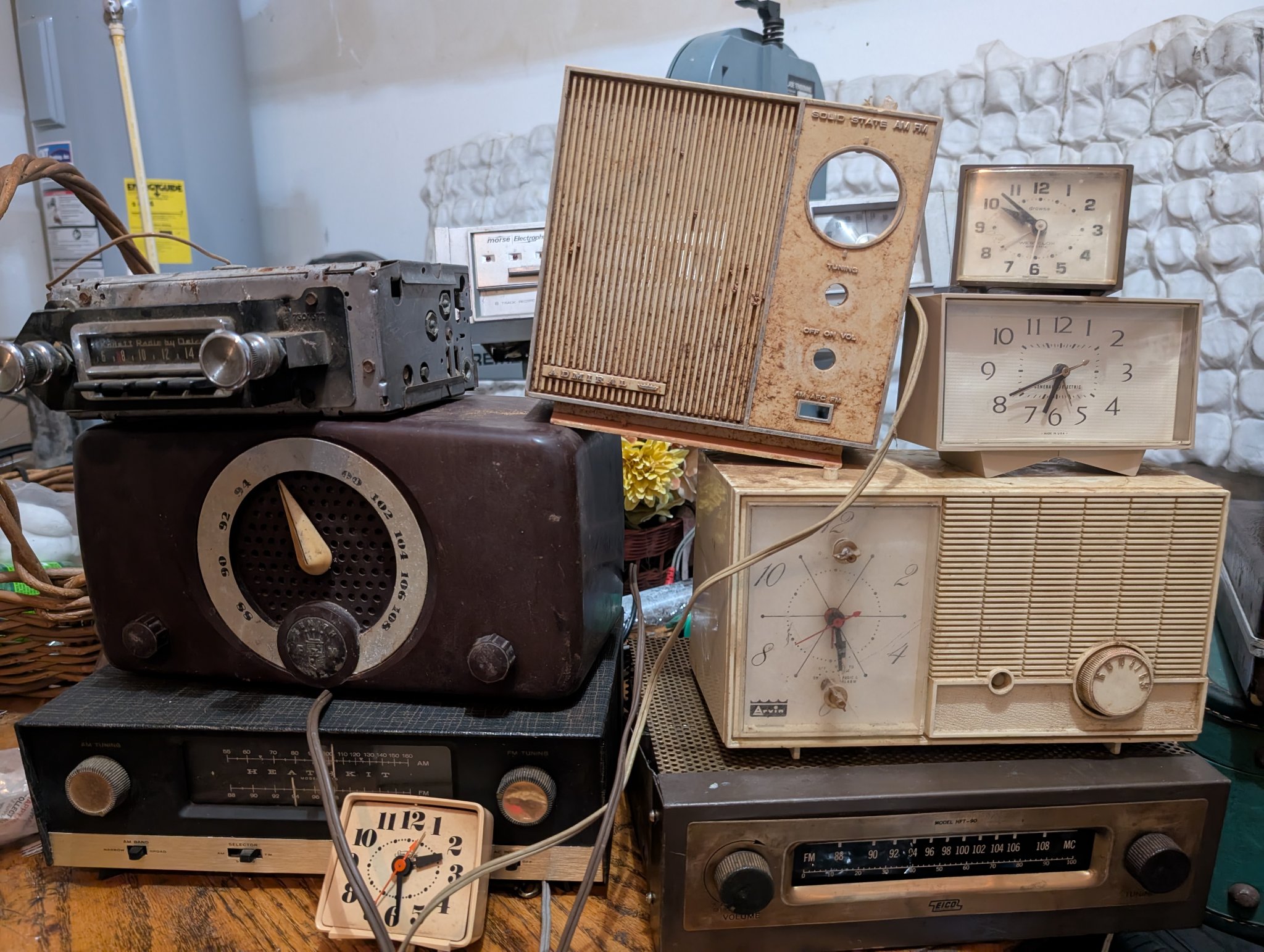

I found all these vintage parts. Are any of them worth anything? Worth keeping or selling? I'm actually building a Marcel DAC and am willing to trade
Here are the radios. And a couple clocks. I still need to clean them up more though.

I already fixed the fisher x100c
& The stereomaster 384
Tested all the speakers.
Fixing the eico 2080 next...
Stereomaster had a broken volume knob,
Fisher had a broken pot for the treble adjustment.
Fixed the eico radio in the photo
The heathkit radio in the photo already worked

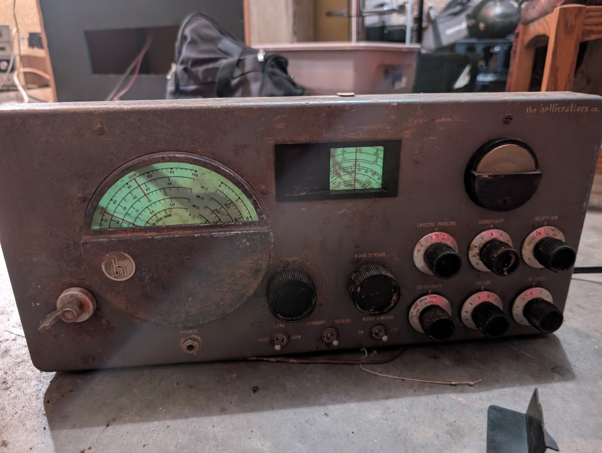

The helicrafter needs one new cap, 80MFD.bipolar.
And I need a 5v4 tube for the w3m to test it...
Same with HH Scott, needs one new tube....
