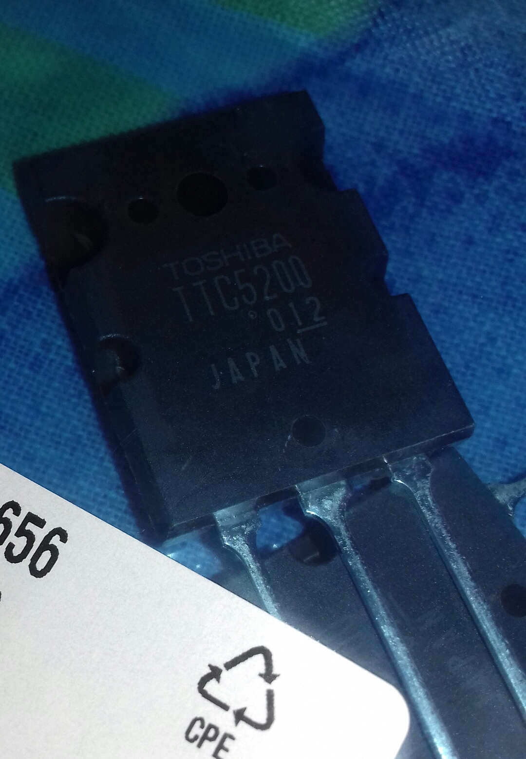

Is anything specific to “pair” them? buying a few extra should be sufficient?I was going to suggest Lineup 4watt Class-A too. I already bought couple of TTC5200 pair especially for that amp 🙂
Nothing specific, i said that because each channel requires a pair of npn transistors.Is anything specific to “pair” them? buying a few extra should be sufficient?
For me? Yes, more than enough.

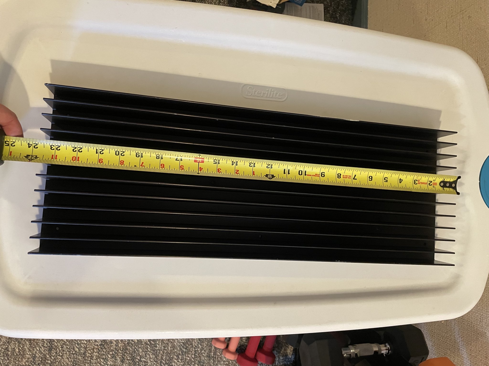

I'm ok with moving the heat, I have plenty of experience in that area.
Might be time to punt on the class-A until I learn a lot more EE. 🙁

I'm almost ok with using 1/2W rms per channel on an amp where clipping is at ~2W output, expecting 8-10W as heat. That would give me 200-250W consumed by the system.

- I found a giant heatsink. ISO Simple <2W class A projects?
