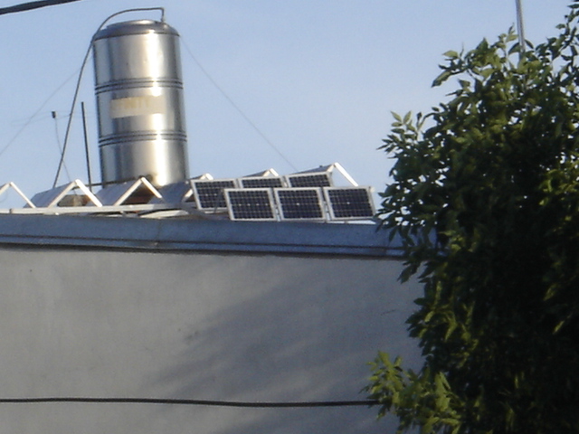

Since several years ago I'm experimenting with solar power at my house.

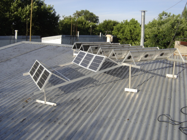

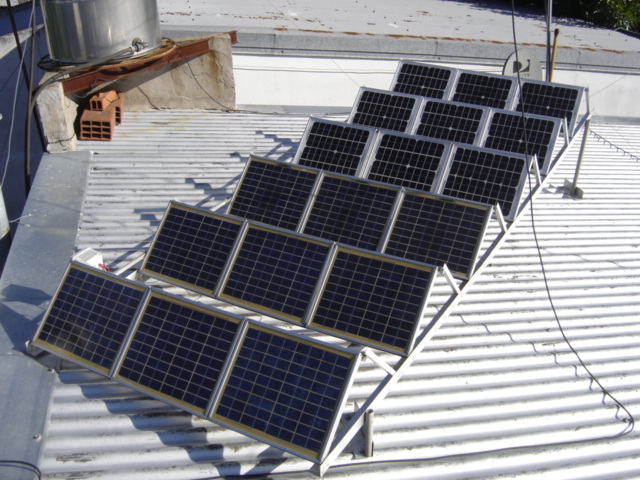

Until a months ago I had 18 solar panels of 18W peak, "looking" to the North East (South Hemisphere) to take advantage of the morning sun (Say, now in summer, from 7AM to 14AM), to recharge the batteries of the night discharge of the refrigerator, lights and some minor power demands from it.

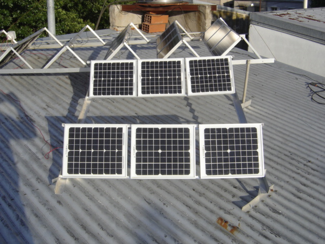

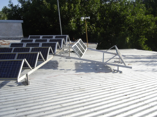

But I also wanted to improve the charging time over the afternoon. So, I decided to add 6 more solar cells identical to those that are currently in service, and reserved space for 3 more that are brought but not yet installed. So, actually I have 24 units operating. The new ones starts their production from about 12AM and decays well over the 7PM. The are installed in the same place than the others, but at right angle respect to the firsts, and so looking to the North West. So, in place of have too high current downloading from them, I have about the same as before, but extended in time, which is best in my opinion. Voltage in the batteries at the morning previously to the regulator to start charging, confirms it.

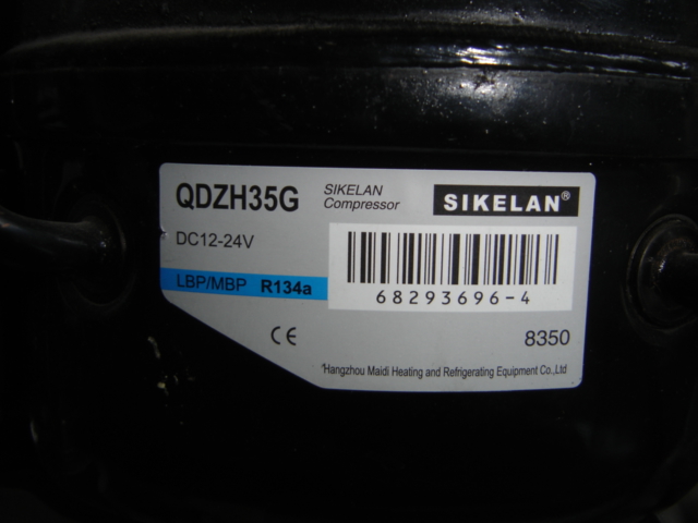

Then, my refrigerator, part of the indoor lightning, my ham radio station (partially but including packet radio modem and mic preamp), the wireless phone base, and the weather station base (USB step down regulator in the middle) are powered from them.
I'm very satisfied with the progress. Those that originally started as a game, now is reality and a must, because power grid shutdowns here are very frequent and sometimes, extended in time.

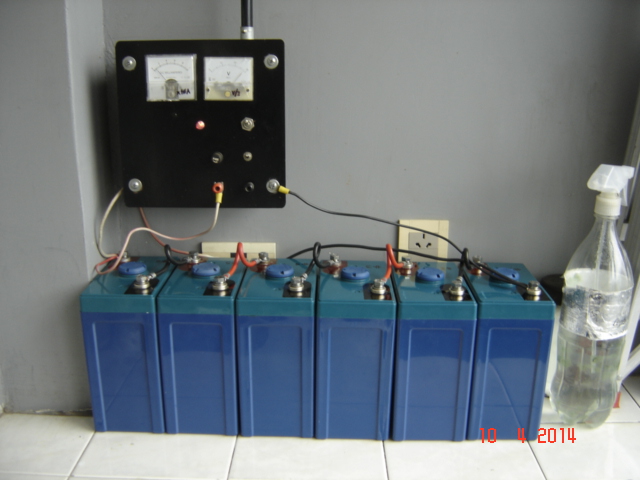

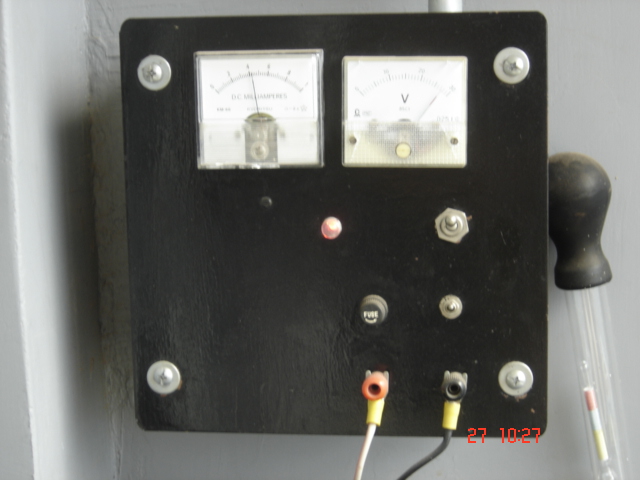

The regulator in the black box with the ammeter (actually a 1mA unit shunted to 10A) and the voltmeter, is a switching type, made with two complete discrete SMPS's running at 100KHz but 180 deg out of phase. As solar cells are basically current sources, I need a sort of converter from high resistance source to low resistance load (Batteries). The buck regulator is capable of making the job, and the use of two units in counter phase enhances the current handling capabilities at the same time that lower ripple is obtained.
I avoided under any case the use of movable parts as they are naturally weak and beyond the scope of my knowledge. So the static solution is my election. The only maintenance they need is to clean them with a wet rag to get rid of dust and bird feces.

As I said in the previous message, inverters here are expensive, electrically fragile and bigger in size. Their efficiency is naturally low and the system I installed suffices in capacity to my own use only. Over it, some non critical electric appliances like clothe washing machine drains several watts (VA in true) and need higher peaks of current to start those AC motors, and continue being outside the DC system.
If you want to know about the batteries, they are Vision CL150, and I have 7 of them, 6 in use and another idle. Each first week of the pair number months they are rotated, so always are in use.
I don't know exactly what the acronym stays for, but if as I suppose refers to those charger that searches for the best point in the curve of efficiency of the solar cells, it isn't. I believe that some kind of auto search it does, but really I didn't designed it to do such a thing. Soon I will post the schematic of the regulator, but actually I have it only in ASCII art or old DOS OrCAD formats.
