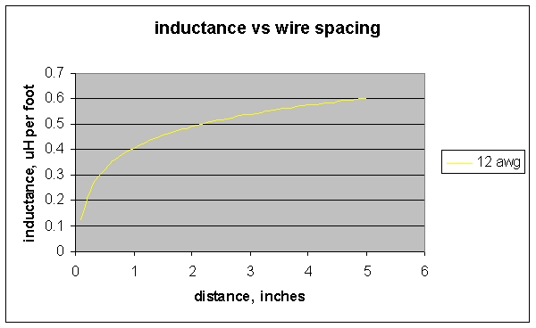

Here's a graph of a #12 parallel wire inductance. As is seen, the inductance of the pair will go from a typical of about 150 to 160 nH per foot, to a value of about 600 nH per foot at five inch conductor spacing.
For a 10 foot run, that translates into a difference between 1.5 uH to about 6 uH.
Cheers, John
