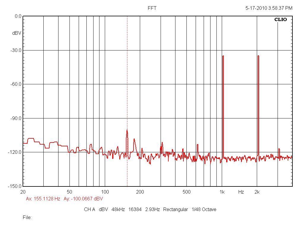

I don't believe cables make a difference, any input?
I see 60, 120,180, etc. This is what I see above the random noise.
Your the Amp man so you see this better than I do but looking the the FFT same cable 2 sine input I don't see any spikes?? 180hz but others?
Rob🙂

Just for fun here is what an interconnect looks like in my CLIO loop. The references is -10db top of the graph that's a THD measurement.
Rob🙂
Any details on setup? How were you able to isolate the results to the cable (i.e. what did you compare it to?) It would take a miracle cable to generate that much distortion, unless it's that active one Stereophile tripped over a few years back.
