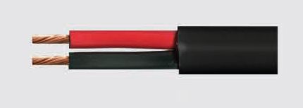

The power loss in speaker cable or any non coaxial transmission line is (I^2*R), current squared time resistance. Whether speaker cable loss is noticeable depends largely on the power level through the cables. Is it important if one cable is 4 feet and the other is two feet, not really. But if we are talking about 50 or 100 feet then yes it is significant and cable lengths should be equalized.
Some manufactures of speaker cable will boast of independent strands to reduce skin effect. This is bull because skin effect doesn't occur until radio frequency is reached and becomes increasingly more significant with an increase in frequency.
At the low end of the RF bandwidth it's not even a concern at all.
An 8 ohm speaker may have a DCR of around 6 ohm not including the complex impedance of the speaker. The DCR of a speaker is effectively in series with the speaker so your amplifier is always, seeing at least the DCR. This may very only by the crossover network in the speaker and number of speakers in the system. So at what cable resistance does the loss become significant?
Speaker cable follows the same electrical physics that any other wire does.
95% of all said about high end speaker cable is just marketing.
Do the math and make sound decisions.
This argument also applies to damping factor.

Here folks is my cable. I buy it in 100 meter rolls from an autoshop. It's black and thick and strong. It also sounds just fine.
