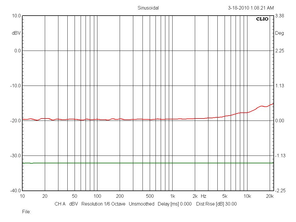

Here is a measurement or a 3ft interconnect. It's a 20 year old Diskwasher Goldens cable. Looking at the Red curve there is about 1/2 degree of phase shift at 22K. The Green is a sweep sine frequency response.

Of course speakers are a nightmare, but you do get used to hearing what you have. I would doubt seriously that anyone can hear 1/2 a degree difference over six or eight octaves. Attenuation of one end of the spectrum or the other seems more likely in a badly screwed up piece of wire.
Thanks for posting the graph.

Many have reported 5 degrees at 20K!
