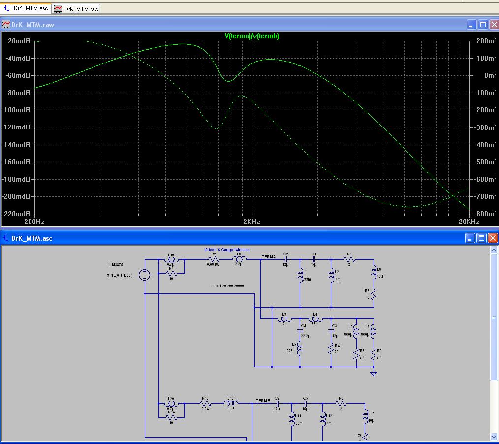

On something constructive for the diligent skientifik minds here:
Run some parallel SPICE sims using the RLC values for your favourite cables, driving a model of your speakers, and using the RLC values for equal lengths of different cables, driving a model of your speakers.
Plot the FR difference between the two.
That's likely to give a much better picture on just how much "cables make a difference".
It certainly did, 500 posts ago.
Yes, a "pathological" 2:1 difference in R/L over your 10ft 16 guage results in a difference of 0.191dB at 20kHz and 0.052dB peak-peak variation over 20Hz - 5kHz. That will make a hugely audible difference.
We need no stinkin' simulations, we believe what we hear.
For the sake of accuracy that's 200 Hz. Since the primary impact seems to be from inductance, probably not a big deal. Do same for what's being recommended by Roger Russell and Audioholics on the basis cables make no difference. Or play with speaker loads.
Measured response for 25' of 18 gauge was 3/4 dB down @ 20 kHz into an inductive tweeter using an amplifier with no output inductor. That makes the available Spice cable models suspect for me.
Typo, so sue me.
Down to to 20Hz adds a whopping 0.02dB.
The 10' 16 gauge was presented by you as some kind of minimal-requirement cable wasn't it? Plotting its impact on the frequency response alone is pointless. Compared to a much "better" cable with half the R and half the L the overall difference is practically negligible.
