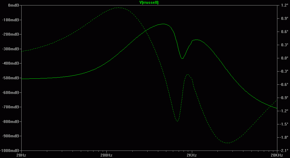

Your post reminded me I owe boconner a graph. Below, a Spice sim of the frequency response at the speaker terminals of 15 feet of 18 gauge - below the maximum recommended by conservative sources like Roger Russell or Audioholics - driving the DR MTM project from PartsExpress. The amplifier has infinite damping factor and no output protection coil. The cable is modeled in 1 foot pseudo-lumped sum segments from values in a Nelson Pass paper. This is why probably why speaker cables are considered more audible.
