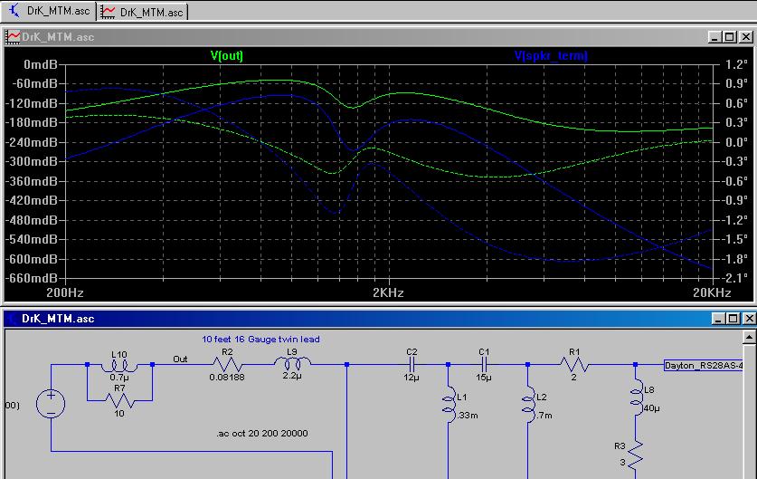

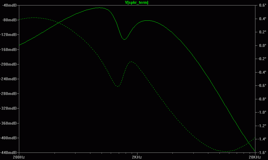

Into a complex load. Below, lumped parameter estimate of ten feet of 16 gauge, minus capacitance, into the PartsExpress Dr K MTM, again chosen for the well-documented Dayton drivers used. No wonder the MIT is potentially audible. Yes, only prosaic scientific reasoning is required to explain it, harder is it why reports were dismissed instead of metered.
Edit: forgot, my brother stumbled across this thread and reminded me of MLSSA tests he'ld done at either ends of speaker cables. The variance was over 0.8 dB, prompting to switch to heavy gauge afterward.

Can you explain the "Four Twinned" cable?

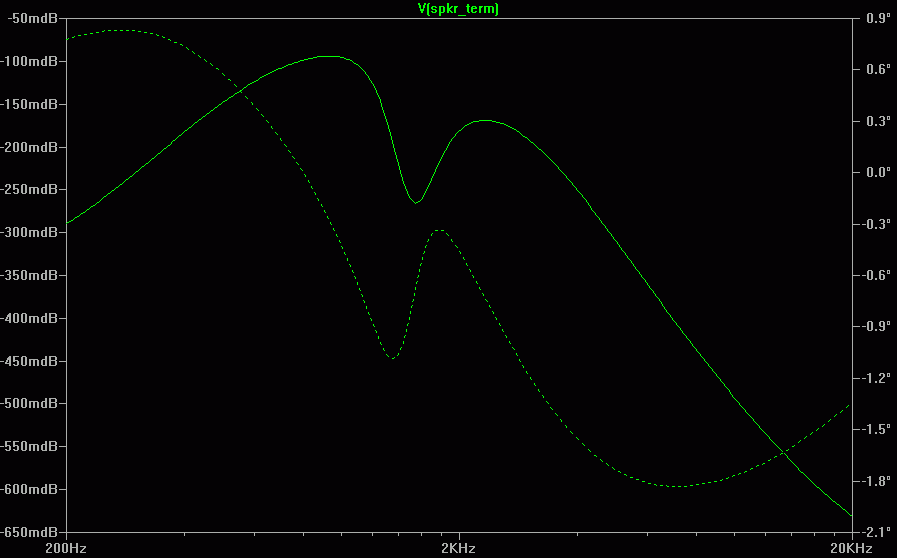

Nope, don't know anything about it. From the pics MIT soldered an inductor inline, which can't help but have some impact at the top end. When the model used for the above trace includes National's 0.7uH output inductor and Zout estimate for a damping factor of 100, the results become:

Iain, I would say it's low impedance speakers with high damping factor amplifiers that will see the most effect. The speaker wire impedance is in series with amplifier's Zout. If the latter is already twenty times greater than typical 16 gauge, which is the case of some tube SE gear, cable makes little relative difference.
If you remove the effect of the Zobel, the FR is down about .4db at 20k. So the diff between the wire you simulated and a perfect conductor might be barely audible to some, but you need to compare against different cables not against an ideal cable.

If you remove the effect of the Zobel ....
The woofer Zobel? 12uF into 20 ohm? That should increase the midband impedance peak and the FR variance, as a side effect of destroying the x-over optimization.
That 0.8 dB number is in Paul Bunyan territory BTW.
IOW, it's down to LCR and frequency response. Welcome to my side.😀
Actually, I think the greatest audibility is for things like the old Watts, where there was an enormous impedance dip in the midrange.
He's referring to the 700nH // 10R. (You plotted the sum of that + the cable).
And the point about referencing this to an equal length of better speaker cable is perfectly valid.
