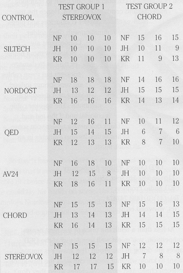

Hows this for cable sound?
Finally a Hi-Fi glossy did a blind listening test on cables. The following cables sets (both interlink and speaker, as sets) were tested (set price in UKP, multiply roughly by 2 to get US $, in brackets):
Nordost (UKP 6500), Siltech (UKP 7700), Stereovox (UKP 10300), Audience (UKP 2000), Chord (UKP 1650) and QED (UKP 120).
Blind test, three listeners, using 3 separate pieces of music each trial, two trails (with different equipment set up).
They did a clever setup: the first cable set was by definition rated 10 points, so each following one had to be rated more or less than 10, better or worse, as to preference rather than specific attributes. A neat way to assess preferences without going into the numbers fight.
Sounds pretty well thought out and logical, right? Wait till you see the results and what they did with it...
Below are the results in raw data. Now, some of you will tell me this is copyrighted material. I know. I looked up this issue, and it appears that it is accepted practice to quote some limited parts from an article with the sole purpose to facilitate discussing the issue and with full acknowledgment of rights, and without any commercial purpose. So here goes:
The table below is from Hi-Fi+ magazine, UK, Issue 34, page 22. Copyright Hi-Fi+.
What do you think of this? Hint: look at the 1st group score of the Siltech (approx US $ 15.000) and the QED (aprox US $ 240). What would you do as the editor of the magazine?

Hi Bear,
I agree with most of your post, but that wasn't really my point.
The way they set up the test seems quite professional. And since they did such a good job, I am allowed to accept their results, no? They published them, so they must stand behind them. And the results say that in the first trial ALL cables, including the lowly $250 QED, were preferred over the $15.000+ Siltechs, by all listeners with all music. Doesn't that tell me anything about cables?
But there is more:
"[the Stereovox did poor wrt their prices] "Yet having listened to them in isolation I'd consider them worthy of higher marks", and goes on a search for arguments.
There, in one fell swoop the guy completely ridicules his own carefull blind test and exposes his nakedness. This is an insult to any half-intelligent reader!
Either you do a blind test because you thing it is a right thing to do, and stand behind it, or you think it's all a load of Jacksons, and you don't do it. But doing it, and then afterwards going to great lengths to fudge the results unashamedly to make them match your preconceived beliefs, its unethical to say the least.

janneman said:
Hi Bear,
Yeah Jan, you can accept their results. But what meaning do these results have??
And no that test tells us nothing whatsoever about the merits of said cables!!
It does tell us what the preferences were in this test - which may or may not be meaningful with equipment other than the equipment and environment where the test was held.
But there is more:
Please don't make me responsible for anything that other people are writing!!
Jan Didden
