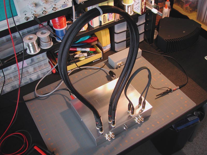

The ouput impedance of the source is that of an opamp -what the cable will likely see if used, say, between a preamp and a power amp. This is the graph of (Vin-Vout)/Vin, in dB. So, the top (red) curve is for a cheap interconnect, which has higher overall losses than the other three.
For some reason people seem to prefer (sonically) cables with very low losses, and not only because they are "louder", so if we make all graphs concident at 1 kHz, we won't see the true magnitude of losses. Here we are trying to correlate actual losses to what people are hearing.
Having Vin and Vout in the same graph would show as a single line: keep in mind that Vin and Vout are almost identical to each other, so you have to show the difference between the two, relative to something, that "something" being Vin.
No problem showing the phase response (I turned it off for clarity in the first post).

Measuring audio interconnects
The chart shows the magnitude of losses in interconnect cables, relative to the input signal, in dB.
The instrument consists of a "silver black box" where the cable under test is connected, fed by the desired signal (chirp, pink noise, music, whatever). At the output of the black box you have the losses for the cable under test, which you can listen to, or measure in the time or frequency domain.
In the attached picture you can see the 2nd prototype, where I was measuring a low-cost short cable and a long expensive one (it's a 2-channel instrument, so two different cables can be easily compared).
I hope I answered your questions...
R
Could you please explain what that chart is? What does it measure and what was the basic test setup?

Exactly. I think your experiment is exageratig the effects. And then misrepresenting them. You make it sound like one cable is down 20DB at 20k compared to another, which is rubish. What your saying is people can hear the diference in less than .1 db of attenuation between 2 cable while te F response is almost identical. Im having trouble buying that.
The experiment is showing the actual magnitude of losses for all cables, and there is no exaggeration of any effects. Believe or not, losses in a high-quality cable can be 20dB lower than those in a low-cost one.
Here I’m showing how different cables can be, which is the point of my post.

Can you help me understand more about how the 20dB could be for real?
Remember, dB is always a relative measurement. If wire 1 has twice the series resistance as wire 2, one can say that wire 1 will drop 6dB more than wire 2, even if the actual delivered signal level variation is negligibly small (e.g., 0.01dB versus 0.2dB).

The source impedance is the output impedance of a typical opamp, so it's "low". Keep in mind that I'm measuring the cable losses relative to the input voltage, so any frequency response anomalies due to source impedance are eliminated.
Termination impedance is 10K for now, purely resistive, but it can be "anything" (within reasonable practical limits). R//C loads are not a problem.
Typical source voltage is 2V RMS, but can be lower if the noise floor in your test environment is not too high.
R

If passion re-posts the graphs showing actual voltage levels I think it would be much clearer. (and plot the Vin Vout ) This will show that Vout will be Vin(1 voltish) +/- micro volts? for different cables.
Another way to put it; The relative levels show the resistance of the cable. If 1 is .ooo1 ohms and the other is .01 ohms thers 20 db difference but compared to a 10k input even 1 ohm or 40db will be inaudible.
