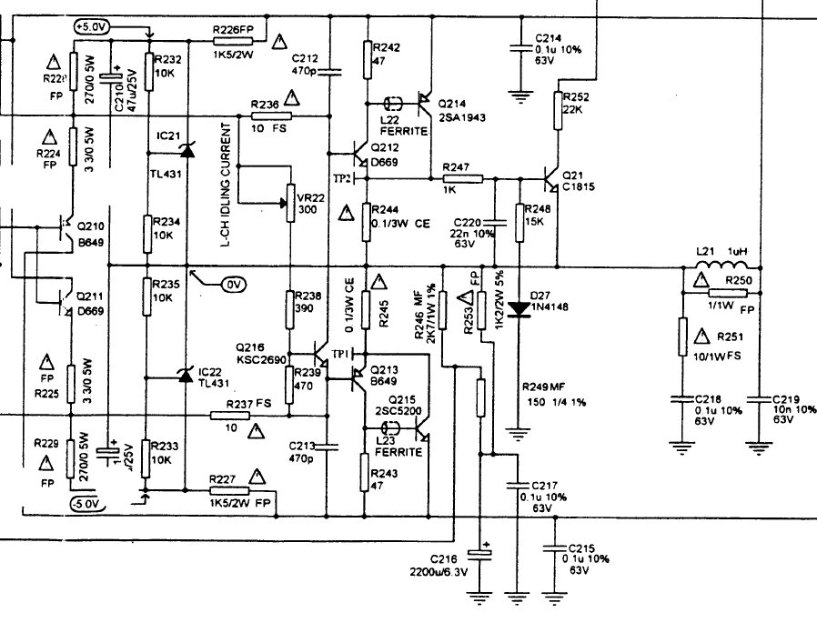

Looks like you dumped the +48 rail into the O/P over current circuit. Not likely agreeable.... I'd look at Q21, Q212, Q214, Q216, Over curre3nt input cap C12/1 and op amp IC44 in the overload circuit. As a CAUTION note: Don't adjust anything while in protect mode! If you have try to put things back where they were before you continue.

I don't think D27 is connected to the output rail.
If the emitter of Q212 was connected to the positive rail then the Vbe max of Q212 would have been exceeded, blowing the driver transistor. This would also connect the base of the output transistor Q214 to the output through the RE resistor. The emitter of the output transistor is held @ the positive rail potential, with the base held a smidgen below. If the base of the output transistor were connected to the output of the amplifier, then the positive rail would also be connected to the output of the amplifier albeit through a 47R resistor, so the current would be limited to ~1 amp. Surely feedback would try and keep the amplifiers output @ zero. If the amplifiers output were kept close to zero the base of the power transistor would also be at zero, Veb max of the power transistor is -5 volts, ergo the base can be 5 volts below the emitter. With the emitter being held @ the positive rail voltage, if the base of the power transistor were to drop more then 5 volts, which it could quite easily do if the amplifier through feedback tried to keep the output at zero then the output transistor would die.
I suppose if the amplifier tried to compensate from having the +ve rail connected to the output via a 47R resistor then perhaps in compensating it placed too great a demand on the VAS and blew that.
Anything could have happened when you accidentally shorted things, one thing could have blown first that prevented the death of the others, like maybe the VAS blew and prevented feedback from keeping the output at zero and saved the output transistor etc, or you could have setup a cascade of silicon failure that blew a number of devices.
You say the DC offset is still quite low, but this is presumably on the outputs of the amplifier itself, at the output terminals, rather then at the amplifier PCB itself. Have you measured the DC offset before the inductor coil on the output?
Being able to set the bias seems like a good thing, have you made sure that the voltage dropped across each RE resistor is the same? The amplifier appears to test for the bias as the total across both of the RE resistors. Measure the voltage drop from TP1 to the output of the amplifier (before the output inductor L21) and then measure the voltage drop from TP2 to the output of the amplifier (again before L21), they should be almost identical. If they are not something is wrong.

Today i replaced Q21 and voila : green light at last!
As i had too little time i only managed to measure the offset in the outputs: 35mV on left and 37mV on right channel. I also noticed that the heatsinks of the drivers still get really hot. Except for repeating the allighment procedure again (and carefully this time), is there something i should check before connecting the amp to the speakers?

Someone tried to fix it, but the fix looks dodgy - it plays, but the red light nether turns green.
When I looked inside, I found the guy who was fixing it had connected D412 diode beside speaker terminal to the '-' speaker terminal. He also changed damaged resistor R230 and transistor Q28 to similar ones but bigger.

This story seems remarkably similar to mine. I was recapping the amp with films throughout and new electrolytics where not due to the documented problems with the decline in the electrolytics used in this amp.
I was rebiasing and I had a spark jump to transistor Q112. It has defo taken out output device Q115 and who knows what else. I guess this is a similar story but the other side of the amp. Unfortunately, being some years after these posters now I can't find some of the devices required. I've had a look about and there are some suggested devices though, I feel like I could do with a bit of advice on how to implement the repair though and if the suggested devices will fix it without any more sparks and magic smoke.

This is where the spark jumped to and I haven't had them out to test yet and they don't seem bust from my rudimentary tests but I can't imagine it's done them any good and maybe I'm testing incorrectly.
B649,D669: These devices are obsolete. There are recommended replacements of KSA1220 and KSC2690 (and one of these is actually in the original design). Q1) Again, can I just drop in if required? Q2) Are certain grades better matches to the original devices (got AYS grade in my Mouser basket)? Q3) How important is pairing?
Before the sparks and magic smoke incident I also found that like the above poster the drivers were getting very hot as well as the resistors R126/R127, R226/R227 to the point that there is visible discolouration of the circuit board. If there's an underlying issue that would stop this too then I'd like to sort that too.
