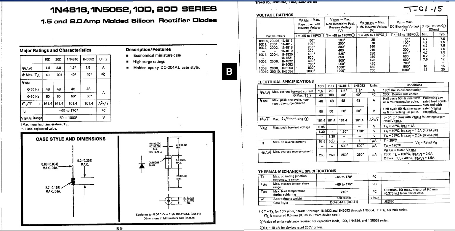

The D511 appears to be a 600v 1A diode ( the old 10d1).
I will replace that .

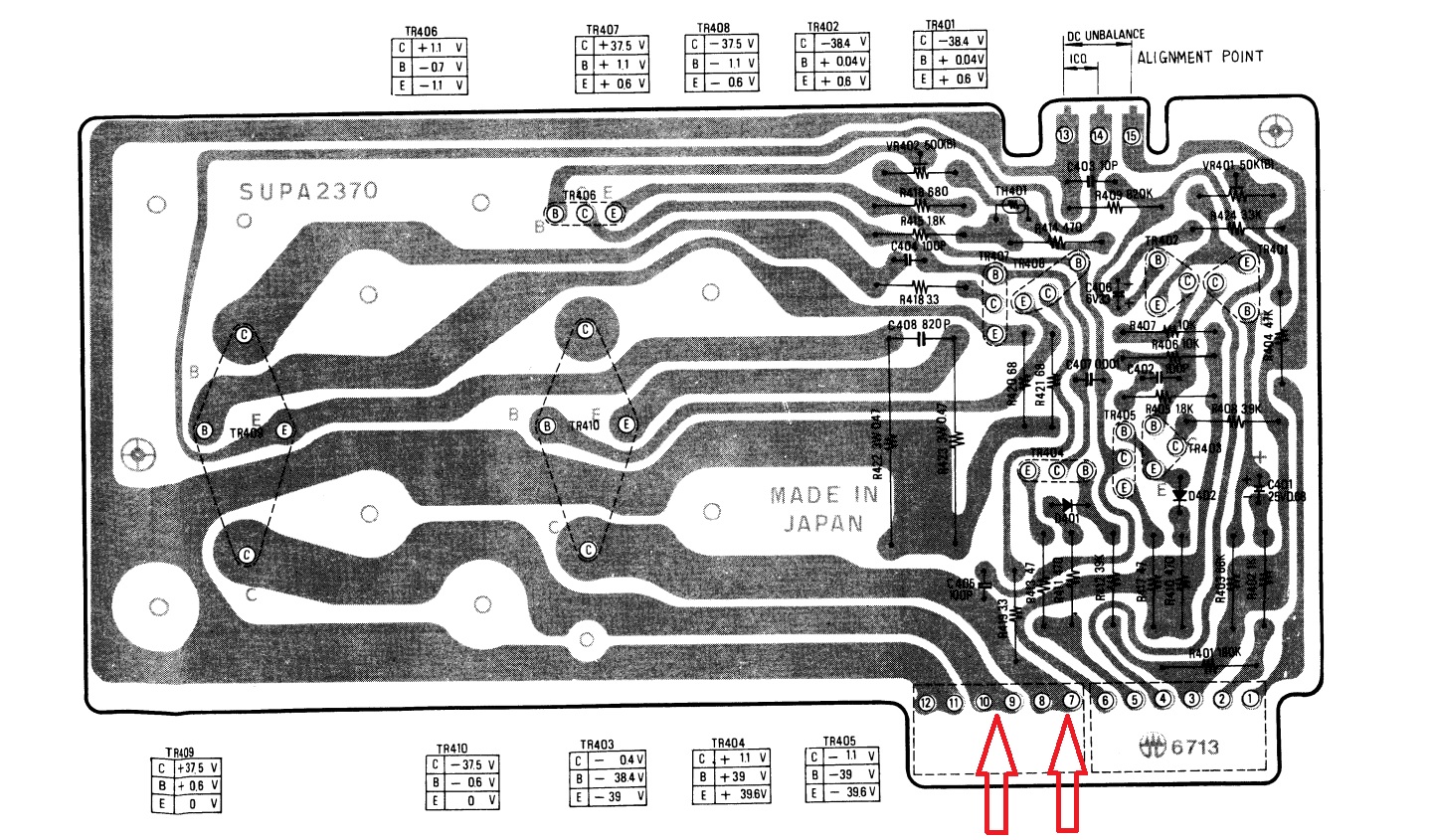

Regarding the power amp by reversing the polarity means that 10-9 8-7 have been reversed inside the power amp board .
This traces are connected to the main power transistors TR409 +37V TR410 -37V that was reversed when I reversed polarity .
On google D511 appears to be a 600v 1A diode but watching the specs of RVD10D1 I'm not so sure with what to replace . I can't find the original. What should I use instead ?. I uploaded the original specs of 10D1.If you follow the schematic (print that section of the page and use a highlighter) - start from the 28v transformer marked "ORG" at the top, just looking at the positive phase of the AC signal:

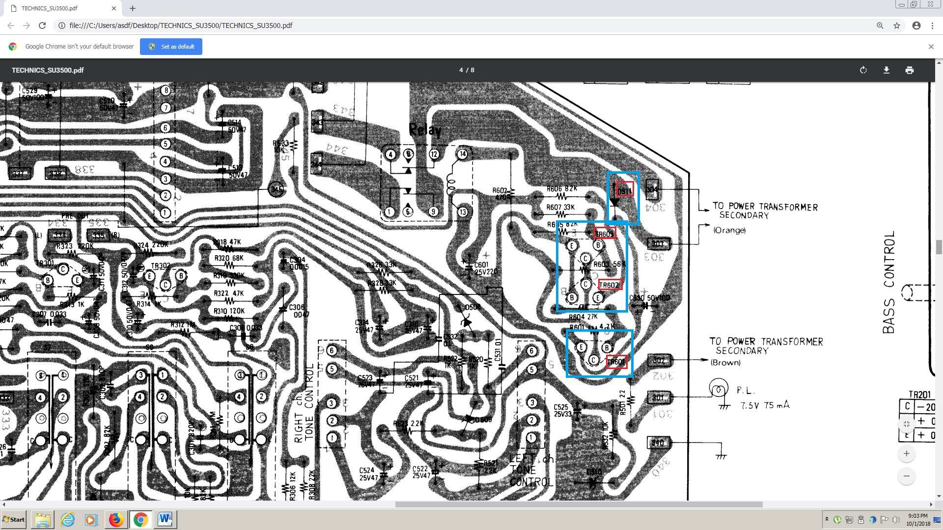

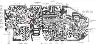

After replacing the main caps , the rectifier , the relay, I'm planing to replace
3 transistors and 3 diodes which a showed with red in this photo .
Is this enough if I replace all those components in order to restore the amp ?.
All caps are installed ok .
I just want to cure the reversed mistake by replacing all the suspected components .
I presume that resistors are ok and the only problem is with transistores and diodes .
Do you think more transistors or diodes need replacement .

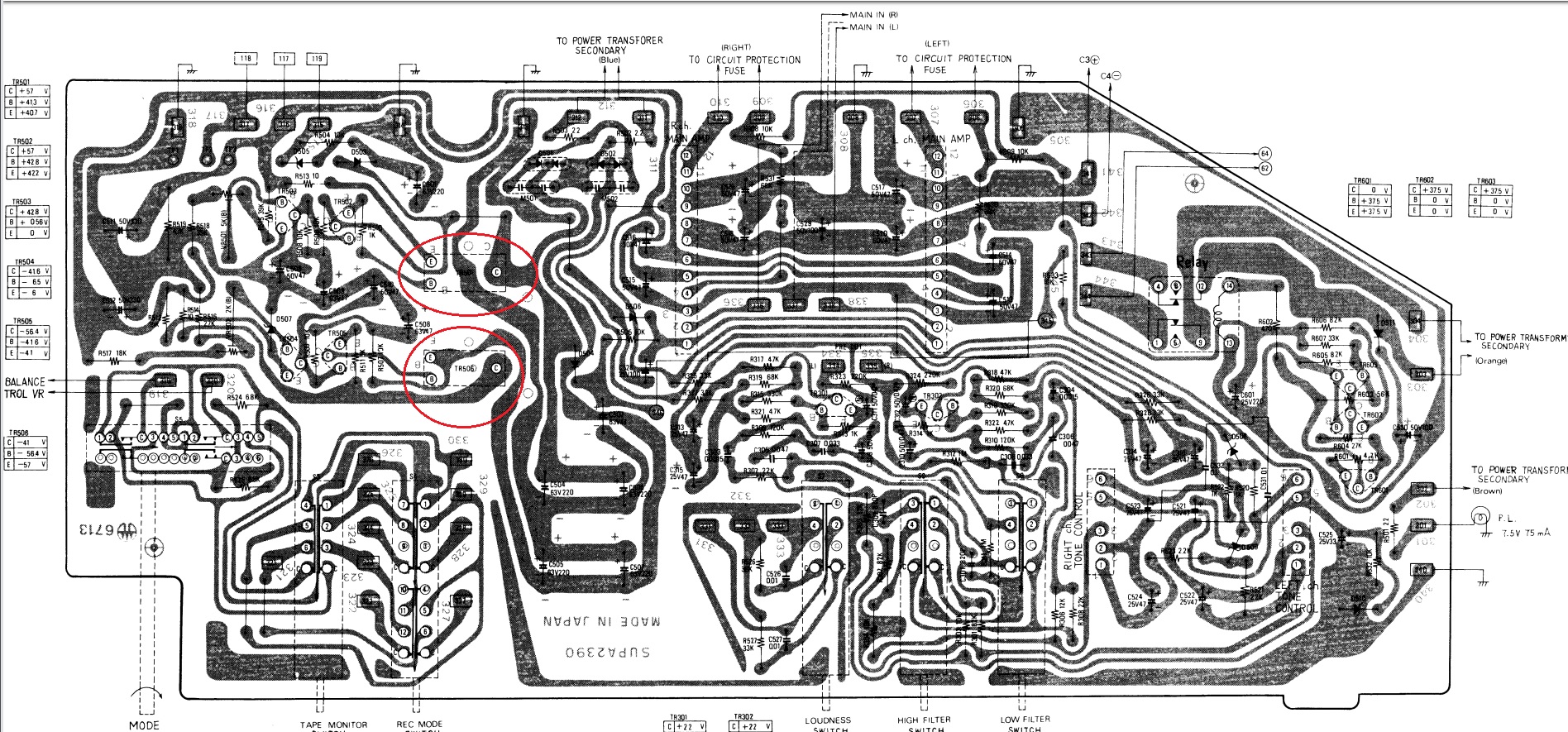

I started the mod and replaced all caps but I made a big mistake.
I installed the two main 10000uf filter caps backwards .
I installed the 342 amp negative blue wire to the positive side the cap and the 341 amp red positive wire to the negative side of the second cap.
I blew the 2A fuse .and more damage was done
How can I fix this ? What should I expect ?

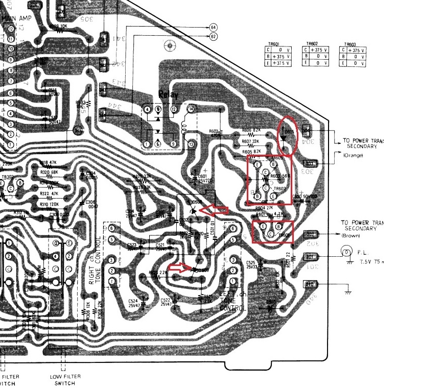

I replaced all 3 transistor and the diode around relay and the relay with a new one but still the relay is connecting with 0 delay and the amp is sending a shock to speakers .
So I replaced TR 601,602,603 and diode D511, I also uploaded a photo .
I don't understand why the relay is not fixed .

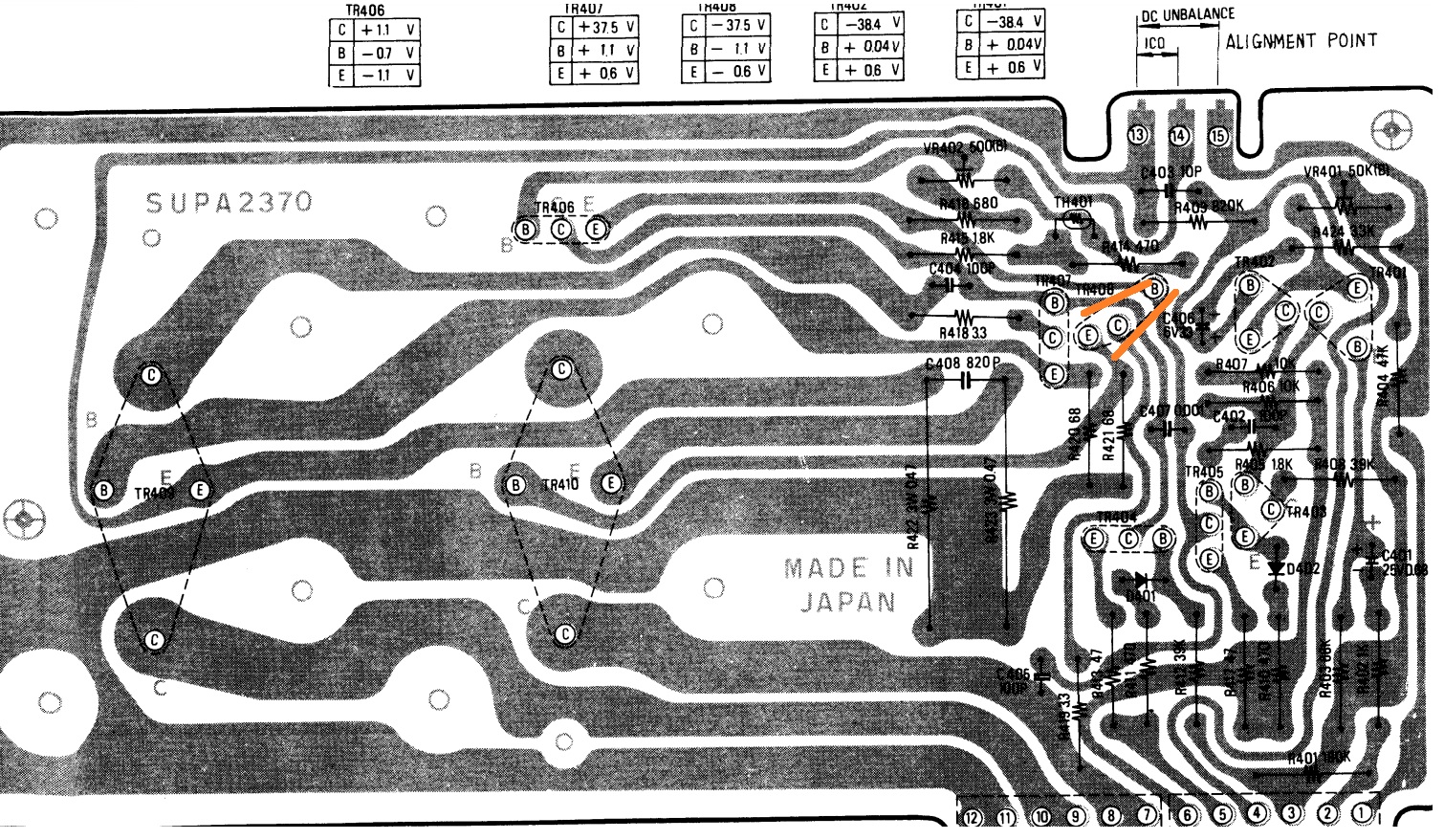

I tested all other transistors and the hFE is under 200 for all and there is no short also I tested all diodes and they are all good .
There is a strange problem with 2 high woltage transistors tr506 tr501 (showed on photo).
If I test those tr506 tr501out of circuit they are fine but once mounted in circuit there is a short between emiter and conductor but only in one direction (showing around 1600 on diode probe). If I reverse the multimeter probes there is no short on that E-C path.
Is this normal ?what is causing this ?.
Also I measured the transformer impedance right from the cable and it shows 9 ohms .
Now the amp is almost solved but still there are some bad parts that need to be replaced .
Should I also start testing some resistors and ceramic caps ???.
What other parts are susceptible of failure because of reverse voltage ??
