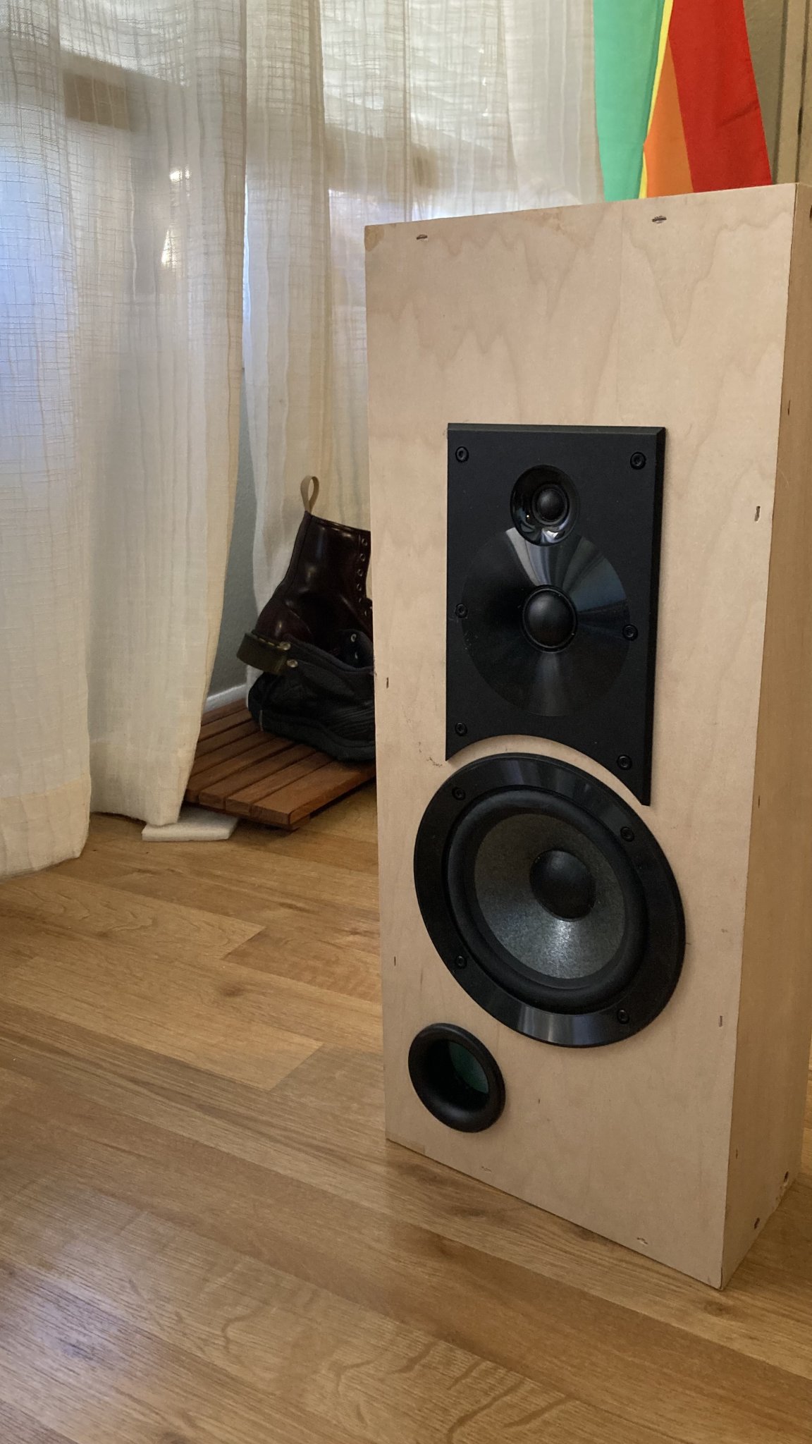

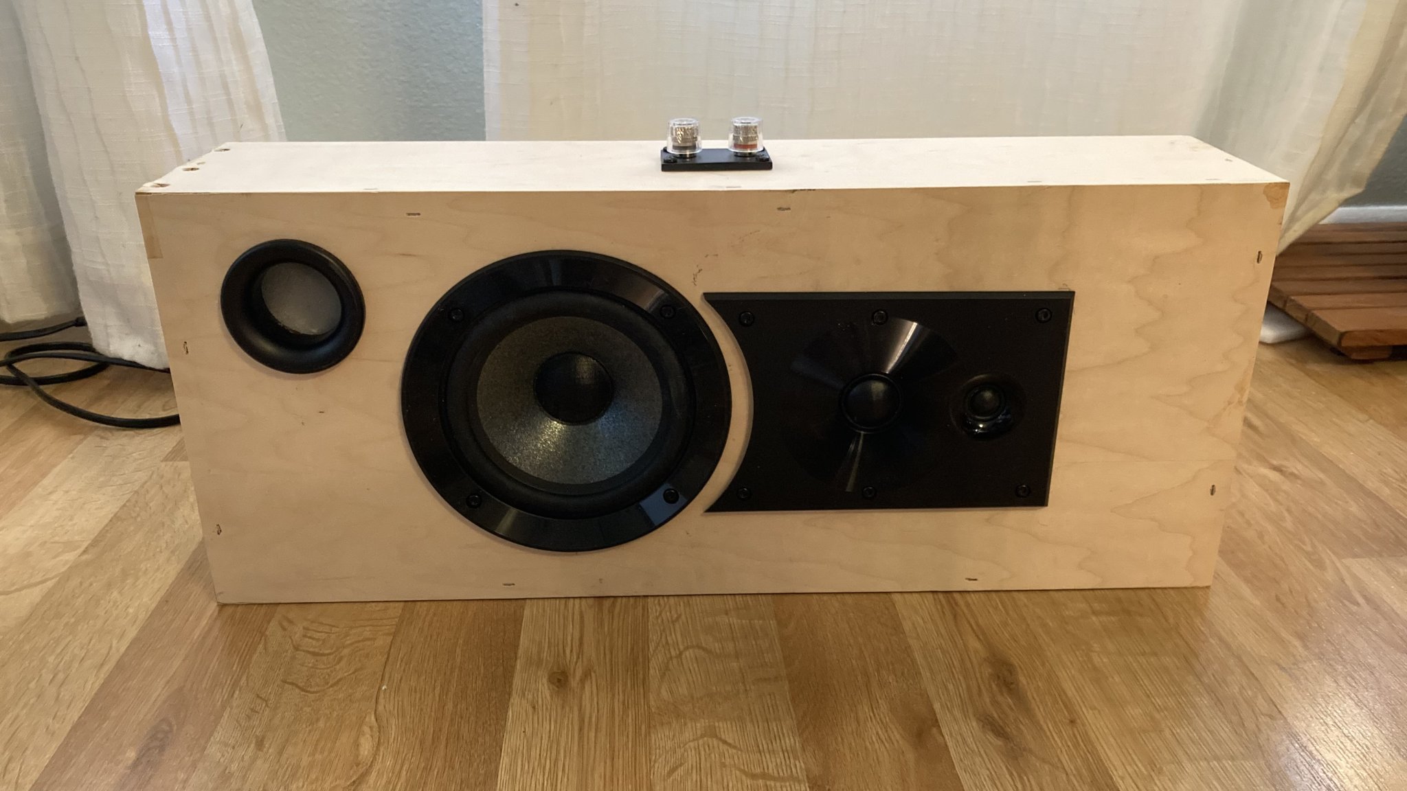

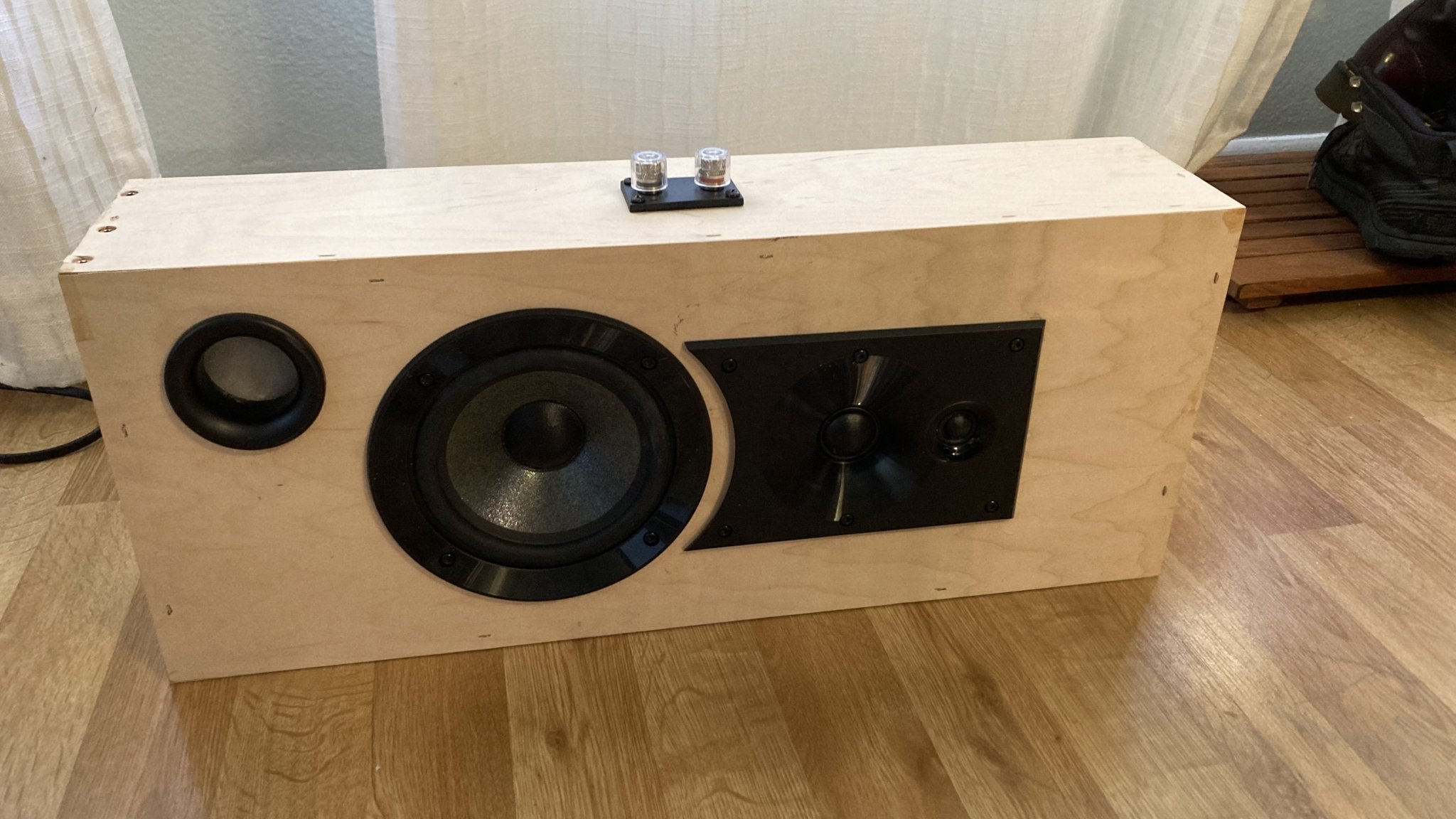

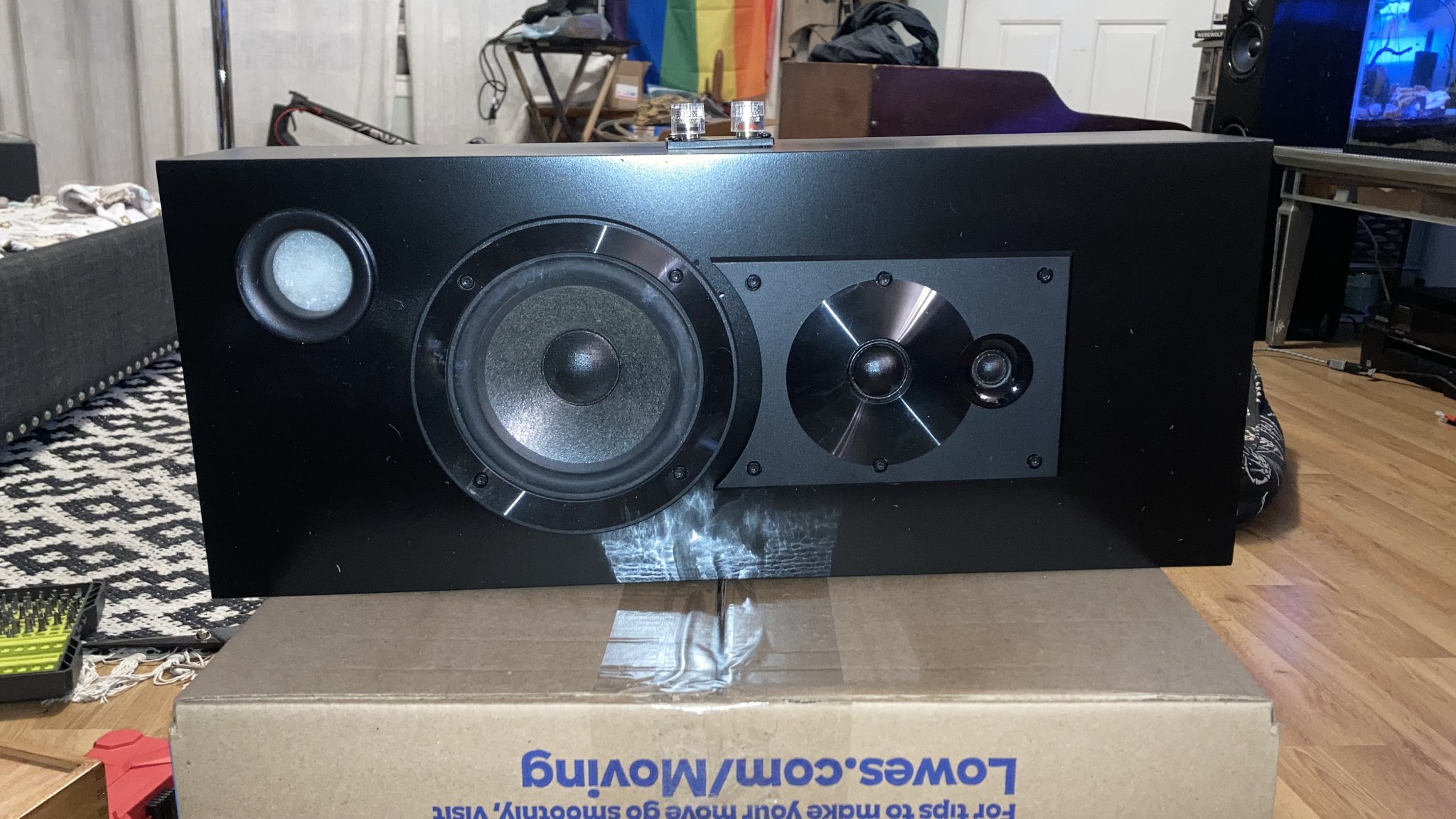

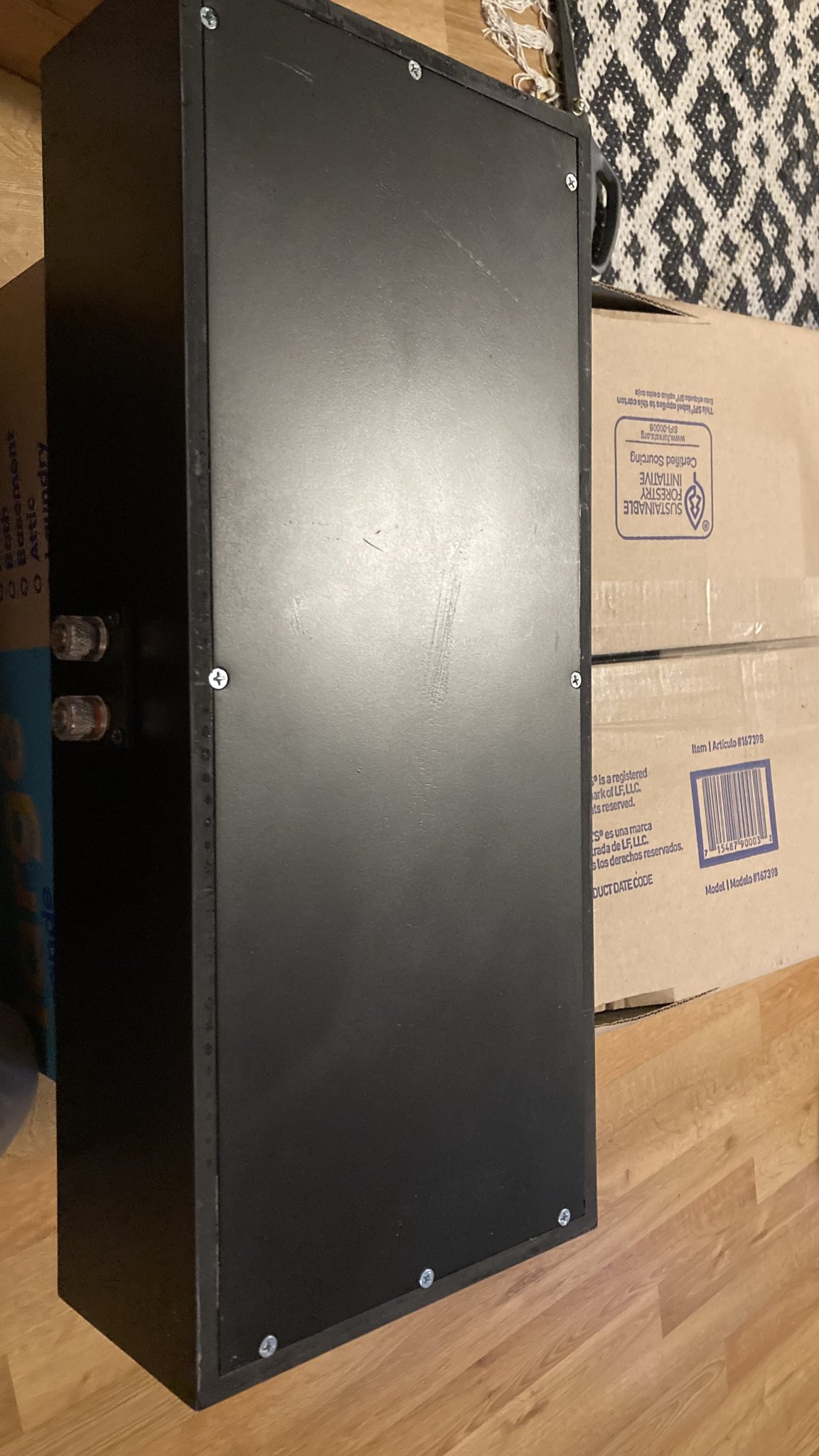

Alright, I apologize for not communicating well in my first post. I had finished the build and it seems very near to original. I think it sounds a bit better. Maybe because it’s more stiff than the 1/2” mdf plus I added a bit of stuffing. I also reduced the internal volume to about 400 in^3. The new dimensions are 20.5” x 8.5” x 4.5” with 3/4” maple plywood (the good domestic plywood from Columbia).

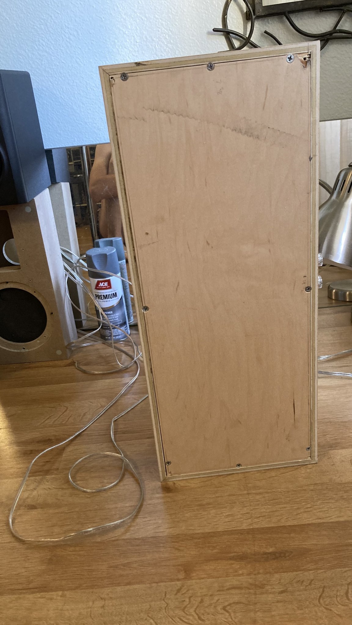

I need to paint and fill it, but it’s basically ready to use. The back can be removed for easier access and it has a foam seal plus threaded inserts so that it doesn’t just strip the screw holes. I’m going to keep the plastic end caps of the port and maybe try to find a good length, but it doesn’t sound like it really needs the adjustment. I messed up on squaring the joints on the angled parts when gluing it so the back needed some adjustment to fit, but it worked out fine. Thank you all for the suggestions and politeness. A lot of places aren’t very receptive to these kind of small budget Frankenstein builds. I might even rebuild it at some point and use more for the advice given. I would also make it easier to build and keep square.

actually looks like more airspace than factory.
should be ok
box looks well stuffed for good mids.
seems likely the port is too short.
for the box size
So it is high tuned.
you could plug the port
or just add length to turn lower.
reverse engineer factory box volume
and port length to find tune frequency.
then add length to your port
to get same frequency with the larger box you
made.

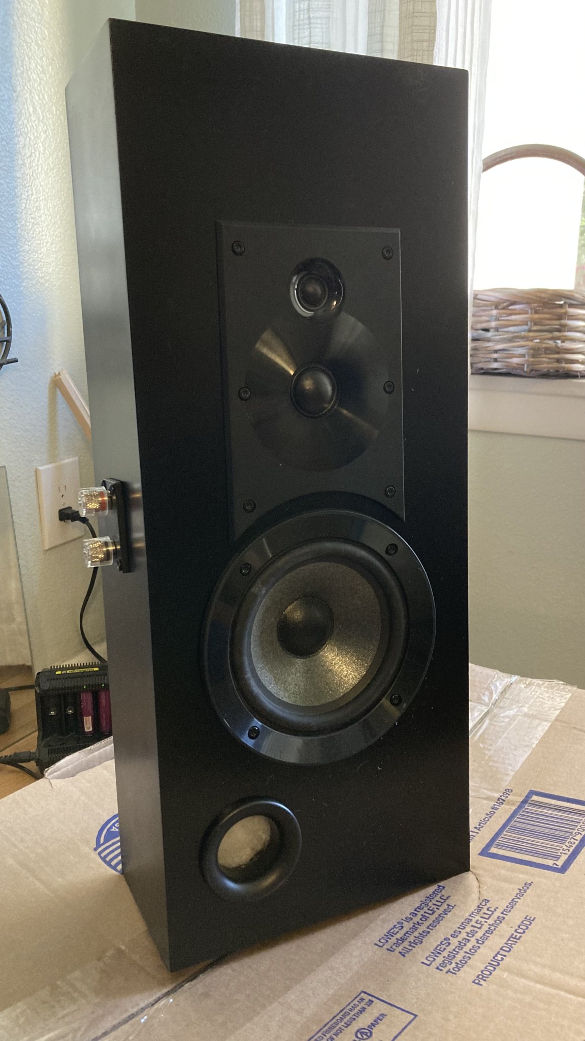

tl;dr: speaker is done, deciding horizontal or vertical mounting, the long and arduous journey of painting something black, then applying polyurethane clear coat. Pictures.
Thank you for summing that up! I do have a little update on the speaker. I finished the build and now am deciding how to mount it. It’s going to be above the TV, but I’m still trying to decide whether I’ll stick with horizontal mounting or vertical. I’ll need to reread previous comments to see if someone had answered that.
In regards to the finishing, it took me a bit longer than it should have since I used a flat black, I was spraying outside (using a box to cover during drying), and some mistakes in the wet sanding process. Any sort of rub on the paint would make it glossy so after repainting (this coming out even smoother) I asked the finisher at work what would be a good clear coat for a flat black paint. He said that I should try polyurethane or water based clear coat since the regular clear coat we have is glossy. I was only able to find a satin polyurethane so it’s a little more shiny than flat, but it still looks great. Easy to spray on with good wet sanding prepping. It definitely has a self leveling property that really helped when I tried to get a stray hair out in the middle of spraying!
I hope it still has the same decent sound up high as it did during testing. Attached are a few pictures of it. Take note of the input position. Originally I was set on having it against a wall near flat, horizontally mounted. At some point I might add a secondary input on the rear or short side.

I may also need to play with the port length as someone else said.
You said earlier that you have simply kept the flared plastic end cap of the port and have not included the port tube itself.
The problem with introducing a port tube in your narrow enclosure is that there should be at least a couple of inches of clearance between the rear of the tube and the inside rear wall of the enclosure in order to allow the plug of air in the port tube to oscillate freely.
Looking at the amount of stuffing you have used, any interaction between the woofer and the plug of air in the port has probably been suppressed, making the enclosure behave more like sealed or aperiodic (resistive vent) one.
I would be tempted to leave well enough alone, especially since you say the enclosure sounds better than the original.
