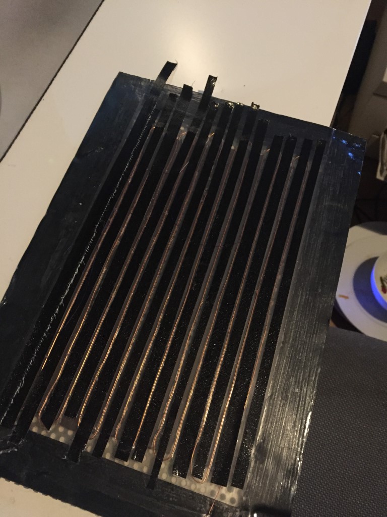

A bass panel with wires attached like magnepan, magnet width 8.5mm 13 magnets used in total
Picture one:
RED: Plain panel nothing hapened here, it has just wires and a some glue on the mylar to hold the wires.
BLUE:i added strips of gaffer tape to 8 out of the 13 magnets in between the wires really messy just a proof of concept. 62% coverage.
PURPLE: 100% coverage.
Picture 2 is the contraption

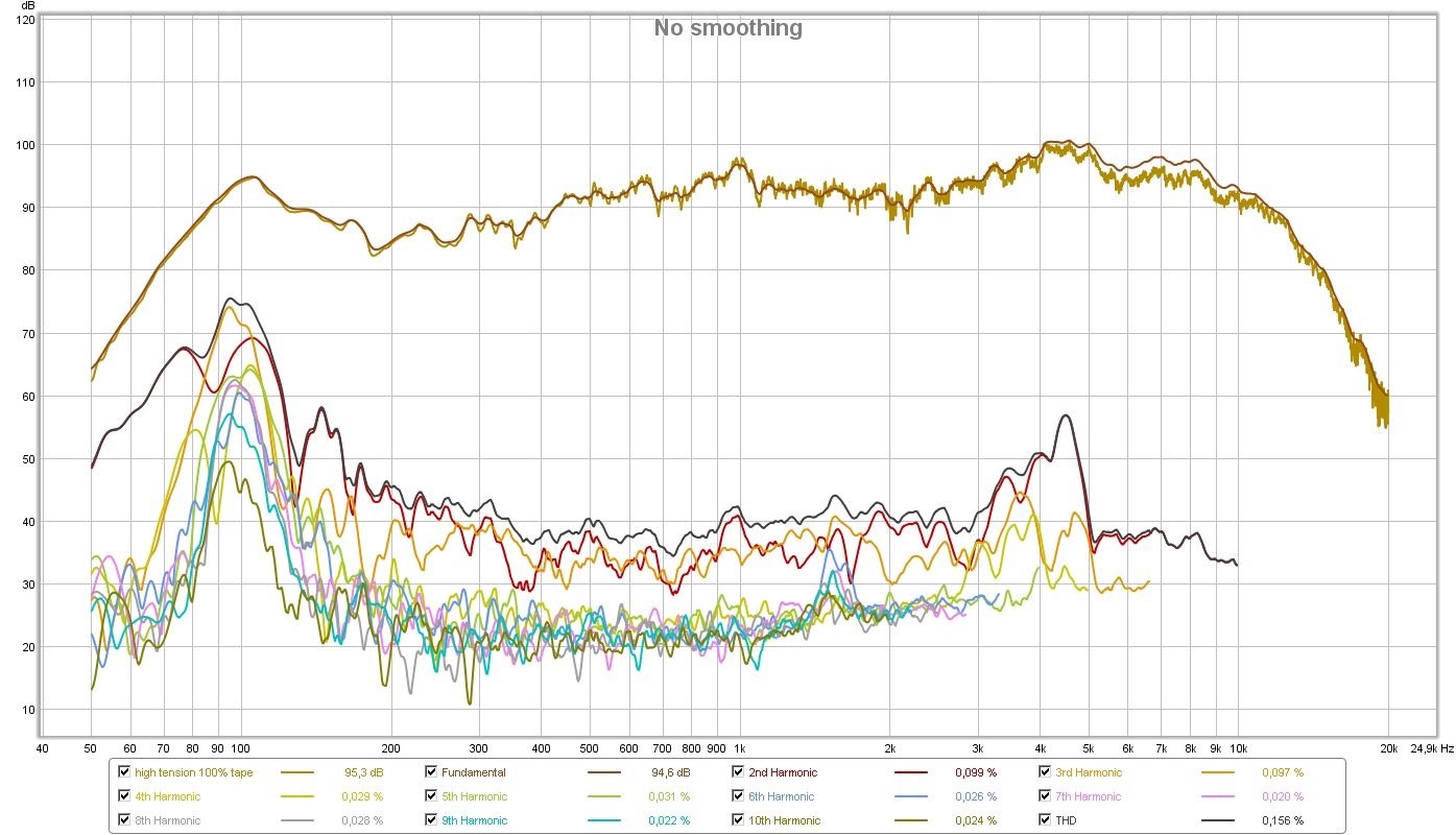

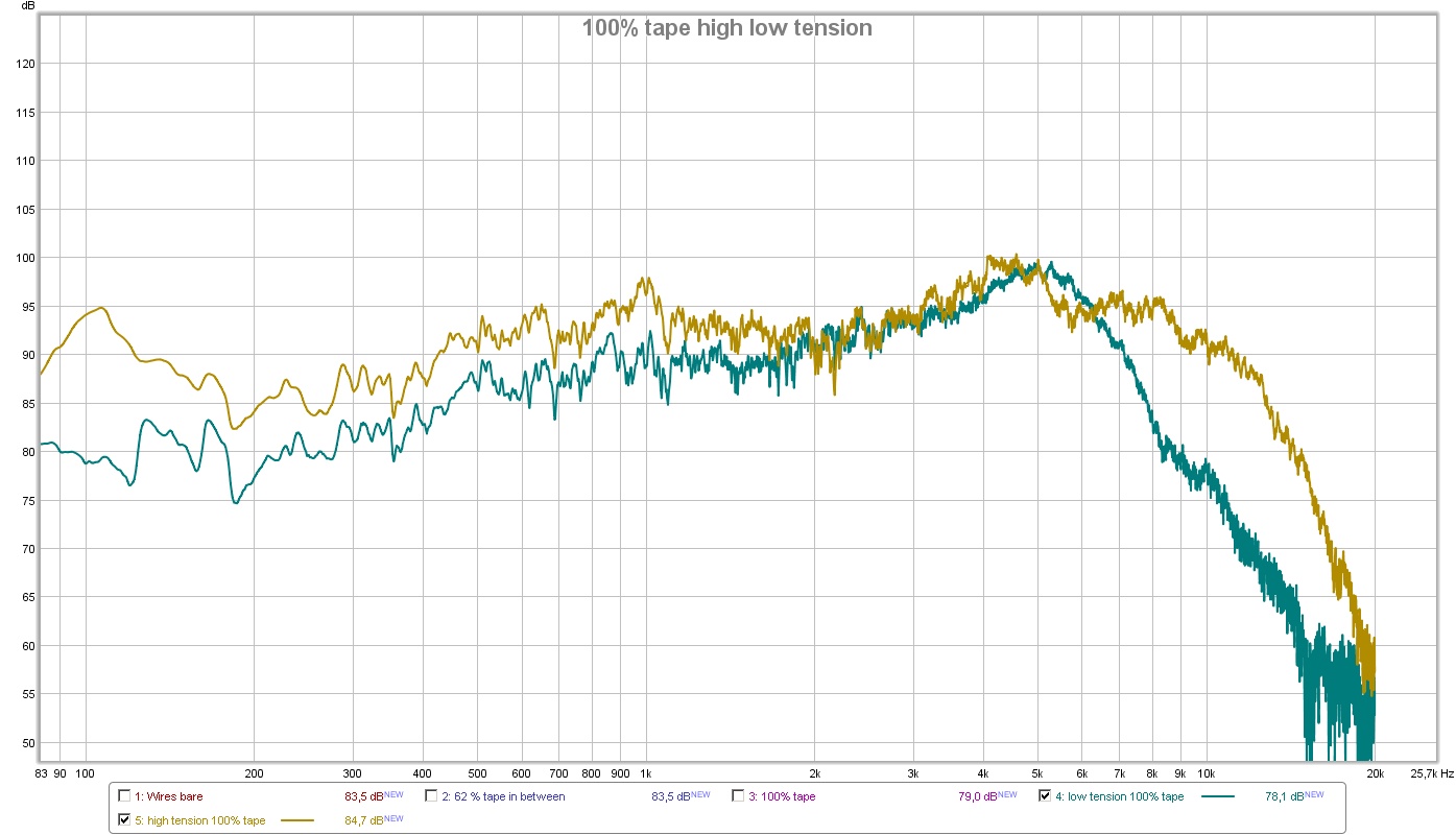

Picture 3 measurement of 100% coverage what does the tension do to the freq respionse?
Blue: neutral state
brown: bended state so i stretched the menbrame more then it is now.
That are some cool results if you ask me. still not sure if the same goes for the mid/high drivers but i can guess it does something to say the least.
what else it does is lever out the bass to High frequency response and as well damp allot of crap in the distortion department picture 4 before any of these tests, picture 5 after tensioning and adding the tape. looks smoother,
One thing funny i just noticed , by adding tape i lost around 5 dB, but when stretching i gained 5 db again. so net not much lost :)

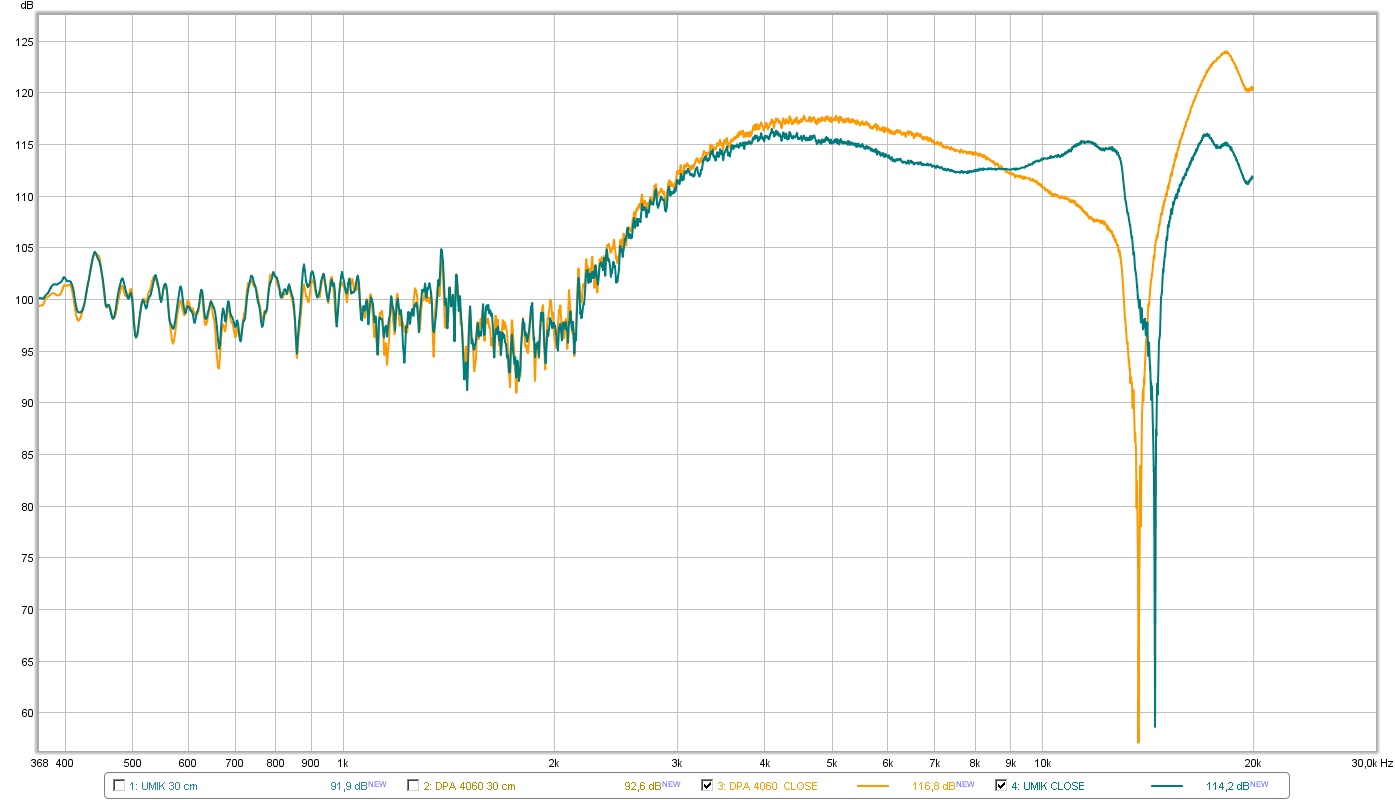

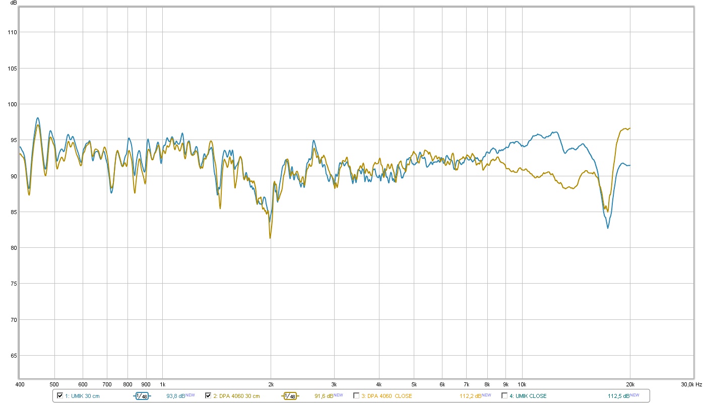

Here are some tests with the UMIK microphone from minidsp and a DPA 4061 omnidirectional mic. i used my digidesign mbox 2 soundcard as output for both tests and as input for the mic. i did run a loop and, it is as flat as a pancake so the problem is not there.
I must say i run this test on my main computer somehow my laptop wont allow the UMIK and the DIGIdesign soundcard at the same time. i will get a jack to jack tomorrow to see if the soundcard of the laptop itself in question is flat to.
Pic 1 is 30 cm away from a pair of genelec 1019 at tweeter height
Pic 2 very close like 1 cm or something at the tweeter.
i used the calibration file for the measurements with the umik of course !!!
One thing the Huge DIP at 14kHz i have no clue about, it could be anything the genelecs waveguide or something no clue. good thing they both have it so must be there for some reason :)
what i see is this , the UMik has a big fat peak at around 14 khz and then is almost 10 dB down to the DPA at 18Khz.
OOOOOH an yes i named the measurement 4060 ;) but it is the low sens 4061 mic.

yes as Bolserst has pointed out the issue up around 15K is likley your measurment system.

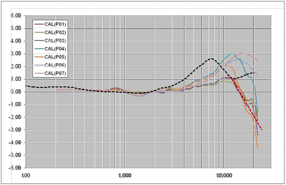

.. the mic, i got a UMIK with calibration file, and also got a home made uncalibrated panasonic based capsule. wich i think might be the same as in the umik. if i swapp them out they are almost the same. i do use the calibration file here it is as attachment.
I posted calibration data for a group of 7 panasonic mic capsules a few years back.
http://www.diyaudio.com/forums/plan...request-amt-heil-diaphragm-4.html#post2586319
I took your data and overlayed it with my data in dashed black line.
You can see that above the peak in the response, all my Panasonic capsules roll off sharply. The calibration data you received has the response flatten above the peak. I could be wrong, but I would guess that the true mic calibration data should follow something like the red dashed line I added above 10kHz.

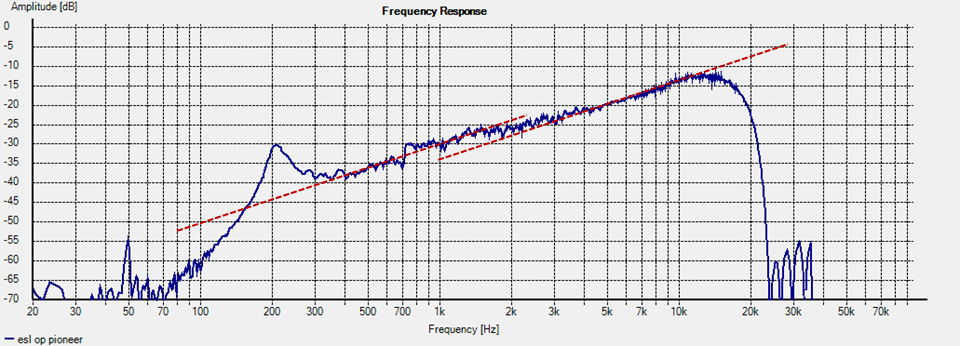

And here a clean measurement of a simple esl i used 2 different amps both match 100% if i change out to external soundcard or change laptop results are exactly the same.
That is a fine measurement there, showing well the natural +6dB/slope of an unequalized ESL. Getting the same data from different sound cards helps answer the question of whether your soundcard and/or driver file are part of the roll-off problem. Looks like they are not :)

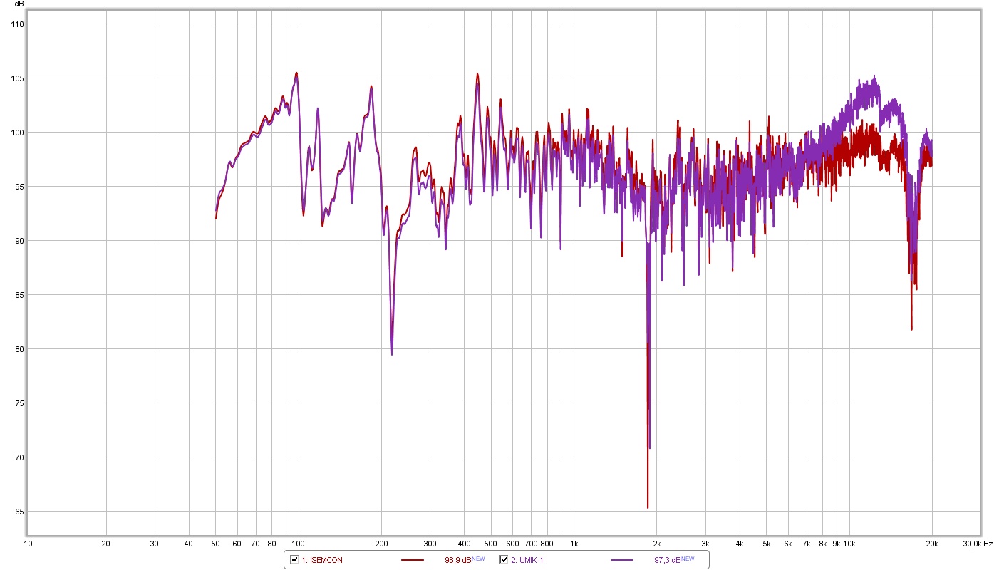

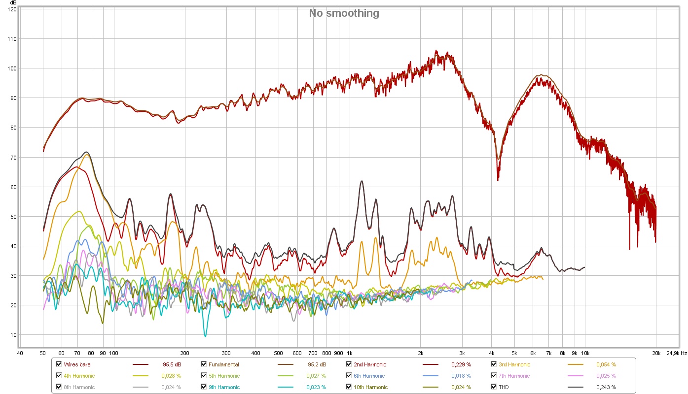

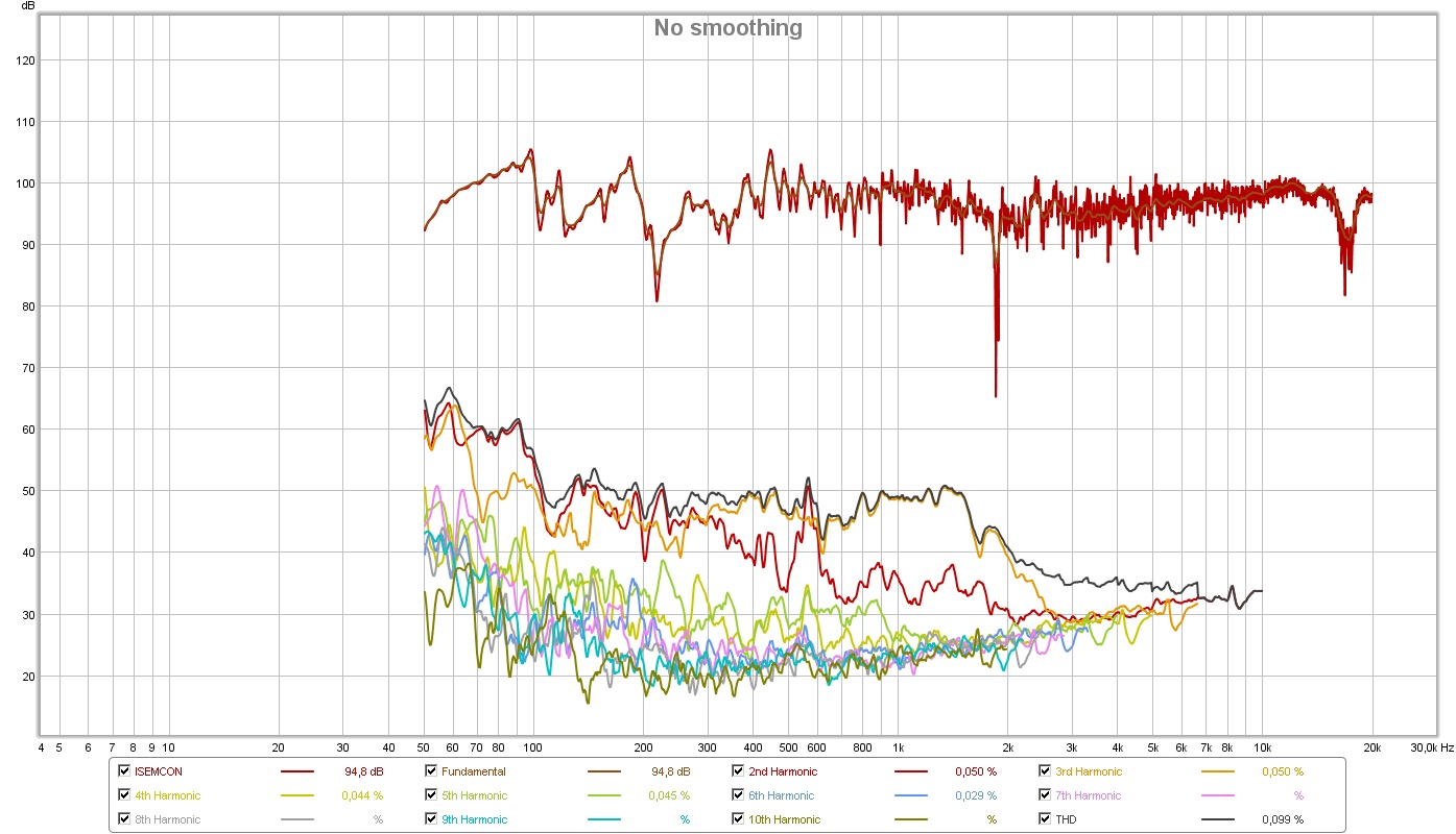

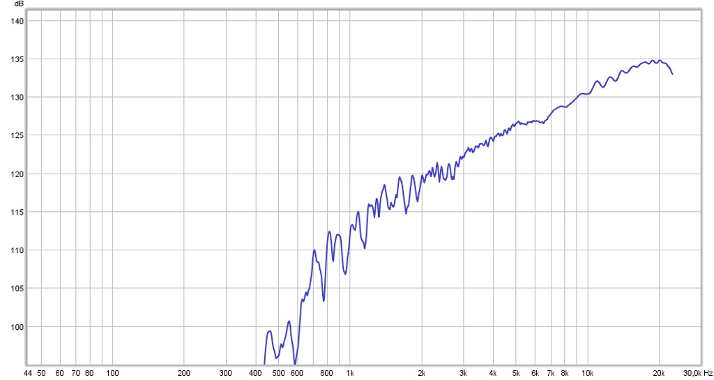

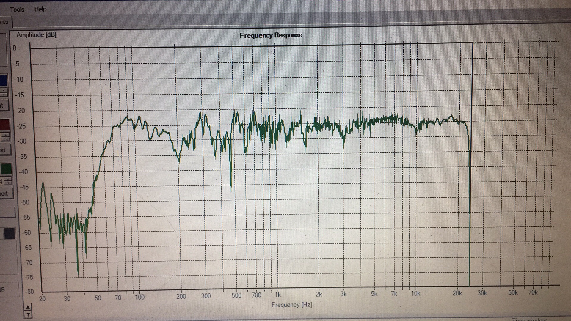

GOt the the new mic here a comparison
UMIK-1 vs Isemcon emx7150 both with cail file.
Pic 1 ferquency curve of a genelec 1019A at 30 cm
Pic 2 Distortion Umik-1
Pic 3 Distortion Isemcon emx7150
You can see the curve changed quit a bit smoother, which helps in terms of the 15Khz roll of i had. since with the umik it goes HIGH before it drops.
so you should level 15 Khz with the 15 Khz of the Isemcon emx7150, then the UMIK-1 would drop harder at 15 khz ... but another nice thing is if you look at distortion.
the Isemcon emx7150 is much more sensitive.

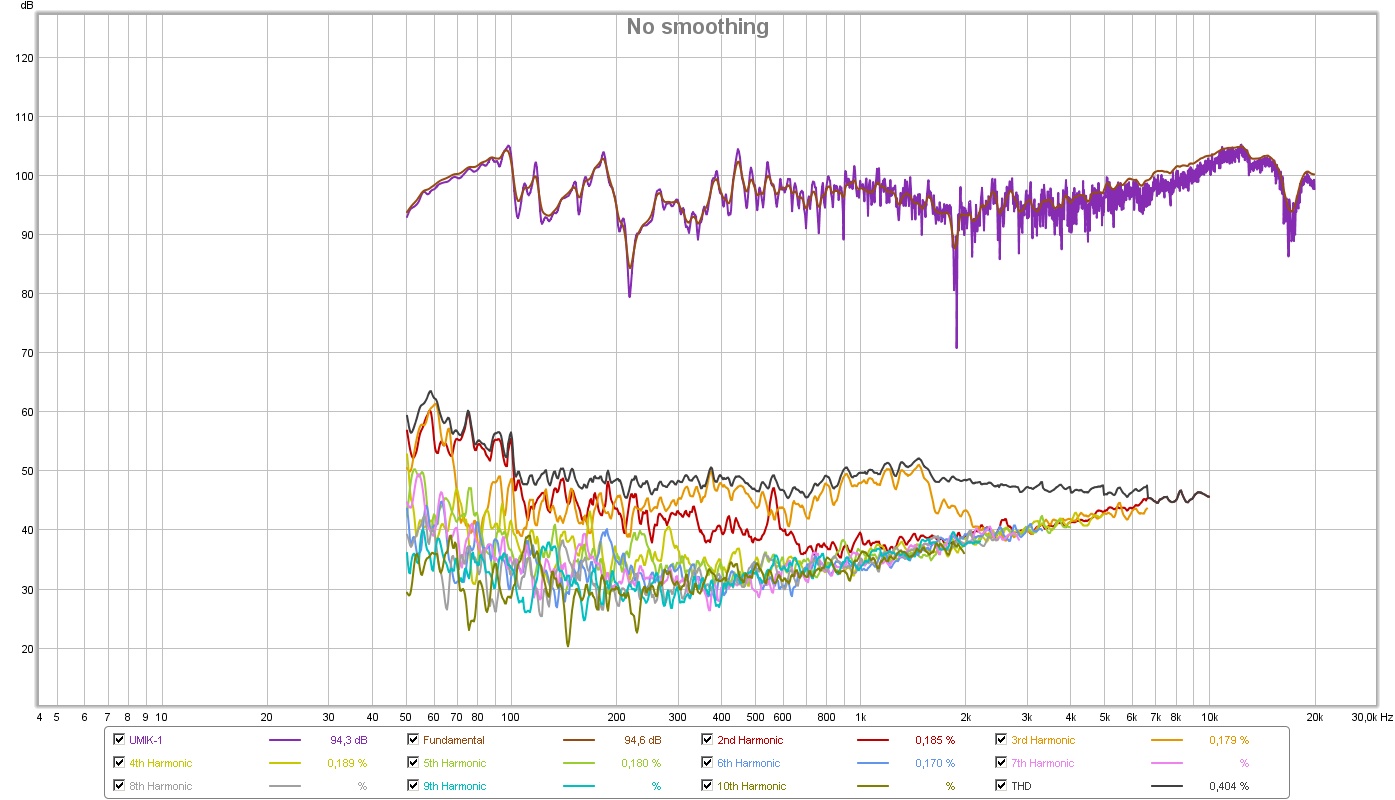

You can see clearly where the bass unit stops and the tweeter takes over in the same measurement, at around 2.1 Khz distortion from 0.099% skyrockets to 0.46% and so on. you can see the total noise floor increase, according to how much each unit is contributing to the total amount of output.
Distortion difference at 2.95khz
Isemcon emx7150 @ 2.95 Khz is 0.099% THD
uMIK-1 @ 2.95Khz 0.404% THD
I am looking forward to measuring the planars tomorrow. it might be nice it might be not but at least it is more honest i believe and i have more resolution.
the mic itself only differs around 1.66 dB at 10 hz . the rest from 20Hz - 20Khz differs max 0.8 dB. without calibration !
SAo im am impressed . there are also off mic calibration files and a file with measuring conditions like temperature etc , as well as ow much it differs at certain temperature differences .... way to much for me use but good it is there !

Here i measured the same ESL panel, (be it from a little further away.) with the new mic. looks slightly better.
Pic one old mic
Pic Two new mic
the 6dB per octave low roll of from 20khz and down is nicely visible. i did notice it is not exact 6 db more like 5. which cant be just fixes by a 6dB filter , i will end up short of high frequencies at 14 khz.
That looks a LOT better. -2.5dB down @ 20kHz vs -15dB.
If you look carefully, you will see that the slope is always 6dB, but there is a shift in the midrange due to the baffle effect of the spacer around the perimeter of the diaphragm. If you make your spacer wider or add an additional ring around it, you will notice the amplitude of the shift increase. If you somehow built an ESL with spacer width of only 1mm, there would be almost no shift noticeable. The frequency at which the shift occurs depends on the size of the panel; bigger panels have the shift at lower frequencies. The shift frequency also moves some when you start measuring very close to the panel.
When equalizing you use a 6dB slop filter + a very minor shelving filter to correct the shift.
