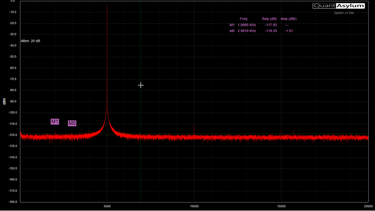

Now I am going to use a dirty word here, please cover your ears. Have you taken any measurements of what you have built?
You brought up a very good point about hearing test Mark. One day I discovered that suddenly the sound of my system changed was wondering what the hell what happened & then I notice something wasn't sounding right on the right channel thought was the speakers till I turn my head. Discovered that my right ear has lower sensitivity. LOL
I can only hear to about 10k on my right & 14k on my left. Getting old & wonder if I should give up building & tweaking audio stuff. Sigh
Cheers
I was 14 the first time I tried this, as "expected" my limit was close to 21 kHz. What was also interesting was that at high frequencies, I couldn't hear the difference between sin and square wave. When you realise that a square wave is a sin wave with a lot of distortion and that your golden ears don't work so well.
Yeah 1k distortion
5k distortion
I'm using the QA401.
The harmonics shown are present when the analyzer shorted to itself so they are inherent to the analyzer. I need a notch filter to see what the distortion actually is. I use Victor's oscillators and Cordell's distortion magnifier combined with the QA401 for analog measurements but that's not helpful here. The distortion of the I/V stage itself is lower than you would believe if I told you so I'm expecting the sources of distortion to be layout related if anything. I find the system as it is to be mind shatteringly good and a source of endless amazement so I'm pretty satisfied I could go the rest of my life and not get bored of this sound. I'm just trying to see if there is anything I missed that could be improved upon.
