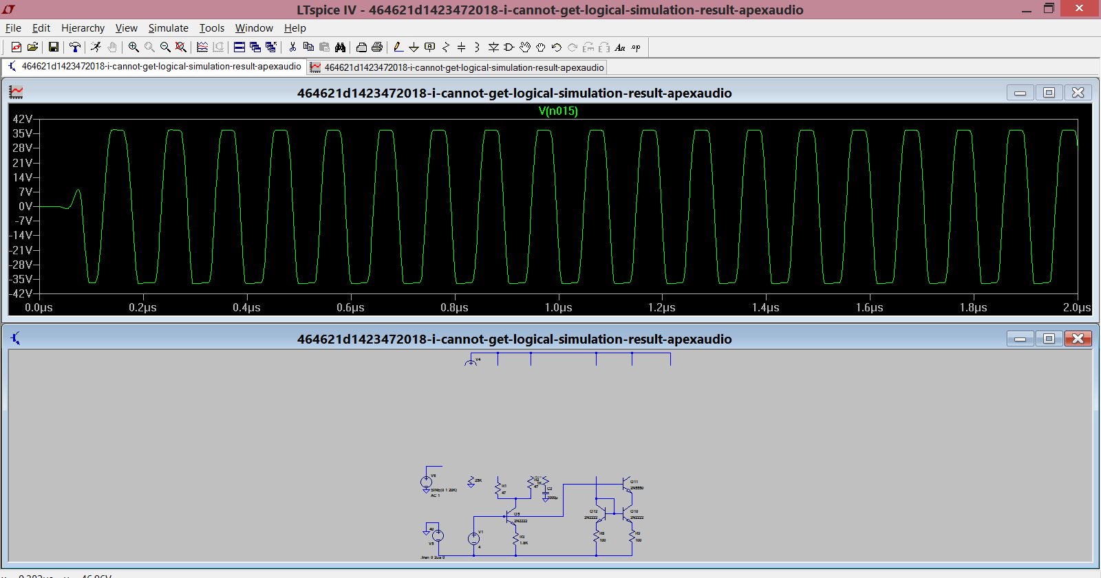

I cannot get a logical simulation result on this
This is a simulation of IPS and VAS circuit similar to Apexaudio SR200. I cannot get reasonable result. It is strange. Attached is the file, I cannot see what I did wrong.
I did a few other circuits and never ran into problem. I even uninstalled and reinstalled the LTSpice to make sure nothing wrong with the program. Please help.

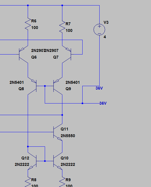

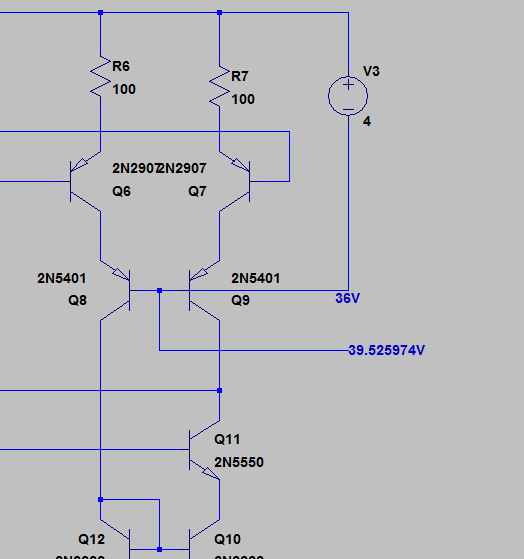

So this is what you had and what it should have been. Not obvious at all to look at the diagram but the voltage checks showed the problem in seconds.

And also, it (the connection between Q8 and Q9) doesn't have that little square dot that tells you "three things are connected together here" as it does in between (for a very similar example) Q3 and Q4.
In addition to measuring the voltages, if you use the Drag tool to move Q8 and Q9 around, the mistake will become obvious.
I like the base connections at (for examples) Q1 and Q2 much better than those others and Q5 (where a wire connecting the base goes through the transistor). I'd been doing these things perhaps semi-unconsciously in LTspice (and other but nicer schematic capture interfaces), but this certainly points out why. If you connect three things, make one at 90 degrees to the other two, and make sure there's a square dot where all three meet.
Sometimes (ahem...) things don't have a great "user interface," and it's up to the poor user to develop defensive rules to make up for it and help avoid Gotcha's like this.

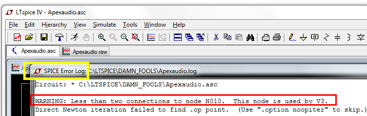

It almost sounds like the participants in this thread are unaware of the LTSPICE error log ??
After running a simulation you can click View -> SPICE Error Log (or, you can simply type the keyboard shortcut Ctrl+L). In this case it tells you exactly where the problem is.
