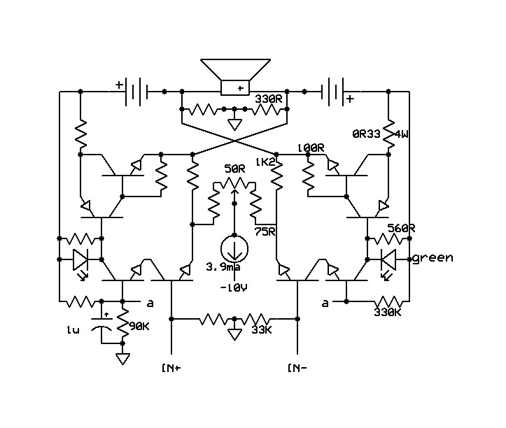

The amplifier disclosed here is actually a Circlotron, implemented with bipolar transistors. I call it Infinitron because I found it easier to visualize Circlotron topology not as a circle, but more like a figure 8, or even better, the symbol for INFINITY (see Logo attachment). This same visualization follows to the schematic, and to a certain extent, the PC card.
If one sees a schematic resemblance to Jean Hiraga's 'le monstre', it is not a coincidence. My original plan was to bridge a pair o'monsters' to realize a balanced amp. This 'monster pair' idea eventually morphed into Infinitron.

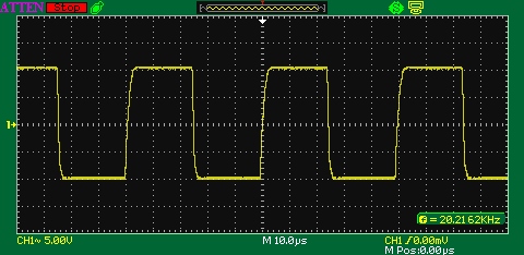

Infinitron is running class A, with about 1 Amp Iq. Power out is a nominal 20W. Output BJTs are KSA1220Y/2SC5200. The input is a MAT02 with BC550 cascodes, but matched BC550s would work as well for the inputs.
I'm quite pleased with the performance and stability of this amp. I have been using it with a Cambridge Audio DacMagic+ for over a year now, with no issues at all.

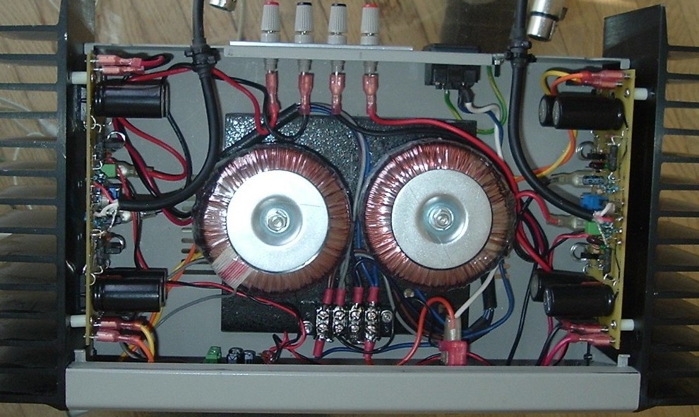

Attachments are; Infinitron logo, schematic, 20kHz square wave trace, completed 2ch amp in a gutted pro-amp enclosure.

Hi Polyphase !
Thanks for sharing that nice SS Circlotron A class amp design ! :up:
And few question :
- that circle with arrow inside represent some CCS unit ?
- it is possible to run that amp in SE mode ?, but not only in balanced mode , with let`s say IN (-) connected to ground .
Polyphaze thanks for your answer !
All is clear now !
With that CCS in tail of input cascoded LTP SE mode is quit possible , ( but as always balanced drive mode is preferable option over SE mode for this type of basically fully balanced amp .) , and yes I like that global balanced negative current feedback design solution .

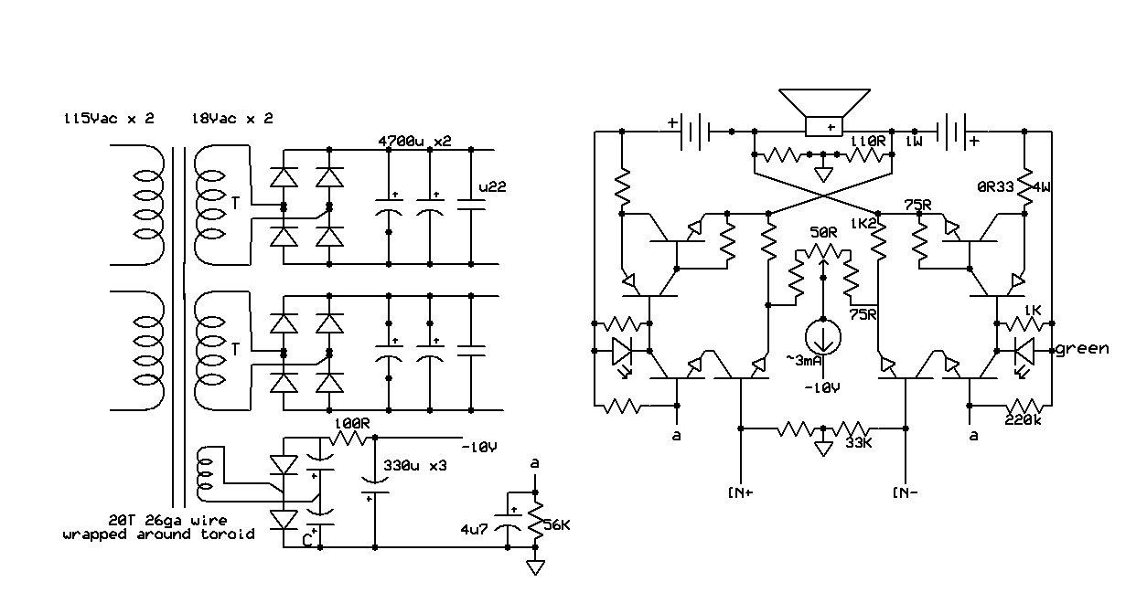

For me, better to listen. As for Iq, (which should be ~1A for this design) it is a function of Iccs, and other components including these resistors on the output.
I don't see how increasing the value of these output resistors in my design (from the original 110R) could increase distortion as long as amp is in class A mode, but maybe I'm missing something. I do know from listening that distortion is quite low, and that the 'tweaks' shown in attached schematic have improved the listening experience.
