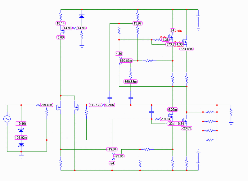

Hello Pass fans,
I somehow burned my Aleph 3 clone few days ago.
Now the right channel outputs +24VDC.
I changed the 3 IRF9610 and 2 MPSA18.
I checked the IRFP244s. Seems to be good.
But still no help.
The voltage across R106 and R108 is now only 1V.
The voltage at the D-leg of Q103 is 3V.
The voltage at the G-leg of Q102 is 9V.
The voltage across Q105 is 3.5V
The voltage across Z103 is 4V
Could anyone help please?
Thanks!
Jesse

Back again with some voltage measurements (with respect to the ground):
G/D/S
Q101 0/-24/-15 Q102 -15/-24/-15 Q103 +24/-15/+24
C/B/E
Q104 -24/-24/-24 Q105 -18/-24/-24
G/D/S
Q106 +22/-24/+20 Q107 -23/+24/-19
Q108 -24/-24/-24 Q109 -24/-24/-24

These are values from the sim; just to give you an idea.
/Hugo

Doesn't sound as though the front end current source is working. Without it driving the differential, you're guaranteed that nothing else will work, as there'll be too little voltage drop across R108 and the outputs won't bias, and if they're not working, then...
Assuming that the rails are at full voltage, then Q103's Gate should show the nominal voltage (9V below the positive rail, or about +16V measured from ground assuming that the rail is 25V). Z103 and R105 are a tidy little subunit, and should work regardless of what else is going on. If they aren't then you have a problem in that area.
Possibilities:
--R105 is toast
--Z103 is toast
--Bad solder joints or traces (Just for the heck of it, I vote for a cold solder joint. Use a solder sucker or solder wick and clean the joints, then reflow with fresh solder.)
--Q103 is toast (if it somehow managed to short G/S, then it could be bogging down the Zener voltage)
--R107 might be bad, but somehow that doesn't seem likely
What to do? You might try removing R107 and tie Q103's Gate to the +rail, just to keep it from wandering off and getting lost. See if the R105/Z103 pair pops up to the right voltage. It doesn't sound as though the rest of the amp is coming up anyway, so it's not likely to do any harm to the rest of the circuit. If the reference doesn't work, start prodding around those two parts. If it does work, then test Q103 out of circuit and make sure it works. Until the Gate on Q103 swings down from the rail, you know the current source isn't going to work, and until it turns on the rest of the amp won't go anywhere.

actually the voltages from the middle line (output) down are all nearly -24V...

I followed your instruction and checked the Z103, which I changed a couple days ago. Without the connection to R107, Z103 fails to provide 9V, but 4V instead.After I changed to a new Zener, the voltage comes back to 9V. Then I knew that I have to forget all those parts I have changed, and start from beginning.
I connected the R107 back, then the voltage dropped to 4V. So I took off the Q103. Mesurements shows the G/S is short. Then I changed to a new IRF9610. So far, it happened exactly as Grey's post. Although I still get -24V output, but I knew I'm on the right track.
Then Q102 & Q109 were both found toast.
After changed Q102 & Q109, I powered on the Aleph and measured the output.....Wohoho...No +24V no -24V... I knew this little beast has come back..
