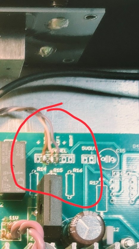

i'd still like to get a better look at the pot wiring (and sorry about the comment on your soldering, i get it after numerous tries (37?) even my work would suffer)
at this point try not to succumb to the temptation of doing a bunch of rebuilding/re configuring there's only so many times the lands on the PCB will take resoldering before foils start lifting.
let's go over what you have currently to see if we can't make this thing pass a signal.
so yes friendly1uk i think is making a valid point about the output relays. do you hear them click after the preamp powers up?
from the picks so far it does seem like you've successfully bypassed the original input selector.

Ah yes. I feel like this is onto something. It makes sense.The output relays, K1 and K2. On the main board, beside the output wires.
This unit looks like an old valve main board, but the input selector switch, looks like a newer circuit board. I can see at least one chip on it. It's not just a manual switch with power for an LED. We could do with a look at it, unless you are sure it's just a chip for switching.

So I'm feeling happy. I understand your advice about not mucking around blindly anymore but I hadn't actually tried to put the RCA - selection pcb back in, and wanted to test the mute circuit theory...so I tacked it back in and got sound! So I think that must be it. Feels good to think I'll be able to fix it.
My question now is, is it possible to defeat that mute? Without a schematic? The input selection has been janky for years (hard to actually select a specific one). I have a nice quality Elma gold plated selector as used in pass preamps and would prefer to go directly from RCA in to that...if it seems reasonably doable.
The RCA board connects to the main board in the pic below. I'm guessing without that connection it activated the mute?

that's where seeing the schematic would be best, and it would take having the unit in front of me to say for certain the best way to defeat/bypass the mute.
this is where i should bow out because it would require in depth work that, no offense ,may be above your current skill level, sorry.
