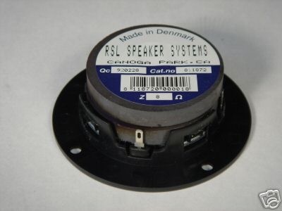

For the tweeters, they are the same as yours and I believe they are Vifa but could not find a current model that looks like this. Here are some pics. Looks like the coil is fused to the magnet because when I pulled it off it started to come unwound. Also, the outer metal shell looks like it was in contact with the outer dome screen, and you can see what appear to be abrasions on the outside surface of it. Is that oil that leaked out of the magnet?
I would guess that the coil will remove with some pressure applied. Looks to me more that the glue holding it together has melted. it probably is just knotted up inside the groove. It may come out
Cant really see abrasions on the tweeter in your picture, but yep that tweeter must have been moving some to damage it. The dome is pretty scratch resistant (I'm clumsy, I know this for sure)
No its not oil (well not really) thats reached out of the magnet, its ferrofluid. It normally sits in the groove, held there by the magnet (Its magnetic you see) You will probably have heard the term before, the stuff basicly acts as a coolant for the tweeters voice coil. Looks like your tweeter had a violent enough death that the fluid splashed out.

So I guess I need a source for the tweeters, but don't know the original model or its specs so if I have to substitute a more current model and make it fit physically I'd like to not have to mess with the crossover. I guess I'll contact Mission as I doubt I would be able to find tweeters that would just fit right in.

811877 will be a Mission only driver. As I recall the tweeters are
are sandwich, i.e. aluminium foiled fabric domes. Ideally you should
keep the ferrofluid, any differences in the tweeters can be adjusted
carefully with kitchen paper edging mopping up oil.
I'd go for the 811830 diaphragm, level may need adjusting in the c/o.
TBH the main voicing of a speaker does not depend on the tweeter.
I think you will be fine with new diaphragms - also see :
http://www.speakerdesign.net/tweeter_tweaks/tweeter_tweaks.html
🙂/sreten.

Just to keep this thread clear, there are four identical woofers in each speaker in the Mission 753. All my woofers are okay, just blown tweeters and crossover resistors at this point. Here's sreten's photo again. I will update this thread when the new parts arrive. I'd like to emphasize I bought these for a few dollars from someone that seriously abused them and for a few dollars I believe I can get them up and running again.

Just to be clear the c/o schematic would be helpful if an 8 ohm coil is
going to be used instead of a 4 ohm one . I can suggest the sensibe
c/ o mods for the above case.
(and its likely not putting an 8R in parallel with the new tweeter).
