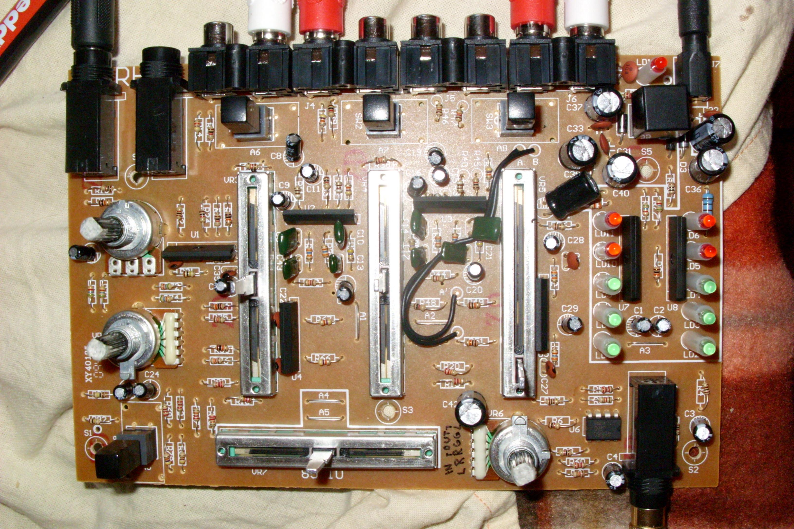

Well, at least this one has got new faders. 😛 Anyway, i took it apart today and will post some pics. The mono switch will be easy to rewire (it's connected with jumper wires, i guess they really didn't know what they were doing), it connects together the outputs of the main buffer opamp with two 1k resistors. This only reflects on the output not in the headphones, because they didn't take into account that 1k isn't enough mixing together when you're hitting an opamp input... Solution is simple, replace 1k resistors with 220 ohm or something of that nature, cut the traces to the main buffer and reroute them to the outputs of the mic preamp.
Wiring the headphones before the crossfader is going to require an extra buffer though. I do have a NE5532 on a shelf so i'm gonna use that. By the way, the thing is full of 4558 opamps and cheap electrolytics... Also most of the opamps are in the single-in-line format, will be difficult finding pin-to-pin replacements if i want to upgrade the sonics. But anyway, i have nothing against 4558s so for now i'll let them be.

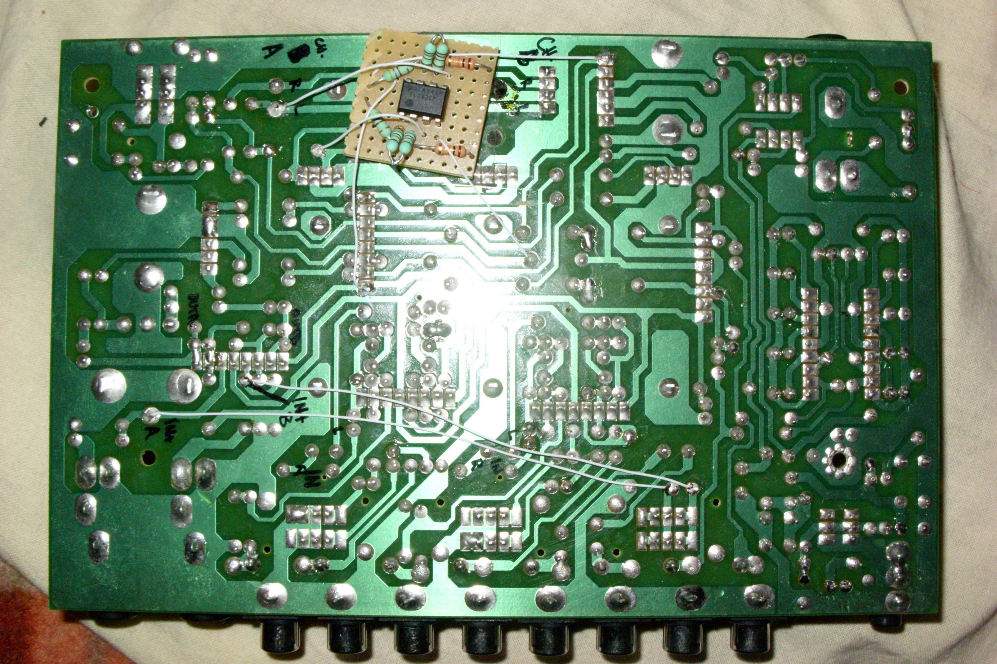

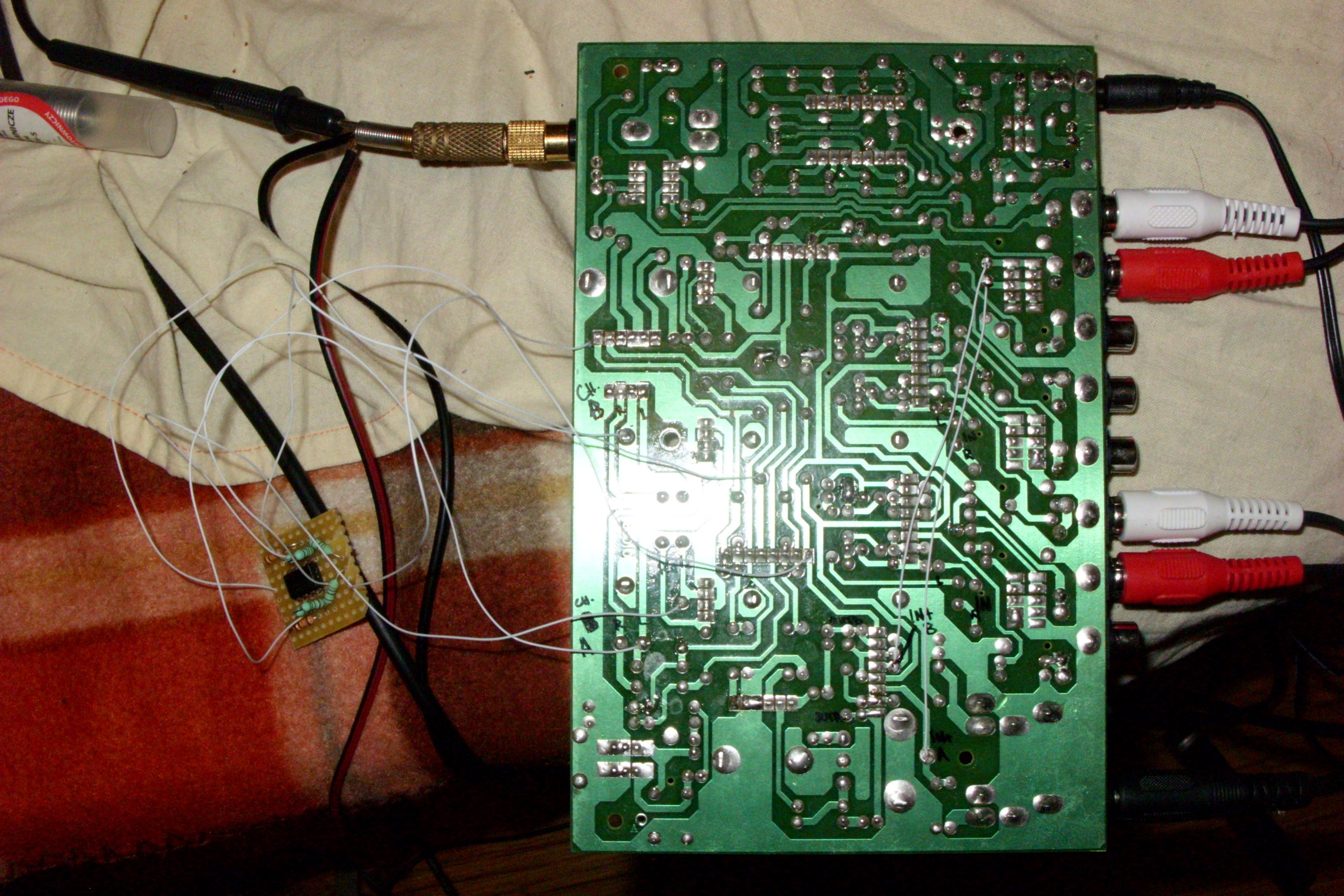

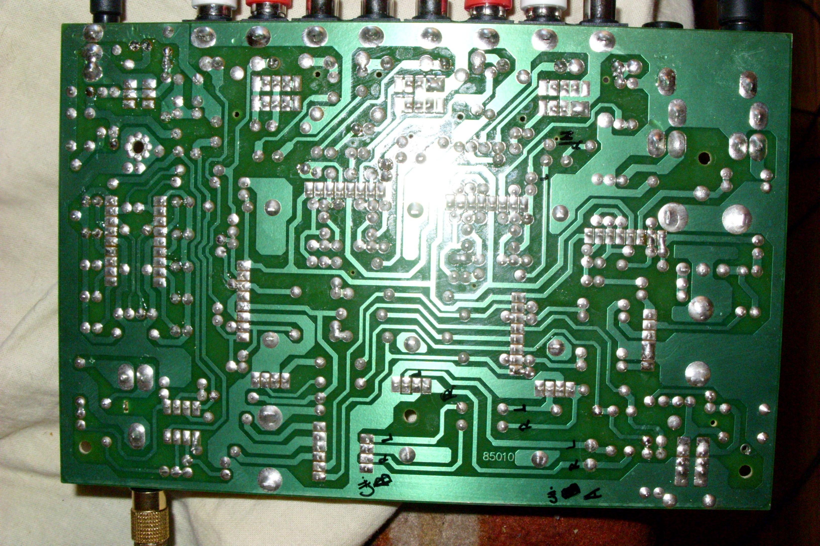

Anyway, what i said in my last post isn't totally right. The 1k resistors went to the main buffer, the ones to the headphone amp were higher values, thus they didn't mix in enough. Anyway, modding the mono switch was easy. I chose to wire it to the inputs of the microphone opamp. Now the pan control actually acts as a pan control. 😉 I lost the ability to balance the mikes from one another, but i hardly believe i will ever use two mikes on this thing so that's fine.
For the crossfader thing, i realized that if i would wire the headphone amp to be pre-fader from channels A and B, i would completely lose the ability to monitor the mike and the third channel. Plus, since i did not want to use a summing configuration at the input, i would've had to use a quad opamp. I did not want to use a summing configuration because the faders aren't buffered. They are just simple voltage dividers (with highish values too), and makeup gain is applied afterwards.
Thus i arrived at a compromise. I decided to only monitor the left channels pre-xfader and leave the right alone. So channels A and B together go in the left headphone so i can beatmatch, and if i need to monitor the mike or the other line channel, those go in the right headphone. And i can always use a mono adapter for my headphones if i want to listen to everything together with both ears. 😉
I checked the levels pre-fader and post-makeup gain amp with my oscilloscope, and i figured i would need a gain of 3 for the pre-xfader signals, so that's what i did. I had a lot of 10k resistors so i used a 10k to ground and for a gain of 3 (non-inverting amp so 20k required for feedback resistor) i simply put two in series. I actually used a TL082 as that's what i found first in the parts bin.
Result? Working just fine. 😀 I left the wires so long as i haven't figured out where the little perfboard will go when i put everything back together. 😛

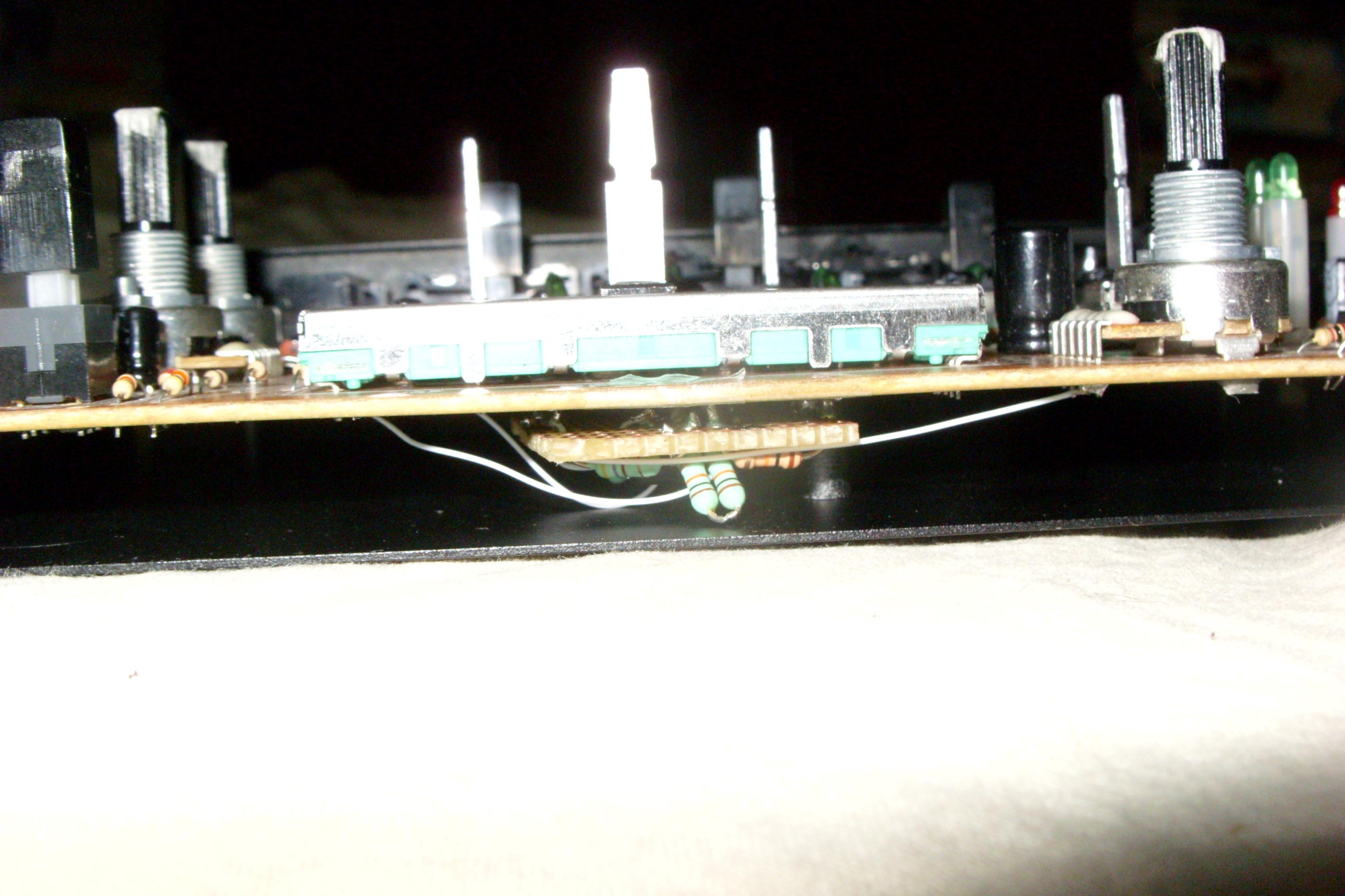

Anyway, i figured out where the extra board would fit. I think it ended up rather tidy, quite atypical of me. 😀 I've completed reassembly now and will give it a try in the new config. 🙂
I think I would put a glob of silicon seal or RTV to separate the two PCB's to make sure nothing ever shorts. Other than that, tidy little job. If you have TL082's laying around, you certainly know what to do with a 4558. My datasheets on ST33078 and JRC4560 don't show SIP packages. Just bent lead dip, for SOT wave soldering.
Actually, i did insulate the two PCBs, there is some scotch tape but you can't see it because it's transparent. Also the ground of the little PCB is soldered directly to a ground point on the main one.
Anyway, it turns out i had picked the wrong points for the inputs to the new opamp - silly me was testing with a single output soundcard, you can understand the rest. So, i re-wired the inputs to before all faders, straight after the coupling capacitors. This also demanded that i reconfigure the TL082 for unity gain, because now the left was too loud.
Of course, you're gonna say that having no volume controls on the left channel can cause balance issues in the headphones. However, with a signal source with headroom such as a computer soundcard, i can easily balance the levels so that the volume in both headphones is equal just when the meters start going into the red. Thus i can beatmatch AND level match at the same time. 😉 And it's working great so far.
