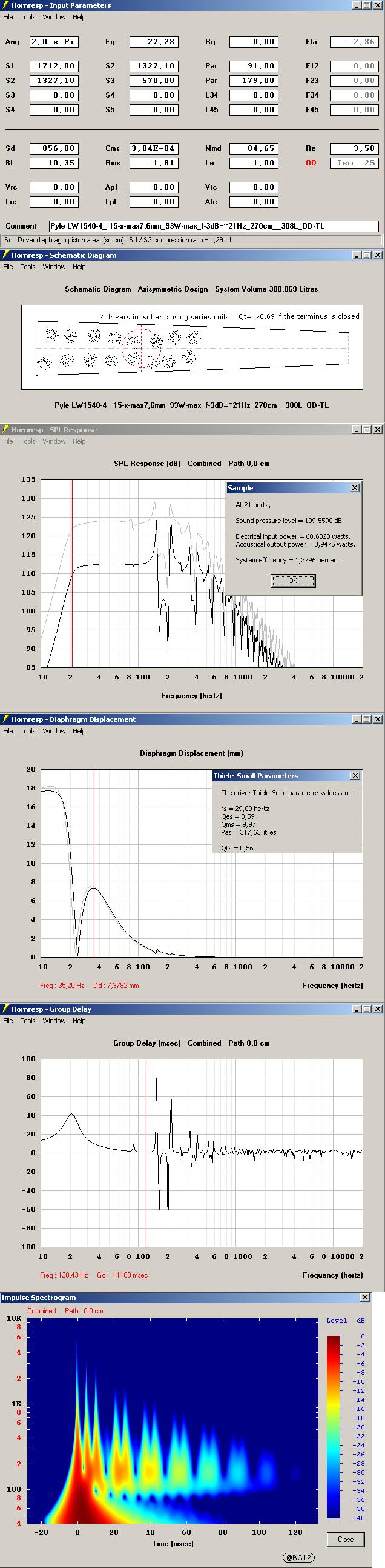

..So my aim is to have flattish musical bass from 30hz to 120hz...
What about this:
b🙂
PS: place the terminus nearest the floor level and the drivers above, this would require 3 bends.
b,
many thanks, that's a very good response. But I think folded horn (I think your design is a folded horn) and 308 liters internal volume is way beyond my abilities and my target for volume.
I want to keep below 200 liters and as it will be mating 4.5 inch mid/bass driver in a small closed box, I thin I need slower rollover in the upper end.
Perhaps I should go with a simple closed box or slot loaded 2 driver sub per channel, nothing fancy..
