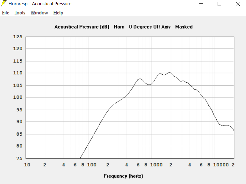

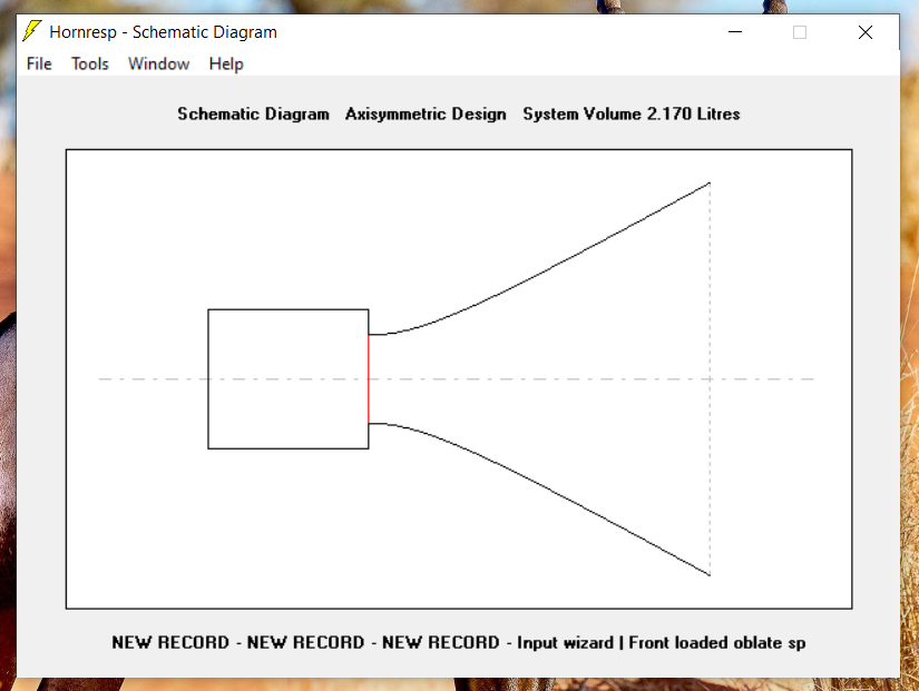

I'm currently attempting to model a simple front-loaded horn for a cone driver. (I'm aware this is not ideal, but this one has a fairly high EBP and thus should be pretty suitable.) I'd like to cross it over as low as possible.
The result is not good. Really not good. "How the heck did I lose all of my high frequency response on axis?" bad.
What did I screw up?

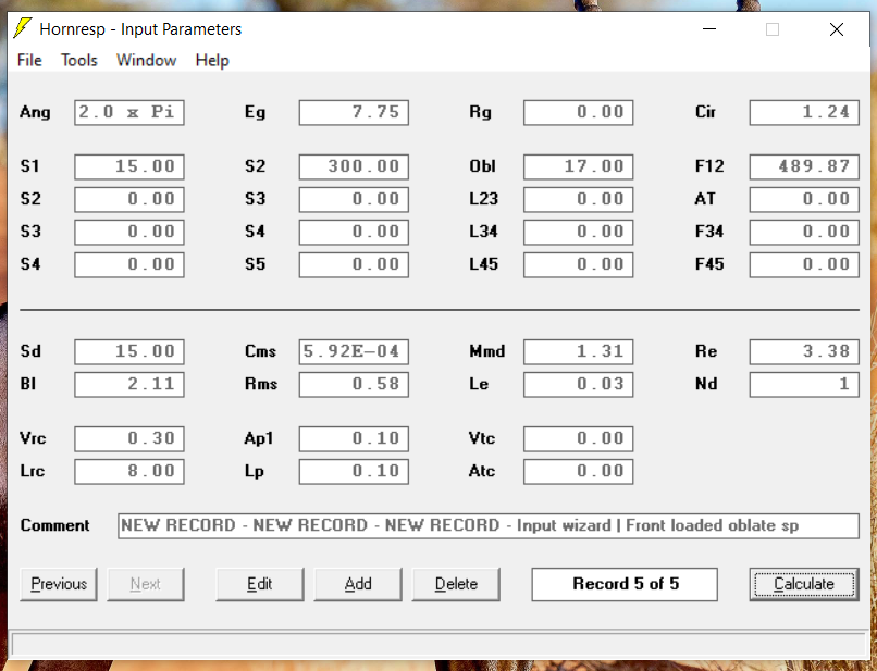

Hornresp appears to be yeeting my data into the abyss, but here's a copy rescued from the bit-bucket. Thanks!

Parabolic or conical WG for least horn 'color' and either damp the terminus perimeter with a suitable density 'baffle' or Dr. Geddes' 300 ppi? horn insert. If you need horn gain, then the pioneer's exponential + damping and 'it is what it is' except maybe...... what's the driver?
For high frequency with cone driver, you have to raise compression ratio a little
Your SD and S1 is the same size. Make S1 smaller
You just dont want excessive compression.
If SD is 15 then try 9.2 or 5.7 likely at the most for S1
likely good old expo type horn, conical can emphasize the low end more, depends.
