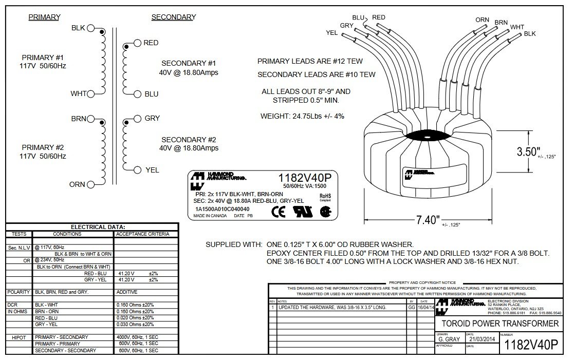

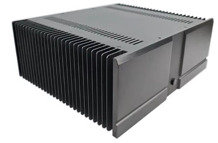

I have a large chassis(big heat sinks): internal 145mm high x 330mm wide x 440 mm deep.(The chassis I have is deeper than the attached pic). Top & bottom vents. I have a 1500 VA Hammond 1192V40P transformer for +/_ 55 volt rails. I have TO3 output boards that accommodate bass stoppers and emitter resistors on the boards. I don't have to deploy these but I have them and a stock pile of Onsemi TO3 devices on hand.

Explore the 'New Stasis Front End' thread by NP - your chassis is perfect for that. Schematics gerber files are all there by NP and ZenMod.
Totally class A, with BJT outputs. Build your own Threshold Stasis amp.
