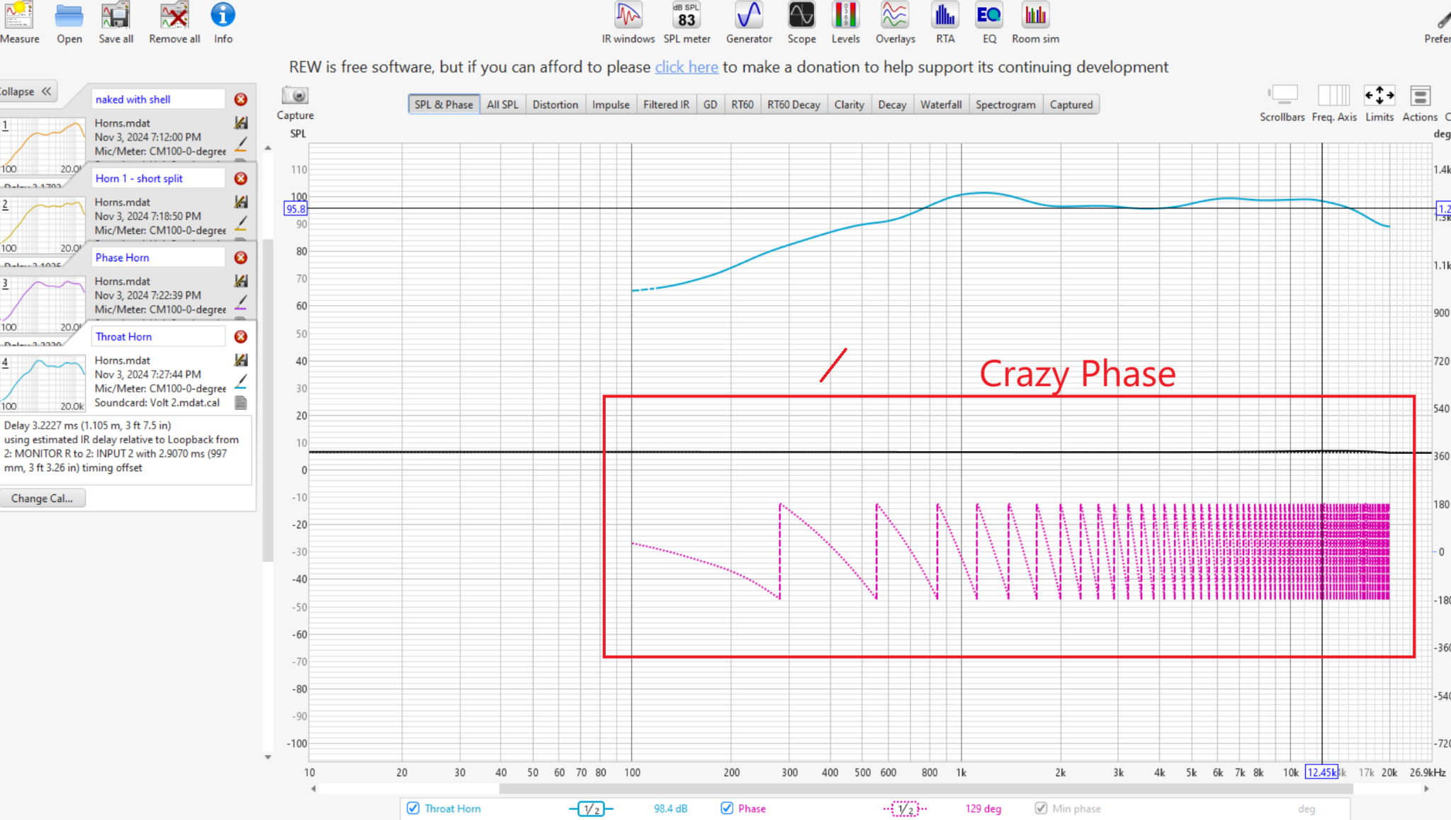

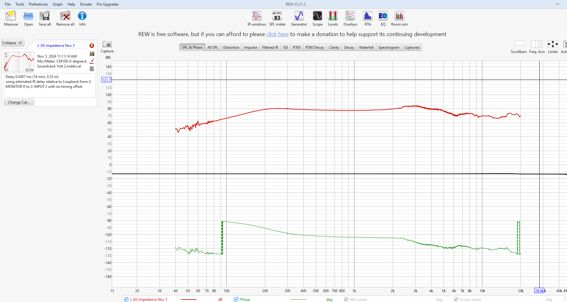

I have been taking measurements this week of a dipole mid planar. I have been getting this crazy phase shift that I thought was just from it being a dipole. I put a back cup on it and its still doing it. I then tested another speaker and its doing it for that speaker as well.
I must have something screwed up in my settings. Can someone please take a look at my settings and tell me what I have input incorrectly get this crazy phase shifting happening?
I'll attach pictures of the phase shift and my settings

"Note that to have valid phase information it is necessary to remove any time delays from the Impulse Response. A time delay causes a phase shift that increases with frequency - for example, a delay of just 1 ms results in a phase shift of 36 degrees at 100Hz but 3,600 degrees at 10kHz, because 1 ms is 1/10th of the 10 ms period of a 100Hz signal but is 10 times the 0.1 ms period of a 10kHz signal, and each period is 360 degrees. The time delay of a measurement can be adjusted by changing the zero position of the time axis using the Offset t=0 controls, or by using the Estimate IR delay control (Ctrl+Alt+E), both described below.

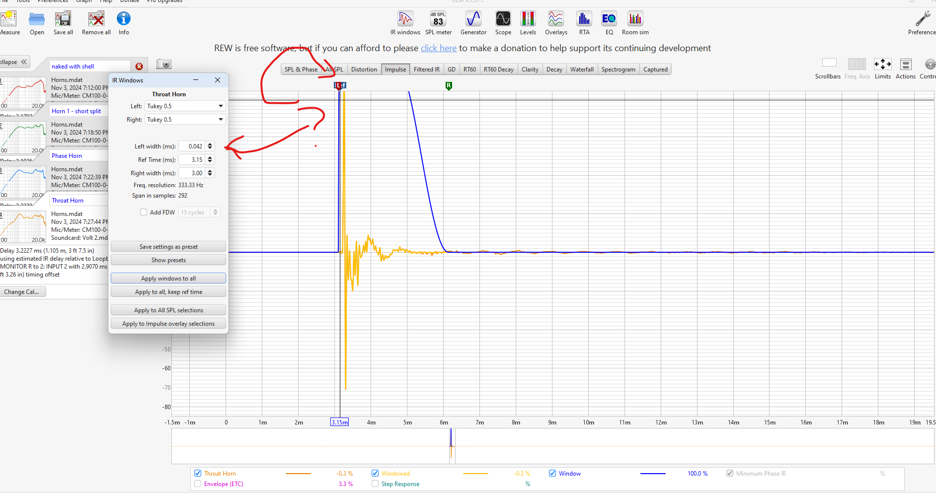

You’re looking at a perfectly normal phase behaviour, caused by not taking the top of the impulse response as starting point (left marker) of your time window. And it doesn’t matter, as long as you keep the left side of your time window constant when extracting phase and magnitude data.
Removing excess phase of course clears up the picture, but is pretty useless other than that things look better. I tend to leave it, rather optimizing the left marker position. Any processing introduces fault risks. But you’re welcome to read yourself into minimum phase, excess phase and the like.
I moved the red marker closer to where it normally is. Same with the reference marker. I am still getting the phase issue.

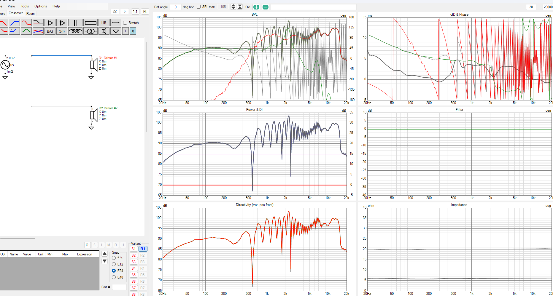

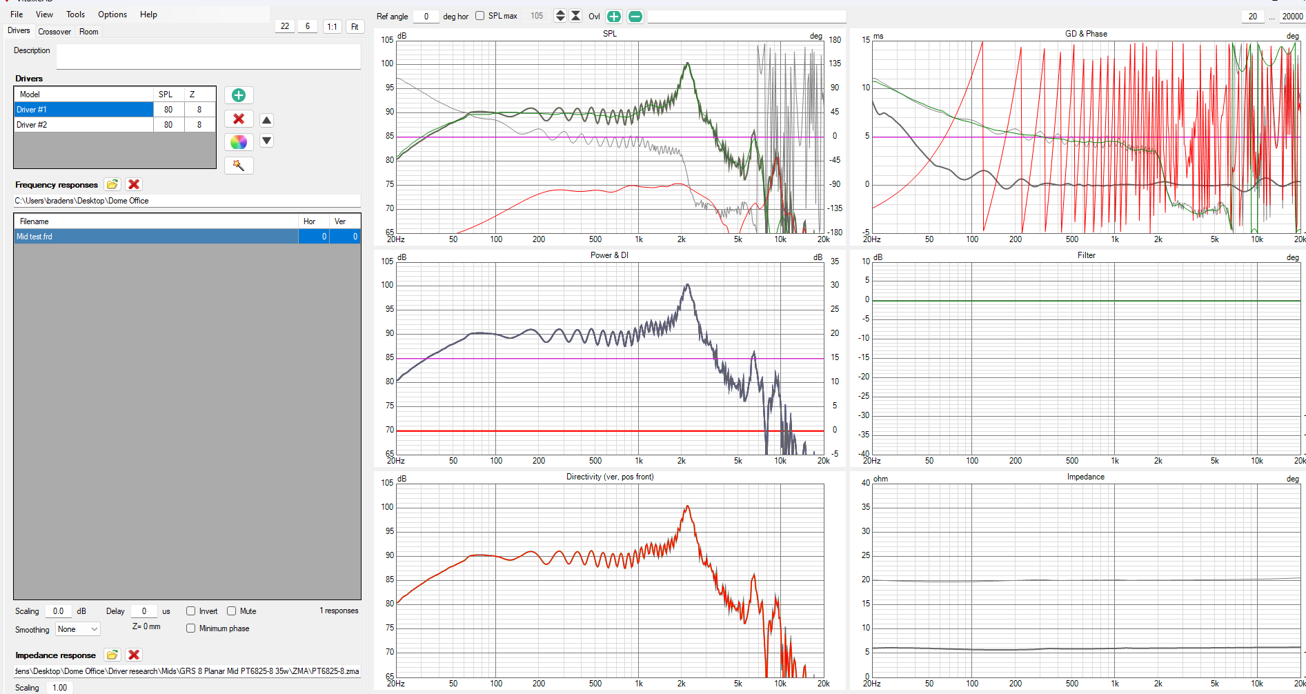

I would ignore it but when I try to cross the data over in simulation software it sends it all to hell

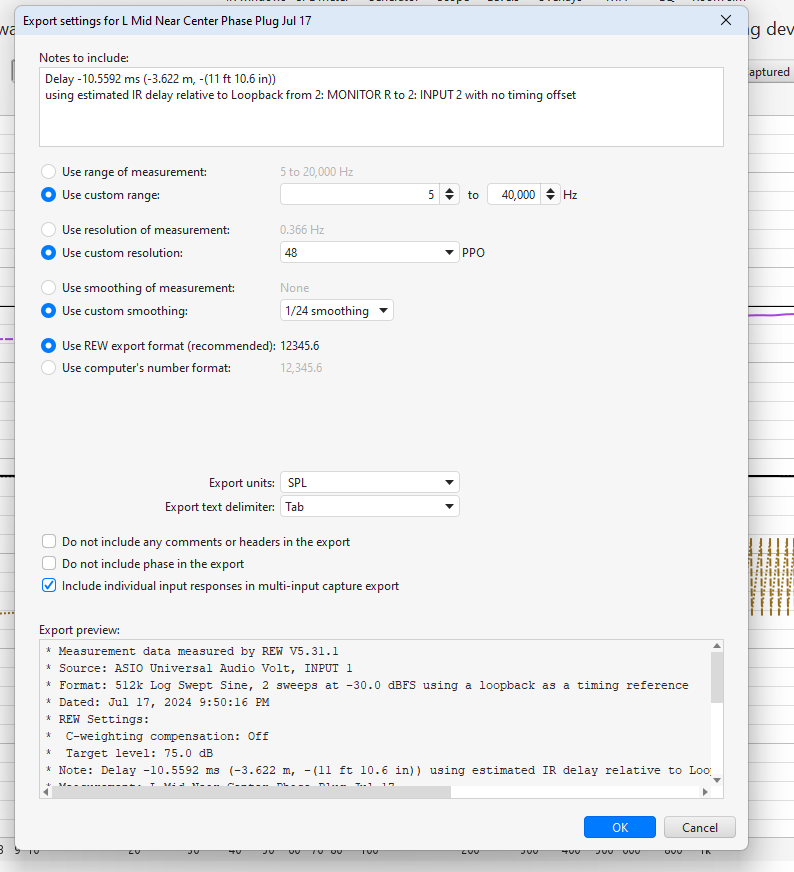

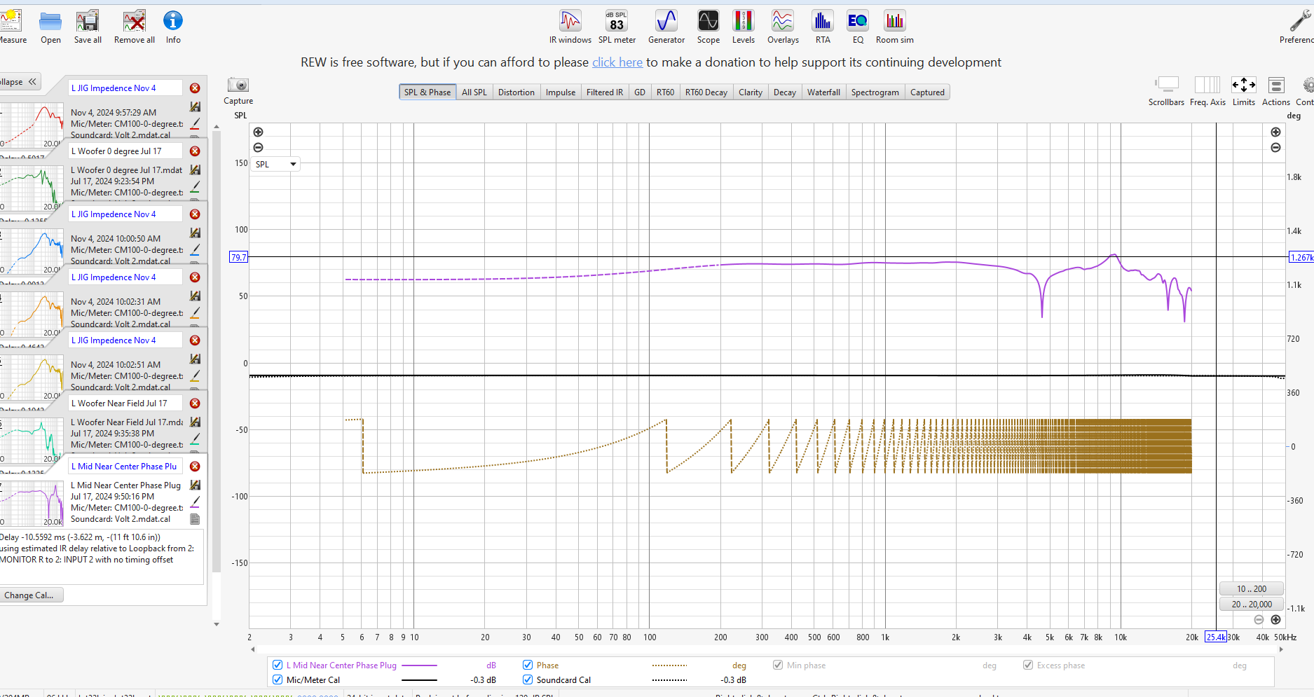

Now it is doing it for anything that I export. Here is a mid range I measured long ago. When I load it into Vituixcad it does the crazy phase shift thing.
I think I figured it out, sort of.......

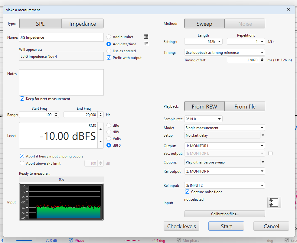

That timing offset needs to be right or it gives the crazy phase thing. The distance between the mic and driver needs to correspond properly with the timing offset or the phase will be entirely out of whack.
Is there a way to fix this after the fact? Matt, you said I could do it in the IR window? I am not seeing how you do this as nothing I changed in the IR window has any effect on the phase

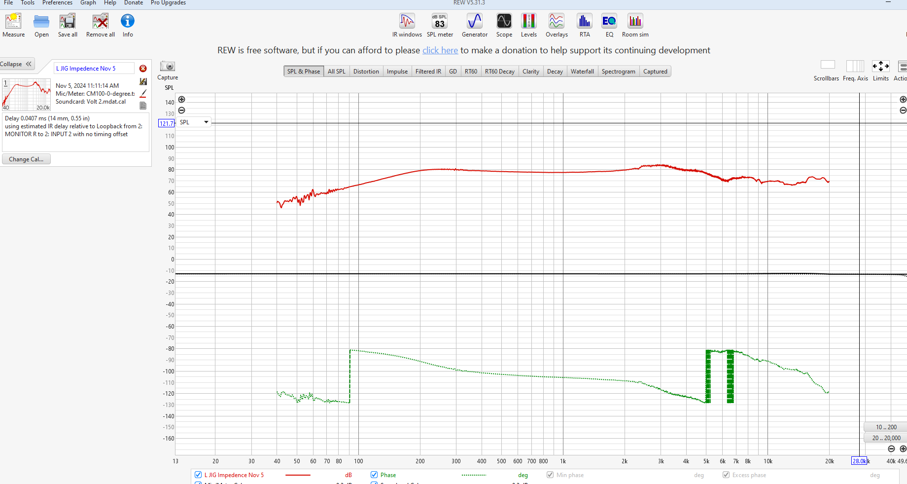

That first post of yours shows that ctrl+alt+E. Pressing that on a measurement fixes the phase issues.

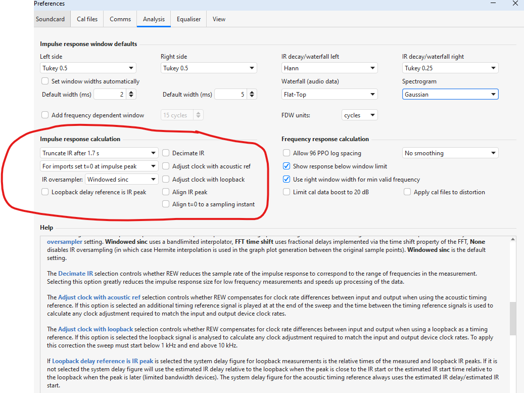

I do have the preferences set to t=0
I wonder what other of these I should be using. I read the description but I am not 100% grasping what would be benficial for me

Messing with the settings 100% to the book I come up with this 1st picture. It still has that little squiggle at the top but a little cntrl+alt+E fixes that right up.
