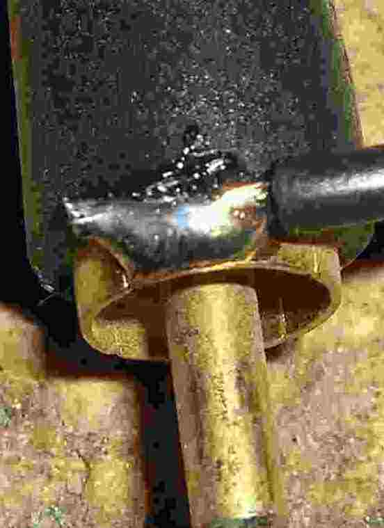

Then we need to take a length of small wire a couple feet long, we need to ground one end of the wire and with the engine running and noise present, touch the other end of the wire to the outer part of your RCA cable. The shiny part you can still see when the cable is plugged into the deck. This should make a little pop and the noise should go away.
If this gets rid of the noise let me know and we can help you get it repaired.

Some of those units are a little tricky to repair, some have to be completly dissasembled to get to the bottom of the circuit board. The following picture may be an easier alternative. You onl need to do this on 1 of your cables. If only 1 amp is making noise solder a wire to the shield of the patch cord that is connected to that amp. Ground the other end of the wire with the ground wire of the radio.
much thanks to you the task is finished and seems to work fine
