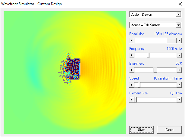

But last night I got another idea that seems crazy..... I need someone with enough physics knowledge to tell me why this is a dumb idea......otherwise I have to try this as well.
Wat if you fastened a strong steel mesh to the back of an open back cabinet (and around the driver) and filled the cabinet with pebbles, marbles or gravel?
This would somewhat restrict the air flow....a bit like slot loading maybe?
There would be some resistance.....a bit like a aperiodic vent?
The path length from front to back would be larger?
The weight would kill all cabinet vibrations
Would it kill air column and/or quarter wave resonances?
Would it be worth trying? Or has it been done already?

I don't understand. What am I looking at? Nothing good after what?but nothing good after

Nothing good after the first half-wave. The simulator itself doesn't seem very suitable for such a task. You can download Hornresp and run the Wavefront simulator yourself.Nothing good after what?
My main question at the moment is how much attenuation is needed to kill cavity resonances. Would a 3db attenuation per "bounce" kill any resonances?

2.5dB attenuation for a 50cm deep cabinet filled with pebbles would be hard to detect in a room.Wat if you fastened a strong steel mesh to the back of an open back cabinet (and around the driver) and filled the cabinet with pebbles, marbles or gravel?
No, the slots between pebbles are not like slot loading, and if they were, would cause resonances.This would somewhat restrict the air flow....a bit like slot loading maybe?
Not much, an aperiodic vent attenuates the output of the Helmholtz resonator, making the cabinet in between sealed and ported.There would be some resistance.....a bit like a aperiodic vent?
Slightly, which would distort the dipole figure of 8 pattern.The path length from front to back would be larger?
No.Would it kill air column and/or quarter wave resonances?
Considering it would have virtually no effect on the low bass you wish to regain, can't see the worth of it.Would it be worth trying? Or has it been done already?
That would have hardly any effect at low frequencies, and would simply increase the rear attenuation, which can be much more effectively be done with a box.Another variation would be to add some polyfill in between the stones/marbles
