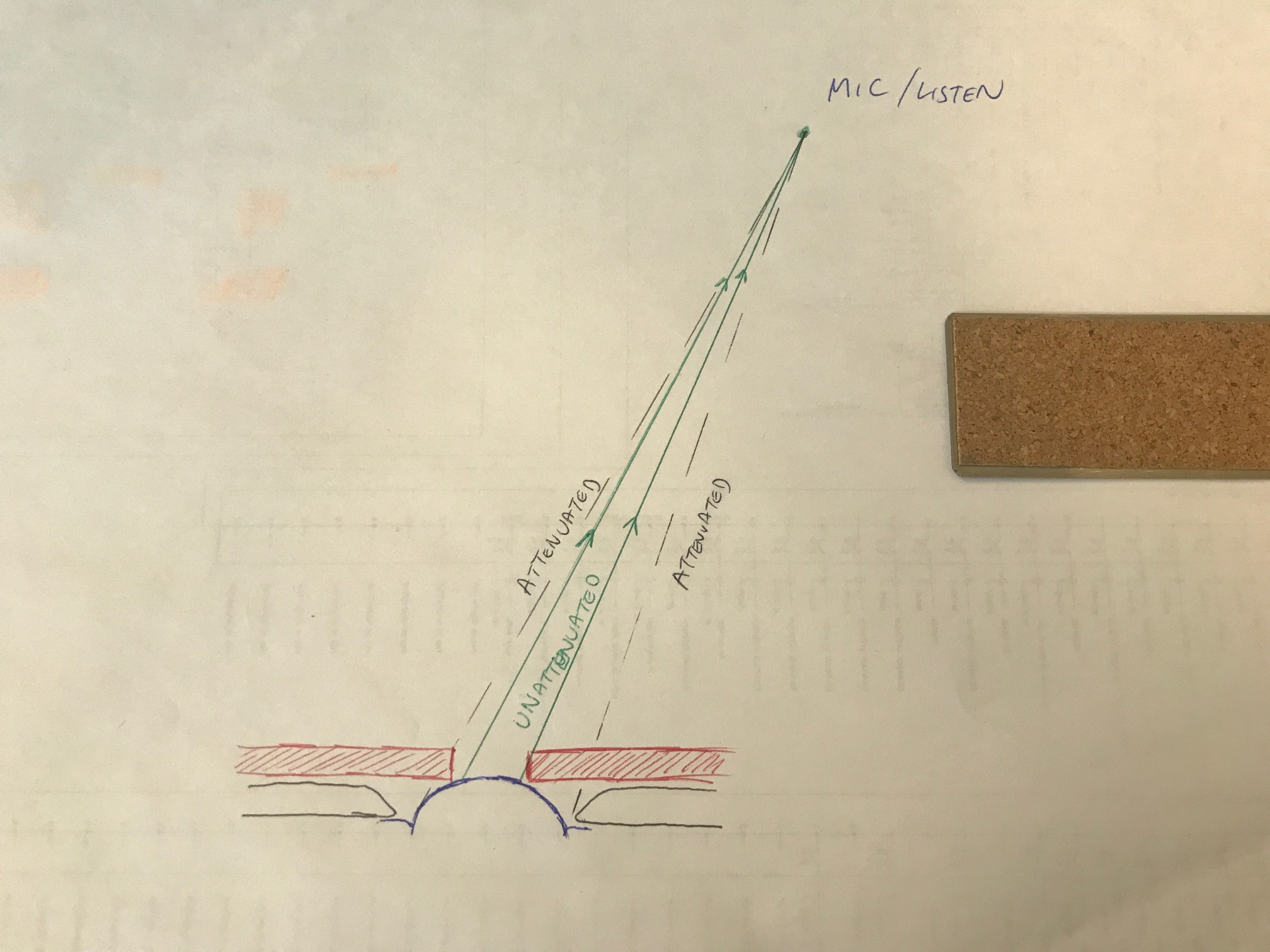

So we know that with diaphragms undergoing pistonic movement, the radiation pattern transitions from spherical/hemispherical to something that looks more like a beam as the frequency increases. The reason for this is because as the wavelength shortens, the sound waves produced at different areas of the diaphragm start to destructively interfere (combine out of phase) at the listening/measuring point, instead of constructively as they would at longer wavelengths.
What if we reduced or blocked the output from one part of the piston (in this case a dome tweeter) so that only a smaller portion would radiate to the point of interest? In theory, this would increase the frequency at which the dome would start to beam. One way to do this would be to put a thick sheet of felt over the dome, almost in contact with it, but with a small circular hole right over the tip of the dome. The portion of the dome visible through the hole would radiate as normal, as long as the listening/measuring angle was not occluded by the periphery of the hole, but all the other parts of the dome would not be able to contribute their sound energy.
So, this should work to improve off-axis response at high frequencies, but we've done nothing but turn one dome tweeter into a smaller dome tweeter, which is hardly better than selecting a smaller dome tweeter to begin with. The major downside we have now, though, is that the surface area has been significantly reduced which in turn reduces the peak displacement of the dome. This means that we now have less clean output at the low end of the dome's passband. How to get around this? Use a thinner sheet of felt, so that low frequencies (which constructively interfere) are less attenuated, while high frequencies (which generally interfere destructively) are more attenuated. One can imagine that there is a sweet spot, or sweet "range" of thicknesses that may be suitable for this application.
The end result is a dome tweeter that has perhaps a negligible drop in sensitivity at the low end of the passband, a slight drop in sensitivity in the midrange, and a significant drop in sensitivity at the top end of the passband, but with a significantly improved off-axis dispersion at the top. Easily solved with EQ, and the nice thing is, the tweeter is unlikely to thermally overload under normal SPLs since the spectral distribution of energy in almost all kinds of music drops with increasing frequency above 300-500 Hz. Off-axis dispersion is more important in near- and mid-field listening, which comparatively requires less power as well. Excursion is a moot point since the the whole point is to select a felt thickness that hardly attenuates the frequencies where dome displacement is critical.
Unfortunately, all of the above is purely my conjecture... I would love for anyone to put this to the test. I'll even pay for the felt!

Phillips did this 25 years ago. Seas still does it to some degree.

Yes that's an old and working trick. Other way to do it from Sonus Faber. Dimple dome and ring radiators are done for the same reason.

That’s just a phase shield... yes, it works but I feel as though it is less effective than restricting output to the very center. I guess some math is in order now!Phillips did this 25 years ago. Seas still does it to some degree.

Dimple domes and ring radiators are just to improve breakup. Their off-axis response tend to be worse than those of domes of the same approximate size.Yes that's an old and working trick. Other way to do it from Sonus Faber. Dimple dome and ring radiators are done for the same reason.

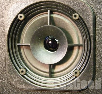

I misread your description somewhat.
What you are referring to is the AR "Bee Butt".
http://www.classicspeakerpages.net/IP.Board/uploads/post-101650-1137179013.jpg
The yellow stuff is fiberglass which is positioned to stop the comb filtering notches in the off axis response. There is some black felt in the center, but it does more or less nothing.
Very interesting. Do you have any further info on that, especially frequency response with/without the treatment?I misread your description somewhat.
EDIT: Found the page that had that photo. Apparently it is a mid, not a tweeter.
Yes, its a midrange, but that doesn't change anything about the physics.
AR originally used it in the AR3a. This was due to the use of a small 0.75" dome tweeter which had to be crossed over fairly high. They needed to use the 2" midrange dome up quite high to get enough high frequency output. Even then, the speaker's power response was quite rolled off above 8kHz. There was some degree of overlap between the midrange and tweeter if I recall.
In the AR303 that we did, the crossover was 5kHz I believe, but there was no overlap. We used the ring to make sure that the 2" dome had very flat power response up to the crossover frequency. We didn't really need to do that, but at least 50% of the entire design was to not deviate too much from features that the original product had.
I don't think any of the original measurement data exists anymore, but from memory the ring made the driver flat off axis out to about 8kHz.
