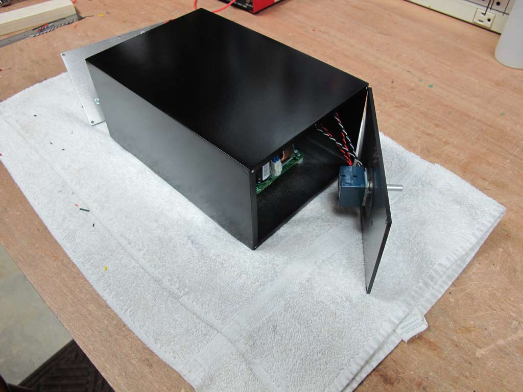

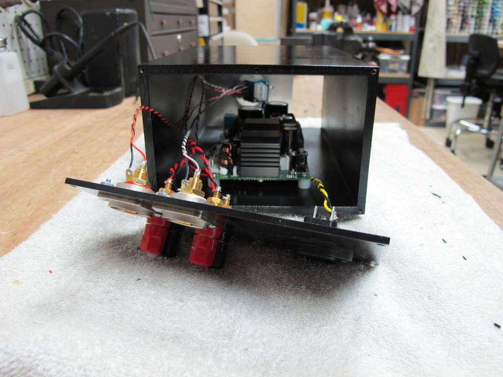

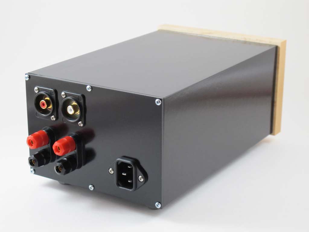

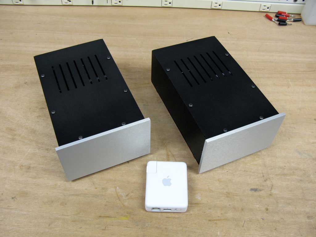

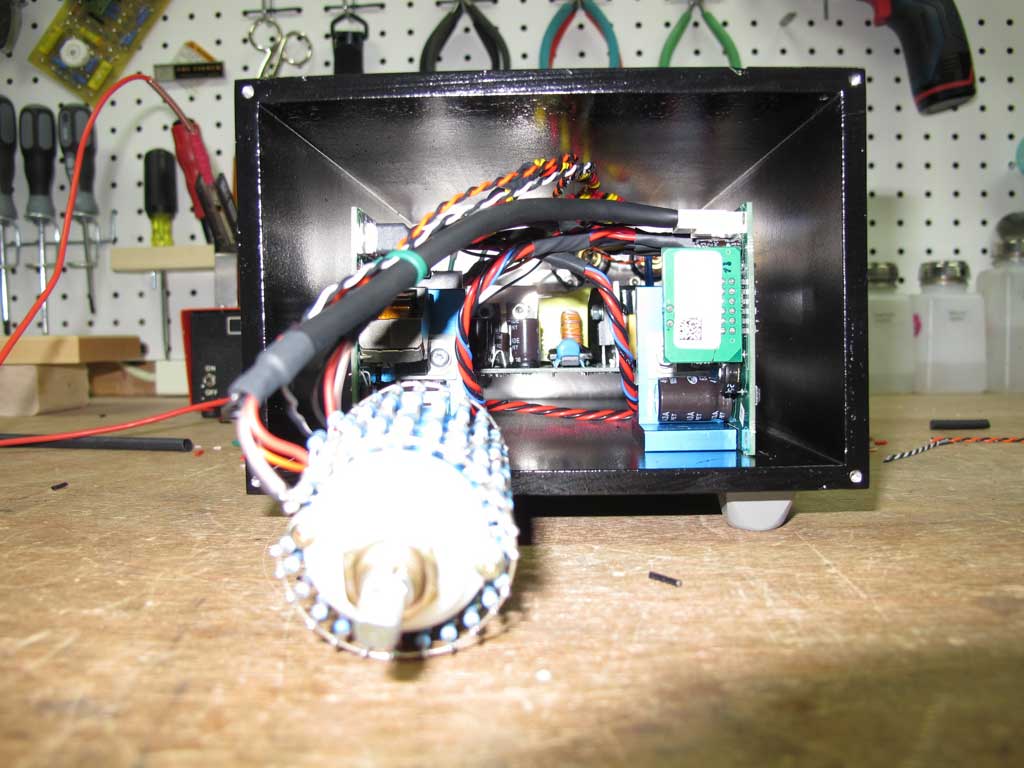

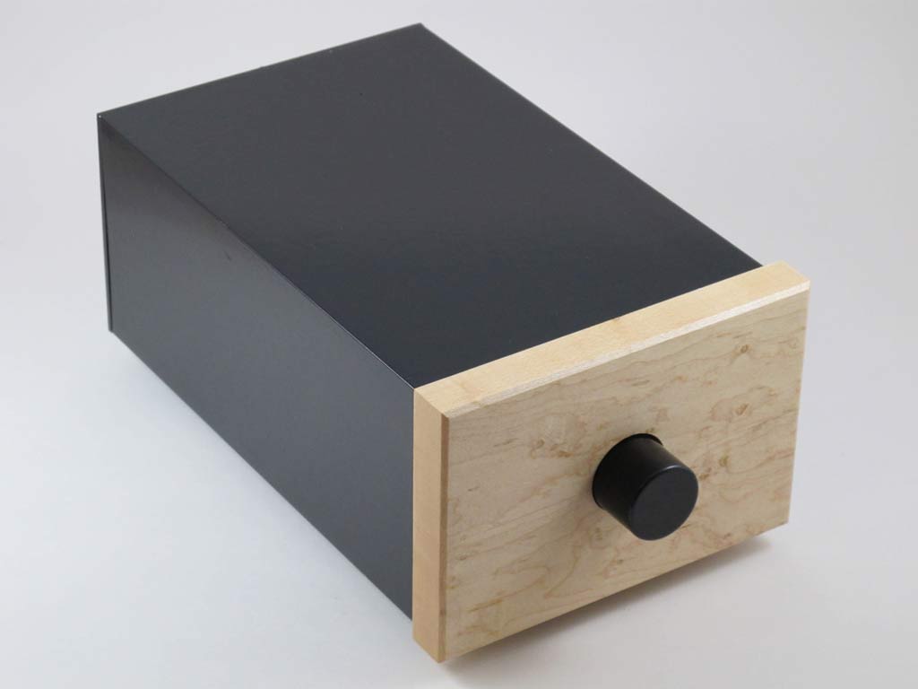

I have been fiddling with Tripath based amps for a couple years, and while they do some things really well, there is a nagging harshness or something similar that is amusical. I had a chance to buy an ICEPower 125ASX2 module. The differences were very interesting and because I just can't leave well enough alone, I bought a set of the Hypex UcD180's (just the plain ones; which seemed like a fairer fight; I'll mod these later).
The contenders are:
41Hz Amp 5 (with extra PS caps) which is based on the Tripath TA2022 chip
ICEPower 125ASX2 (I don't know anything about the topology)
Hypex UcD180ST and Hypex 400 SMPS.
My listening has been through Quad ESL63's and Seas 2-way speakers based on a 27TFFC tweeter and a ER18RNX midbass. I'm using my transformer coupled DAC fed by an airport express and lossless files.
Here's my initial thoughts:
The tripath amp has some harshness in the upper octaves, it's hard to describe, it's not quite the same as a harsh normal amplifier. But it sounds reasonably good.
The ICE amp has way more bass authority than the tripath amp, it's almost bass heavy, but not quite. The treble is more refined too, but there is still a bit of disjointedness across the spectrum. That's also hard to describe, but it's noticable compared to the Hypex amp. Without the hypex to compare it to, I never would have noticed.
The Hypex amp has full warm bass that is not quite as sterile and clean as the ICEpower amp, but is still very clean and tight. The Dyna amp in contrast is big fat and flabby in the bass department. The Dyna is good sounding, but hardly accurate. The rest of the frequency spectrum in the Hypex is just there, and right.
The ICEPower and the Hypex, and to a lesser extent the Tripath, are amazingly transparent and distortion free to a degree that I've never heard in any other standard amp solid state or tube. These amps in generally just aren't there, it's hard to compare the two because I'm listening through them to the source. I've been comparing them to my Grado 225s and my ultra low distortion headphone amp.
I have to say that the Hypex is certainly a keeper.

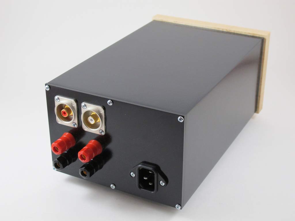

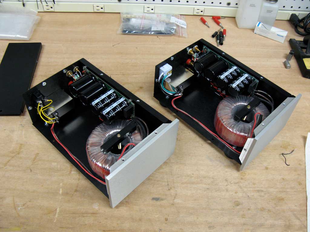

Here's some pics of the various amps:
Thoughts?
Sheldon

I love the cabinets. Thanks for showing those Neutrik RCA connectors - those were exactly what I needed without knowing it!
