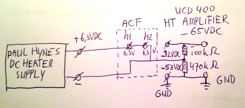

Yes, this is the right circuit, except the bias voltage should be negative in this case.
Just use a DC voltage of about -50V, half the H-K rating.
This afternoon I have connected it as in picture beneath. But before I power it on, I just wanted to make sure if I am doing the correct thing and not ruining my poweramp and/or the heatersupply.
Can you pls take a look at it? Peter van Doornum
Is this okay?
the correct thing and not ruining my poweramp and/or the heatersupply. Can you pls take a look at it? Peter van Doornum Is this okay?
Ok, except there must be a capacitor from the -53VDC heater tap to ground, with a value of 0.1-10uF,
with polarity observed (if it's an electrolytic). Make sure the heater supply is really floating, with its chassis isolated
from any other electrical contact. Once you connect it, verify that the -53VDC is still correct.
Elevate heater supply did not work
Unfortunately the elevation of the heater supply did not work for me.
I elevated the supply to _50VDC, thus to reduce the h-kathode value., but it did not lead to the reduction of HUM.😕😕😕. It did not change, sadly.
There must be something else. I hope I can find it. I'll try to implement the other recommendations brought forward by you.
I'll let you know.
Peter

Hi Gabdx,
Unfortunately the elevation of heater supply did not work. There was no change in hum, frequency and loudness.
Can you please explain or clarify by drawing or so what you mean and how i can implement what you propose. I really want to try.
I don't know what is going wrong. I have the same ACF in another class-D (Abletec 0300) amplifier, but the same hum occurs. Maybe it has got something to do with unbalance in the HT + and - of the class-D amps which the ACF can not handle??

Thanks Rayma i will go on and let you know of it works
Peter
Hi Rayma,
I listened again today on my hornspeakers and I must say; the hum did reduce considerably. There is still hum but it is a lot less then there used to be. This morning I placed 2,2uF MKP parallel on the 470kOhm to GND but now I have placed 2 extra uF in parallel, so now 4,2uF total. Do you think the hum reduces if I increase the capacitor to max 10uF?
Peter
Hi Rayma,
I would guess that the hum will be reduced further if the total amount is doubled. Bear in mind that some
of the hum could be from a different mechanism. Is the filament bias voltage correct?

Elevating the DC wont work, i did AC heater supply for a dac input 6n6p cathodeF without any hint of hum, 200V Hv-K 🙂 but after i did the elevation because it prevents heather stripping.
Ground looping UCD 400
Hi ionutzxpo,
Thanks for your answer. I was thinking the same but i just couldn't find it. Now i elevated heater voltage to 50 Volts and hum reduced considerably.
Still i believe, there is ground looping to a certain extent, but i don't know where to pinpoint it. I have consequently used star grounding.
Cheers Peter
