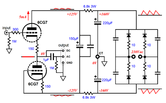

How can I float the filament to at least -50VDC?
Use a resistive divider with a total resistance of a few 100k between the B- and ground.
The center of the divider should be at around half the B- voltage.
Decouple this point to ground with a capacitor, 1-10uF. Connect the filament supply to this node, instead of to ground.

The hum stays. I thinks it has got something to do with with Rayma says the kathode heater voltage and how to elevate the heater voltage to operate within max ratings of the 6N6P.
I've just found out that the H-K maximum voltage on this tube is 100V. So, set the tap at -50VDC
and float the entire filament circuit at that level, decoupled to ground.

But strange anyway that all voltages are DC , nevertheless it can cause hum (AC!) if A-K voltage is exceeded? Weird electrons?
Thanks, Peter
Thanks very much Rayma, for the investigation. I'll try it tomorrow and will keep you posted. I hope it helps.
But strange anyway that all voltages are DC , nevertheless it can cause hum (AC!) if A-K voltage is exceeded? Weird electrons? Thanks, Peter
This is a long-familiar effect known to those growing up with the devices. The giveaway is that the noise is 60Hz, not 120Hz.
This almost certainly means heater-cathode leakage.

I just finished ACF last weekend, using glassware PCB(not the all-in-one),6922 tube, and AC heater, hook to my class D AMS1000-2600 AMP, dead silent. The key is to twist the wire, and lift the heater. Use 2X510 resister to divide AC heater, and 47k/200K resisters on B+. Here show you how to do it, take a look a PS part
Yes, this is the right circuit, except the bias voltage should be negative in this case.
Just use a DC voltage of about -50V, half the H-K rating.
