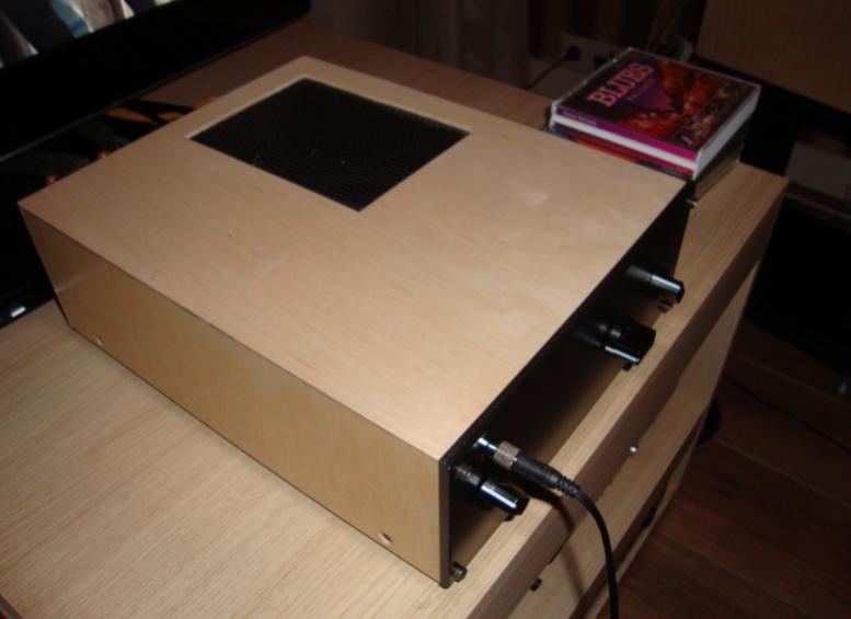

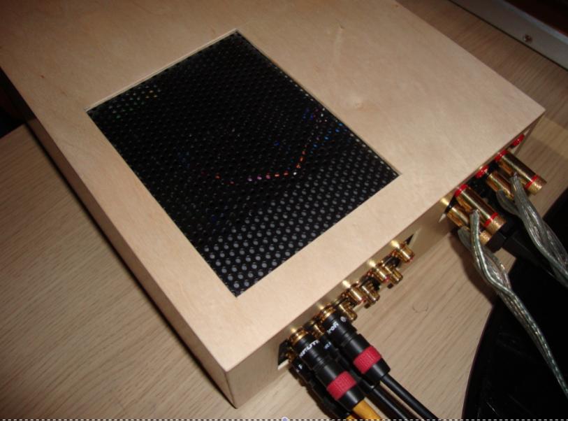

I used the ucd180 because they have good specs and are cheapest in the range and I improved the opamp.
As long I do not under stand why a hrx shout be better.
My amp is build of spare birch multiplex pieces and other stuff that laid around. Next step I am working on build in a 24bit DAC.

No I mounted them to black a headsink from about 3 degrees/W.
two modules of 180 =360W X 8% losses =28,8W
3X28,8 =86,4 degrees rise with a ambient of 30 degrees 116,4 degrees.
But it isn't real to estimate that a stereo amp constant has to output 360W.

I think by feeling it it will be 40-50 degrees. And I know how it feels. When you look good you see the sides are also aluminum. And the connection box is also aluminum. In-fact not all power will be direct radiated to the heat-sink on the circuit board so even with 8W loss not al the loss will end up on the heatsink. And I use a perforated alu plate at bottom and top to have good air flow.
Infact I didn't calculate at all when building it I knew it would be enough.
And a wooden enclosure does ensure a real warmth audiofeel sound.

without yokes wood is still a nice insulating material to work with mine was 16euro for paint and aluminium plate.
And look now like this.
you see no difference.
205123d1294859102-hypex-ucd180hg-hxr-400hg-hxr-schermafbeelding-2011-01-12-om-20.02.25.jpg
This also goos for the sound its makes and it makes DIY fun again. Fast to build great result and 600euro saved.
Metal is cheap to produce with for a manufaturer. I Like wood and do see a real advantage in the reduce unwanted parasitic capacitors in the amp.
