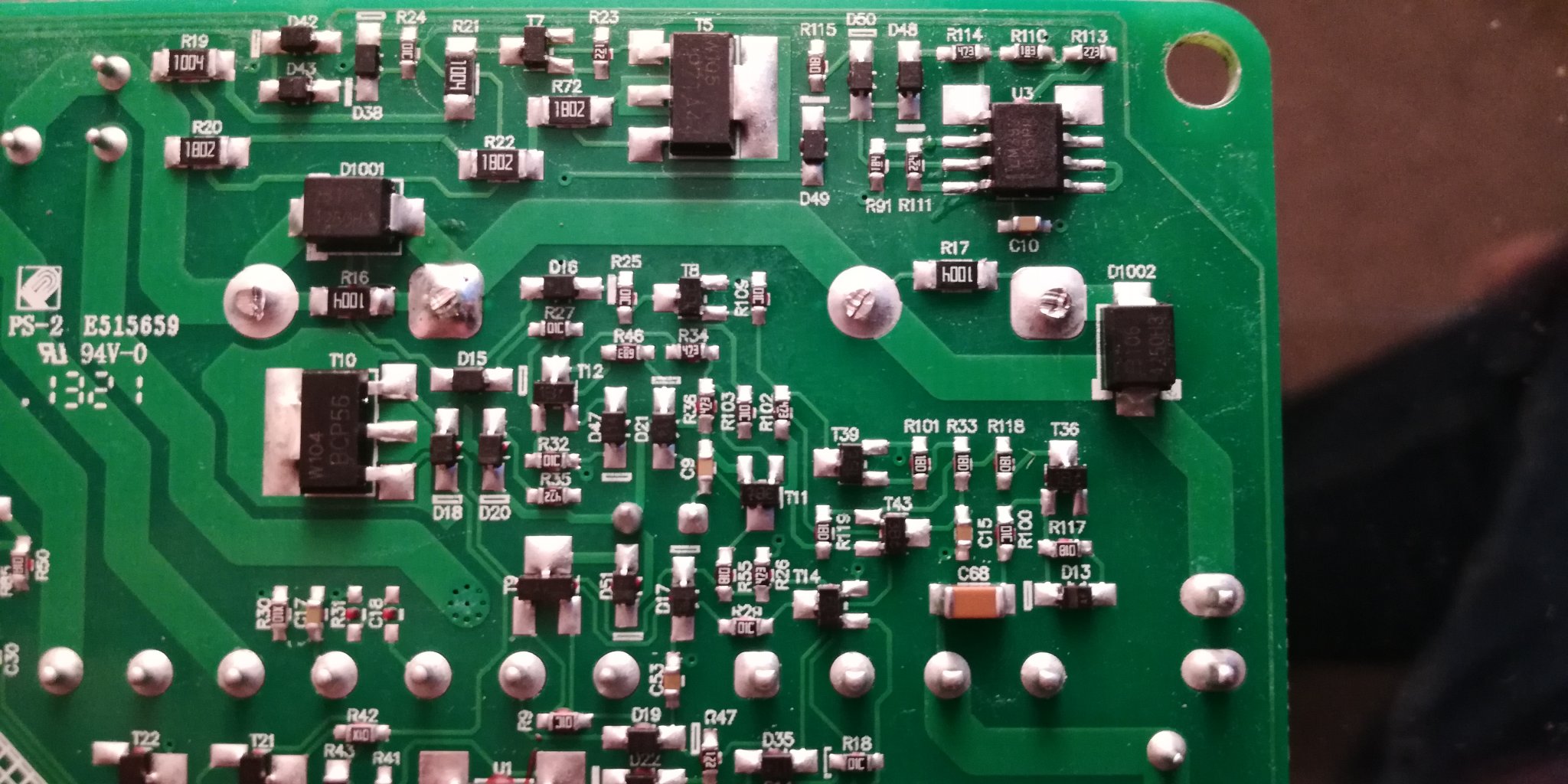

Puh, that SMD stuff is tiny.
My board is a relatively new SMPS400A180, I guess it is the latest revision.
Anyway, on my board the parts are marked as follows.
T14: t09
T7: 1Bt
R23: 221
D43: DB (?, could also be D8)
I am posting a picture for reference of the locations but you can only read the marks on the resistors.

Thank you Joe! It is indeed very small and difficult to be read without a microscope.
For D43, D8 corresponds to a 7v5 zener diode while DB to a 12v zener diode. I would guess that DB is the correct one as someone already mentioned it as 12v.
It seems indeed that your PSU is a new model and that the design has been reviewed which can explain why some discrepancies can be found in the values indicated on internet.
My model must be much older (V14 board). T14 is not a smd on mine.
You have been really helpful. Thank you for your support.
