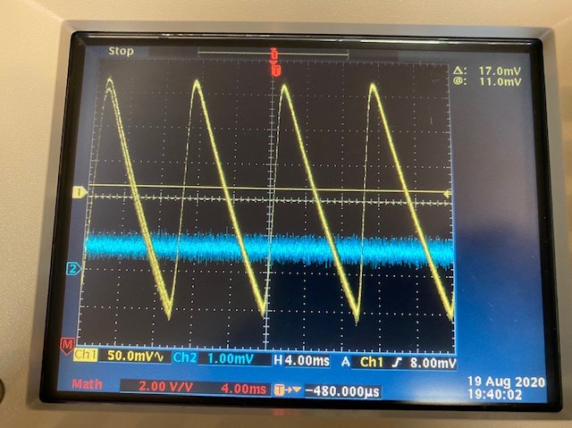

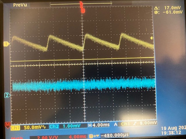

Let's look at ripple performance:
To my surprise, the SMPS was very quiet at HF, but there was a good bid of rounded out sawtooth 100 Hz ripple:
- 50 mV pk-pk when idle, i.e. only loaded by its internal circuitry
- 320 mV on the positive supply when the negative supply was loaded with 66 R
- 350 mV on the positive side when itself was loaded (not sure this wasn't mostly determined by when I hit the stop button)
- 1.1 V when the positive side was loaded by 33 R
- 1.0 V when 66 R was applied across the whole 126 V, i.e. same load as loading one side with 33 R
I think we can safely conclude that there is no primary regulation or a feedback loop from the secondary to the primary side.
The conventional supply had 10 mV of 100 Hz Pk-Pk sawtooth ripple when completely unloaded, but 1,6 V when one side was loaded with 66 R (a little less than 1 A). The ripple performance of the SMPS is very similar to what the conventional supply achieved at a roughly equal percent loading. The difference is that the sawtooth didn't have any evident harmonics in the SMPS.

Thanks for those measurements, worthwhile.
Indeed, those Hypex supplies are not regulated, I think it even mentions that in the data sheet.
But you say 'no harmonics of the sawtooth', not sure what you mean by that, by definition a sawtooth has a decreasing slew of odd harmonics to its fundamental.
