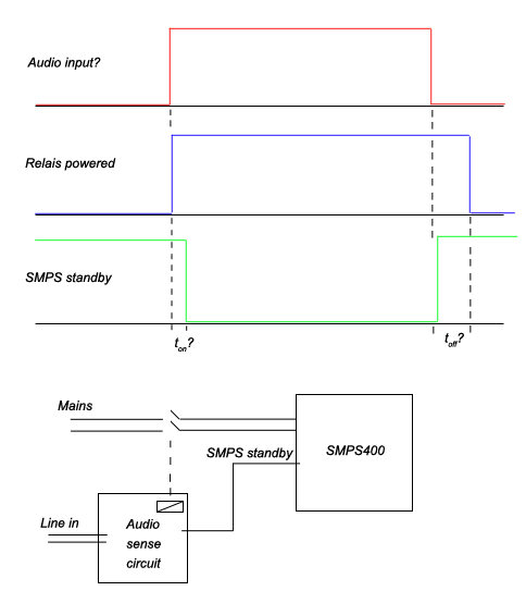

Hi all the DIYers, Hi Jan-peter,
I have some questions about SMPS stand-by input and SMPS amplifier stand-by input.
Could you tell me if the gound ref. for these inputs is the ouput ground of the SMPS?
If the first answer is yes, and If I plan to use a µC board to control 2 SMPS, I will have to connect µC board ground to SMPS1 ground and µC board ground to SMPS2 ground too in my system.
Is this will not be a problem to connect all the ground together?
What about ground loop in this case?
Franck

Hi Franck,
I would connect the grounds togehter close to the amplifier. If you use balanced wiring for the signal ground loops will be no problem.

Jan-Peter,
If applying DC to this input before power is no problem; I have another question.... I'm planning a stereo poweramp with an automatic power-on/off.
The plan: if there's an input signal, a relais switches on power to the smsps400. a while after the standby-voltage is made low to softstart the smps. If audio is gone, after 10 minutes the amp should be turned off. First, the standby-signal is put high, and after a while the relais disconnects the smsps400 from mains.
See attachment.
What Ton and Toff should I be thinking of?
