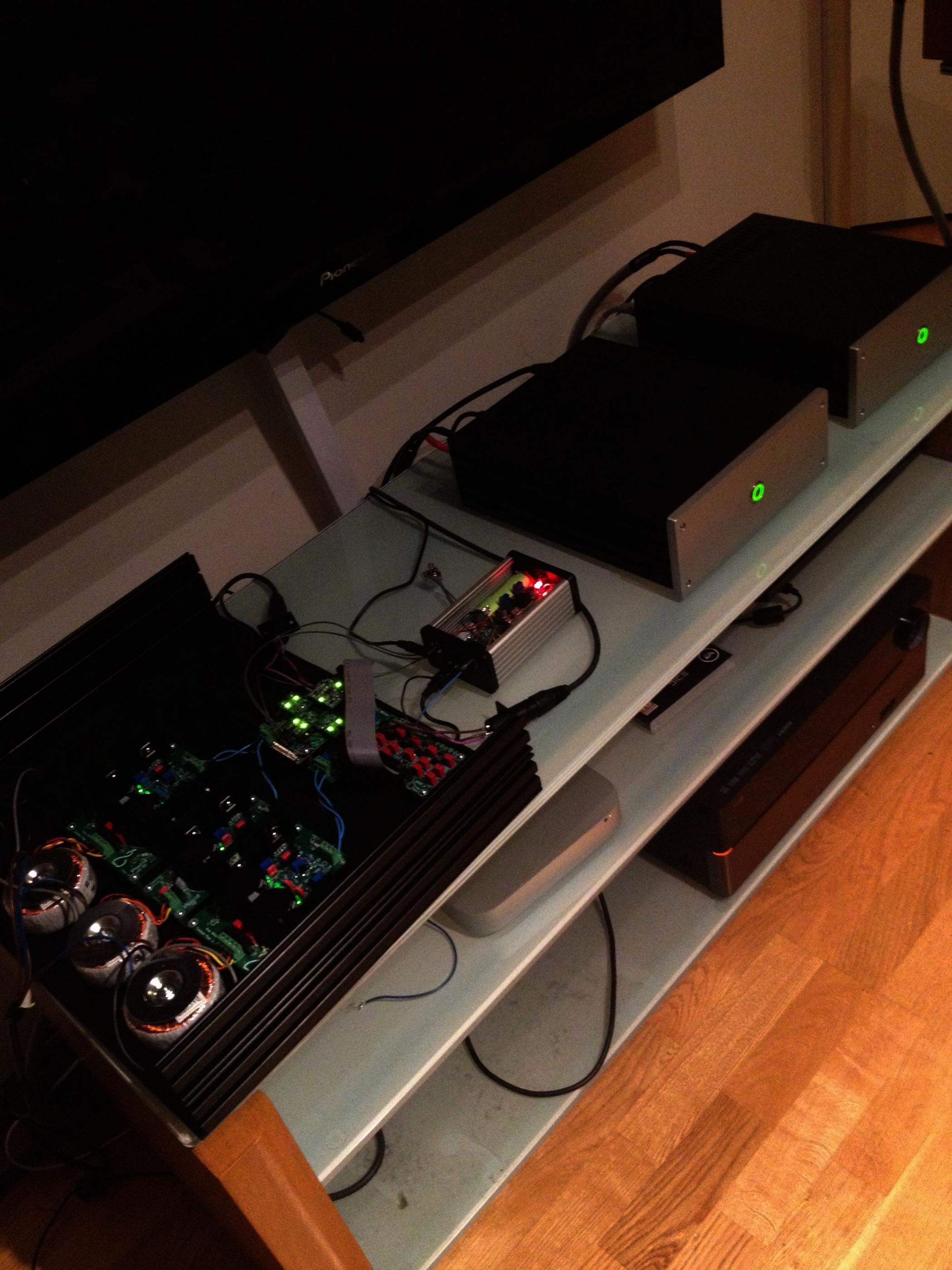

Brad, I would drive each side tweeters/mid-woofer with one PS. I believe to obtain optimal results out of the NCores, SMPS600 should be used.
Please let us know how your Orion's perform with the NCores.
Jacq.
