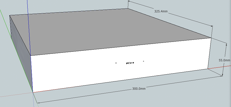

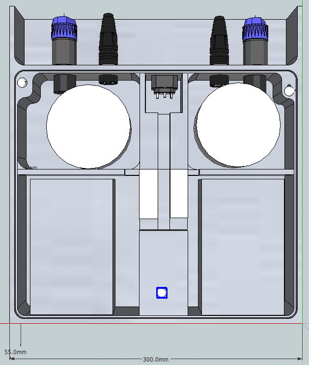

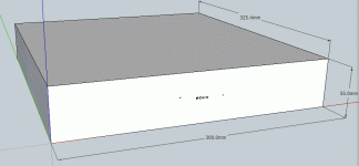

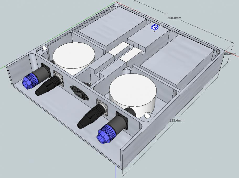

On a somewhat different matter than pure tech, here's my sketchupped "artists" impression of a case. As you can see, I'm not that much of an artist.
Turns out that a mate of mine has a CNC router (diy) that "should" be able to do aluminium and he was actually happy to test it out somewhere in the (not so near) future.
Still a lot to be done, but I'm aiming for a kind of Linn Klimax look. Really cool. Sort of a sidewalk-tile (stoeptegel??) meets fondleslab meets klimax-esque thing👍.
Try searching google images for the linn klimax. I especially like the "roofed" connector section at the back. Sort of a cross reference to Linn (who I think started it) and Devialet (yeah right!). Don;t forget to add KLIMAX to the query in google if you have your filters set to none (NSFW results). W in this case may also be wife (not that I have one, but hey gf is almost wife sometimes).
