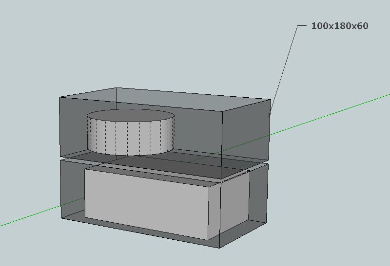

@richard the "two tier" version could be made with two separate boxes that bolt on top of eachother 🙂
In fact that's the second option I was considering.
I did prefer the modular aspect of this approach. You simply add boxes on top of the stack when you decide to active / biamp etc. You could add just one more amp chassis for biamp (have two modules share one SMPS) or add one SMPS and two amp cases (a total of two SMPSs and three NCores) for an active speaker setup or whatever...
A minor downside is you have to figure out the proper way to do all the wiring between the power and amp enclosures but ofc it's feasible.
The major downside (and they reason why I drifted away from this approach) is that two smaller enclosures usually end up being more expensive than going with a single taller one.
So flexibility costs $$$. Ain't life a ...?! 😀
I'm trying to get people off binding posts and onto speakons. Any chance of that being included?
I was already thinking about bolting two cylindrical sections to eachother for an oem project. I figured the styling might be too extreme to appeal to the masses. I'll have think and draw a few options.
I'll see how to include multiple neutrik cutouts to gain some flexibility.
Rgds,
Richard
Rgds,
Richard
How about a large cut out in the back, and have different configuration of bolt on plates for it ? That way the chassis remains universal but those of us that are fine with IEC,Speakon,XLR can have that and those that want binding posts can have that too.
