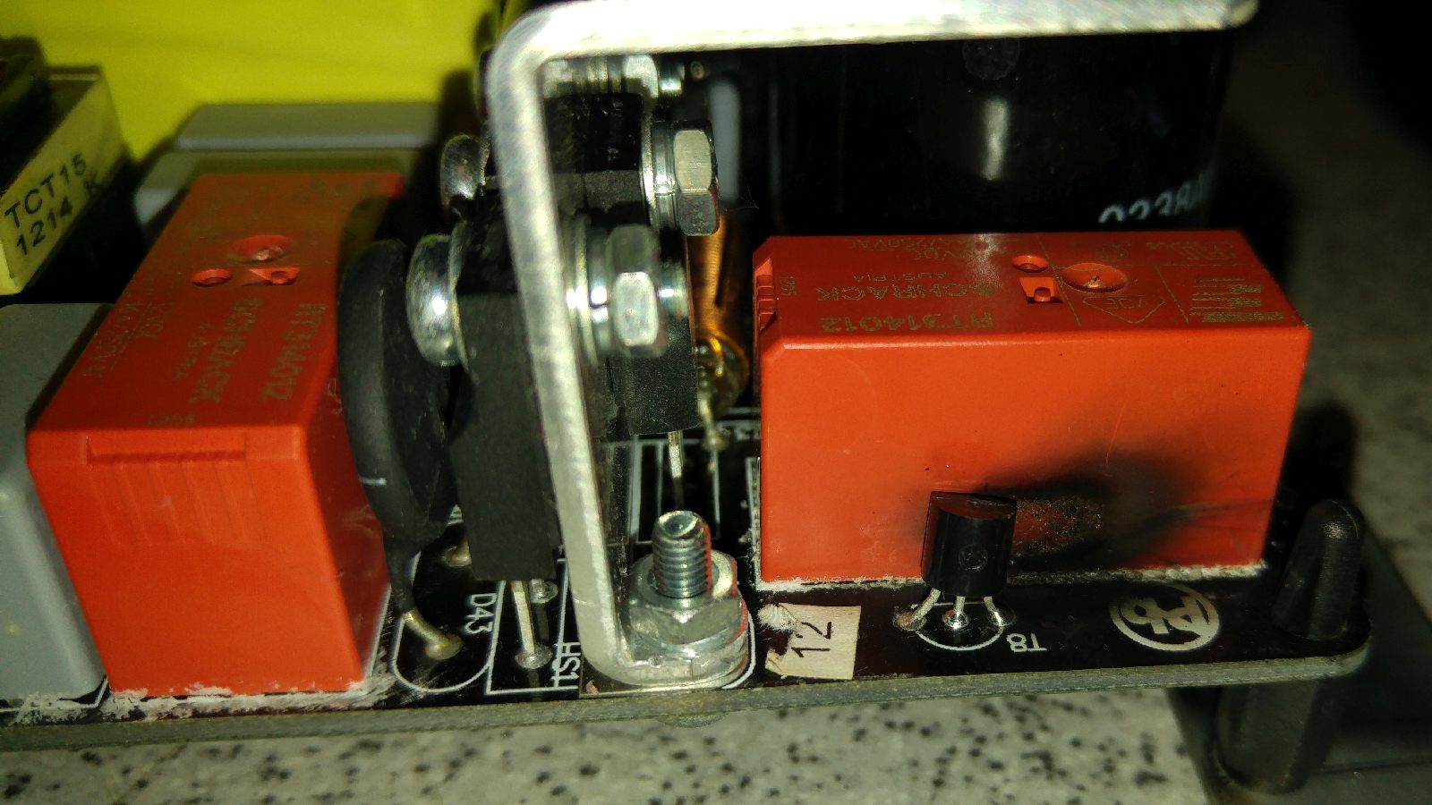

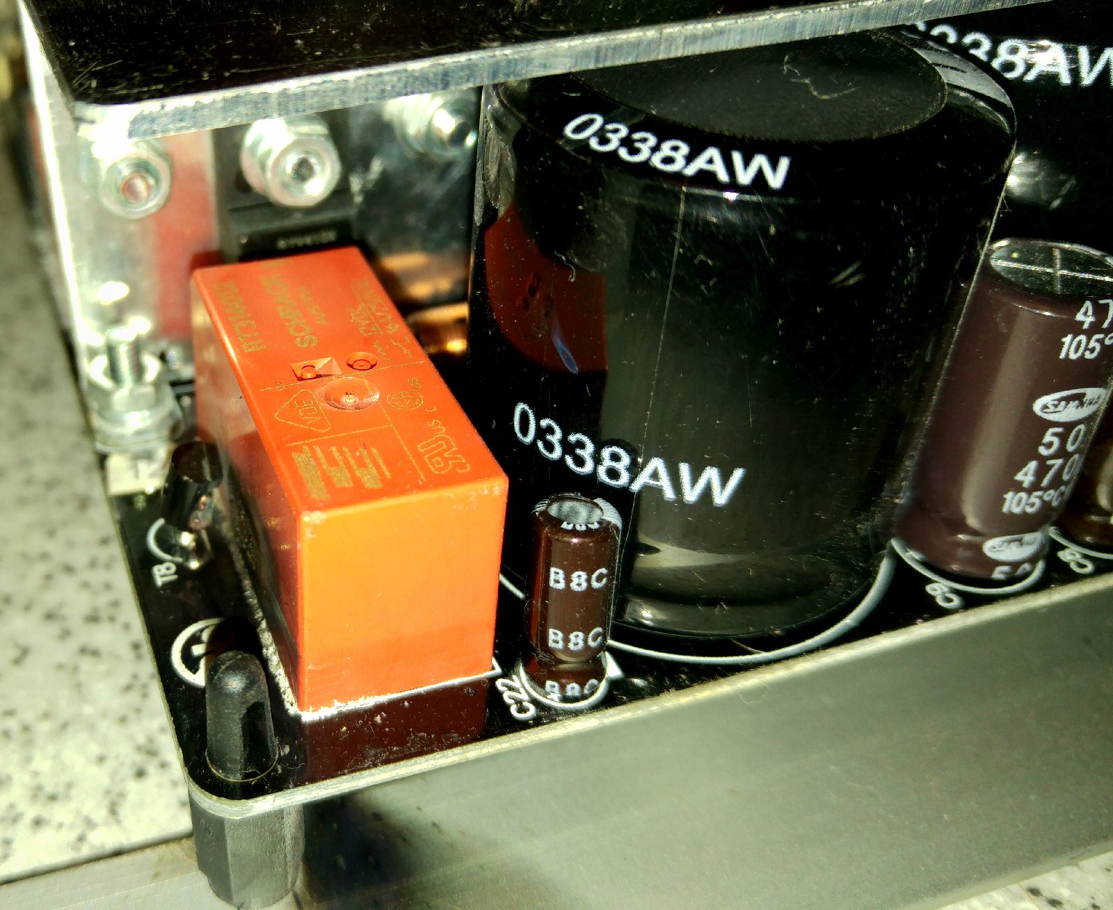

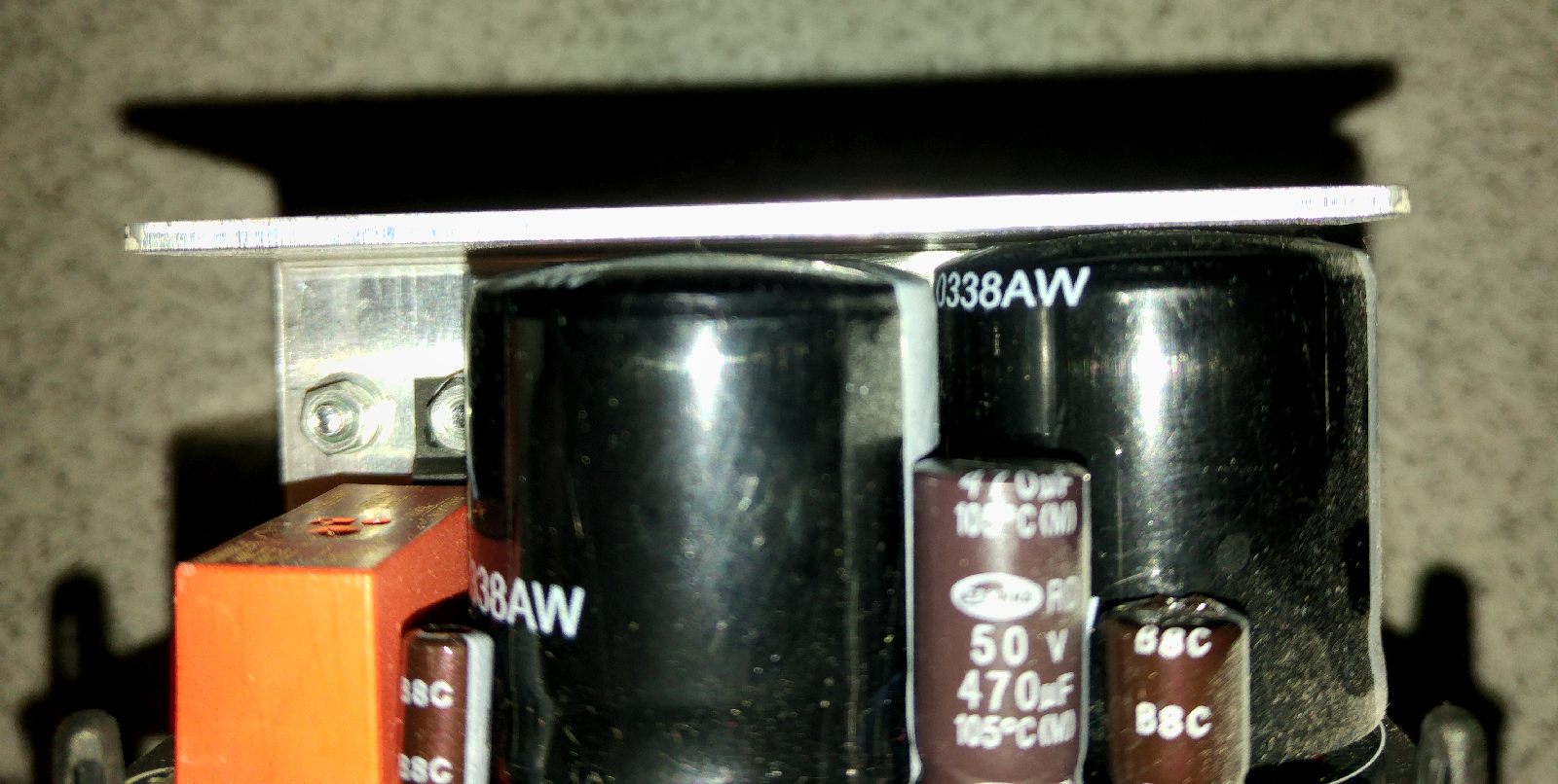

smps600 died with loud boom
Today one out of my 4 installed SMPS600 v2's died with a loud boom when turning on (was cold, not running for a day or so before). Checking what happened, I foud that component T8 blew up. Additionally, the top side of the big capacitors seems to be pushed up, though it's not opened and there're no sign of leaks. Not sure if this has anything to do with T8 blowing up. It drove a single ncore400 connected with the supplied cable. Any idea, hint etc. other than contacting hypex?

I emailed Hypex support, they answered very fast. Seems, I got a bad batch of caps, they offered free repair despite of that the 2 years warranty is well over, and also offered checking/fixing the rest of my power supplies preventively. I think this is pretty cool.

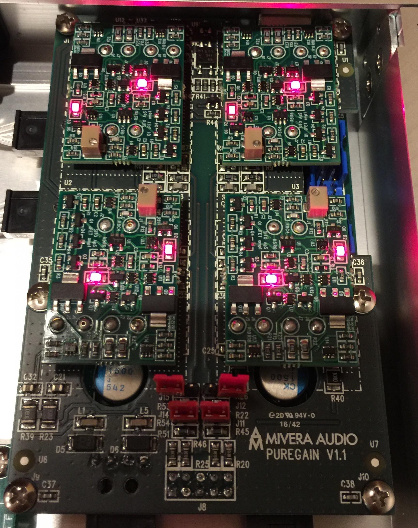

We finally decided to build an NC-500 based integrated amp. It's going to be something Julf would say is overkill🙂 We will use a separate ultra low noise power supply for the modulator stage of the amp. The buffer will use 4x discrete class A opamps per channel similar to our Purestream DAC gain stage. Separate supply for the buffer as well using Belleson discrete regulators with 1uV noise and -110 PSRR. The supply powering those regs will only have 760uV ripple noise to begin with.
