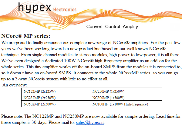

The NC500MP + NC100HF makes for a very neat solution for a woofer+compression driver system

Briefly, they are not designed to replace the NC500. They are a lower spec modul,e size is important for there intended purpose active speakers and multi channel amps. . But I would say they stack up extremely well. I'm waiting further info but I guess the NC100HF add on amp is meant to drive the tweeter in 3 way speaker hence the name/ positioning.
Yes, that is pretty clear, but in what way does the NC100HF actually differ from the others?
hypex said:
We’ve even designed a dedicated 100W NCore® high-frequency amplifier as an add-on for the whole series. This tiny amplifier works off the on-board SMPS from the modules it is connected to, so it doesn’t have an on-board SMPS. It connects to the whole NCxxxMP series, so you can go up to a 3-way NCore® system with little to no effort at all.
